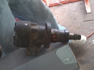

i have been cleaning out my building, i run accross a dash pannel off a yale fork truck, the steering wheel is attached to some sort of pump/motor/ valve, i don't know how this was plumed , and i can't find any info on this thing, i am assuming that this was the steering valve, because the steering wheel was bolted to it, this thing only has two ports, so i am more lost on how this thing worked , i have been wanting to make my tractor power steering, so i am hoping that this thig is a steering valve. i would realy appreceate any advice on this matter.:confused2:

Post a picture and the info you can find on the pump.
   / hydraulic steering valve?

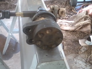

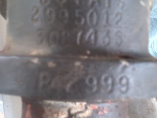

i am including the photos of the thing i tryed to get a pic of all angles, i took one with the numbers on the thing. i didn't see any name on this

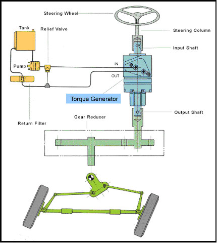

I believe it is a torque generator.
well i guess this isn't going to help with my power steering project huh
