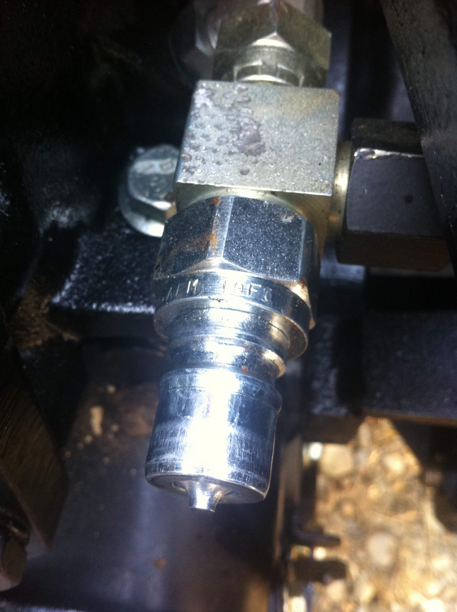

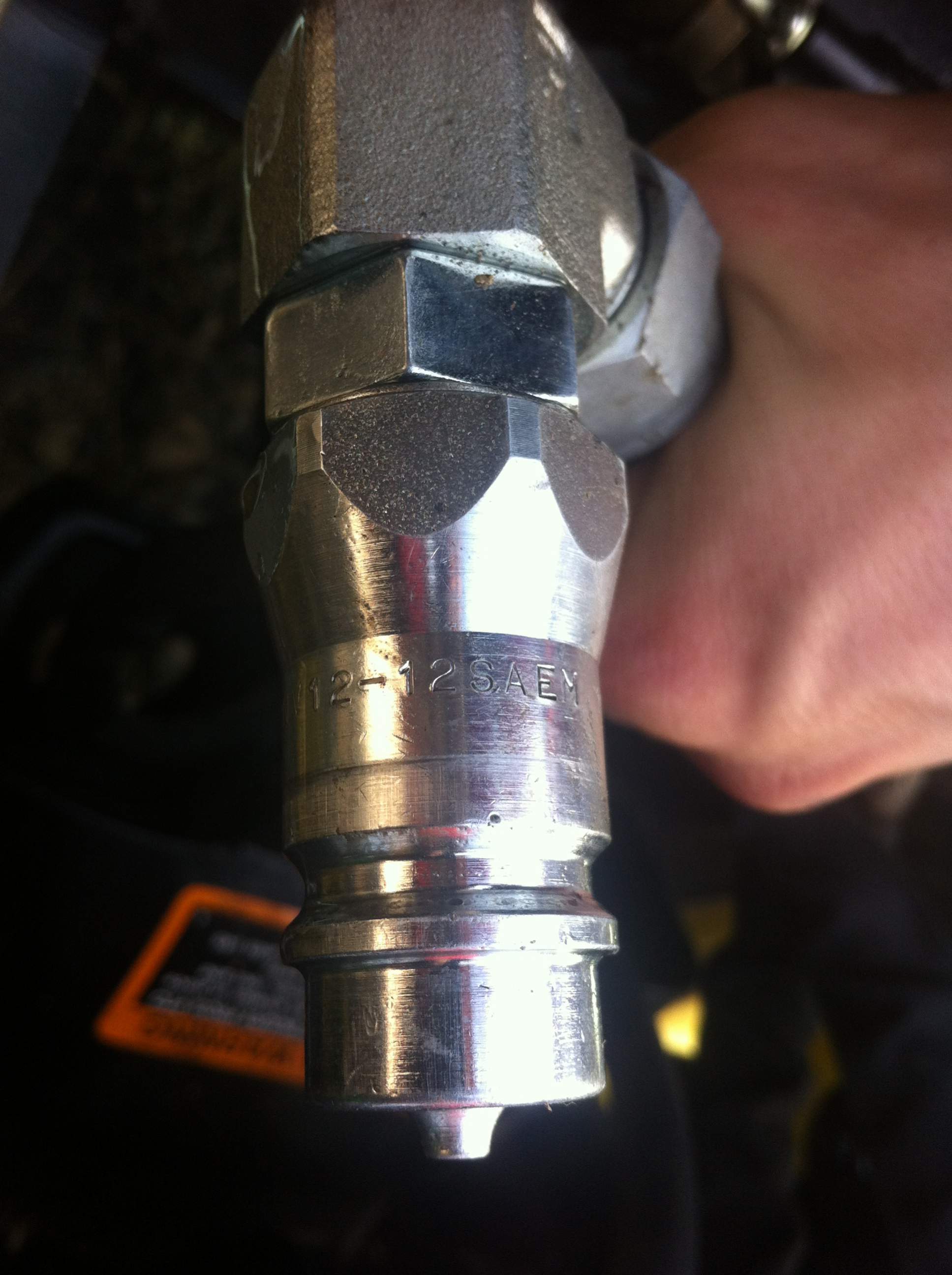

Hello guys,

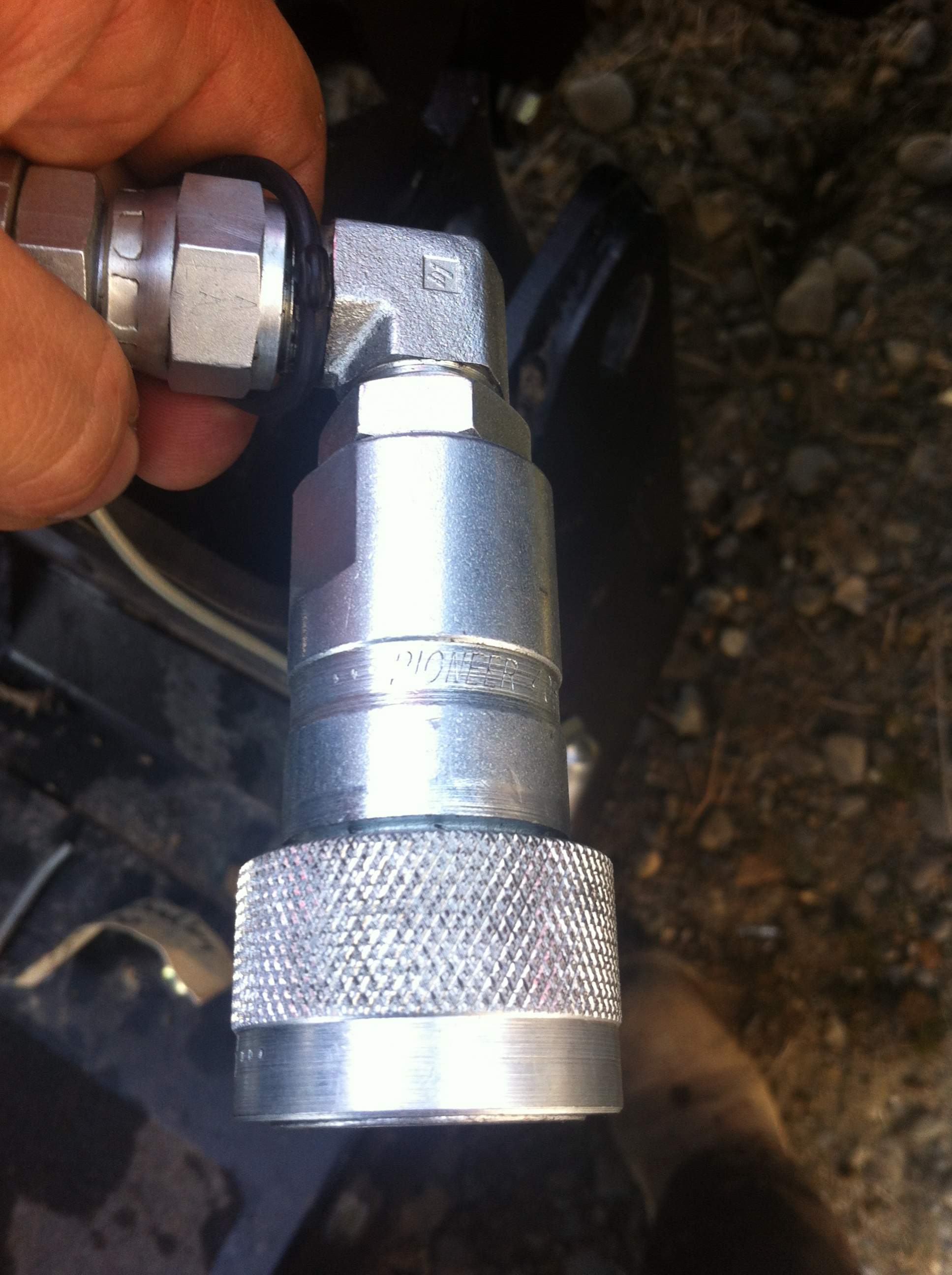

I am a long time lurker and now I need some help. I unhooked my backhoe and hooked up my three point hitch to move my rototiller. When I went back to hook up my backhoe I could not attach one of the hydraulic lines. The one I cannot reconnect is the hard to reach male that comes off the back of the tractor. The female end from the backhoe does not go back on. I have released the hydraulic pressure,I pressed in the ends of the fittings to release the pressure and only a little dribble came out of the female from the backhoe. Nothing came out of the male fitting on the tractor. I can connect the female to the male fitting on the backhoe without any problems. The two male ends appear different to me and the female is a different brand(Pioneer) from the other fittings(Faster) on the tractor. The first Pic is the male from the tractor. The second pic is the male that I can attach to easily. The Third pic is the female from the backhoe. Do I just need more rocks in my pockets or is something wrong?

You said it was connected and now won't reconnect? It looks like two incompatable male ends, one has a longer shoulder from the end to the groove for the detents as well as a slightly different style of groove......Mike

It was connected. That is the thing that has me perplexed. The other fittings pop together easily and quickly. I do not have another female end to try out. I am headed to town to look for the fittings. Wish me luck on Sunday in a town of 5000. I'm sure all the hydraulic shops are closed.

Yep, on my backhoe the backhoe female would attach to the pic 1 male and nothing would attach to pic 2 male, just a dust cap.

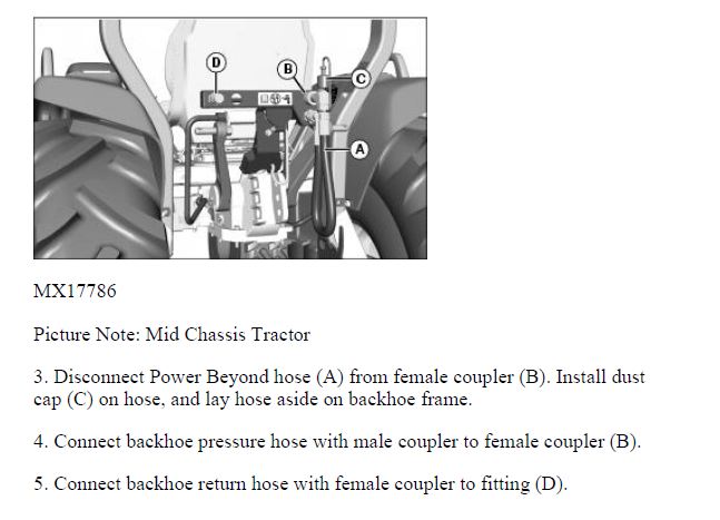

Can't tell much from your pictures or info, but if the tractor is similar to a 3320 follow the instructions below.

Thanks guys, I went to my local auto parts store and purchased a male end that fits the female. Everything works great now. I really appreciate the expertise I find on this site. Thank you

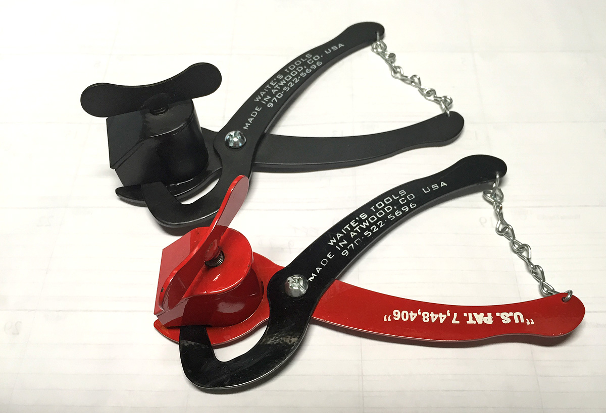

Sounds like you need to relieve the pressure behind the male connector (fitting) so the tip will compress and allow the mating to occur.
Some hit the tip with a hammer and a rag covering the tip so the squirt of oil doesn't hit them.. but oil will come out.
Some turn off the fitting enough so the oil will run out, thus relieving the pressure.

Waite's Tools make a tool specifically for that purpose. You insert the quick coupler, turn the knob and it burbs out a bit of fluid releasing the pressure.
