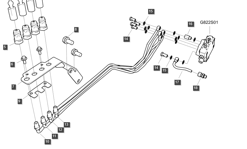

From the parts catalog. Here is the pressure line (#3) to the loader valve:

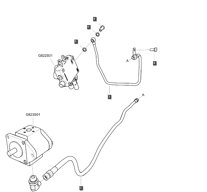

Here is the Power beyond line (#3) and note the power beyond sleeve sticking out on the side of the valve:

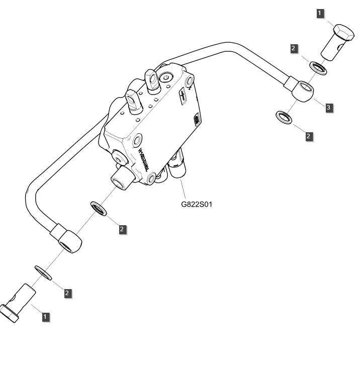

And finally the tank line (#17) that might be hard to see as it goes alongside the lines to the cylinders:

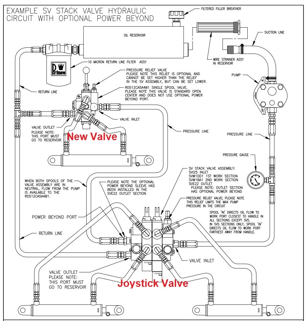

This is a drawing of how a new valve should be plumbed in:
Very Helpful my man! Thank you very much? My last question would be this then, can I use the PB port coming out of my FEL to feed the new valve, then the PB port on the new valve to feed the 3pt hitch? Seems to be the easiest way, unless it won't work. The only thing not shown in your diagram is a 3pt hitch. But from what I've been reading, what I want to do will work in regards of where to put it.
/ Hydraulic question #15
Yes, that will work perfectly, you just have to make sure to plumb the OUT/T port of the new valve directly to the tank/reservoir somehow.
