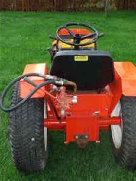

Hello all I'm new in here and would like to know if a gear pump @6 GPM and 2000 PSI would work as a power source for powering a PTO motor. This is for my CASE 446 Garden tractor, it is hydraulic drive and has a 3 point lift. I would like to mount a sickle bar mower and other PTO powered implements if i can find the right combonation of motor, or motor and maybe a new bigger pump. the engine is an 16hp ONAN opposed twin,
Thanks for any help

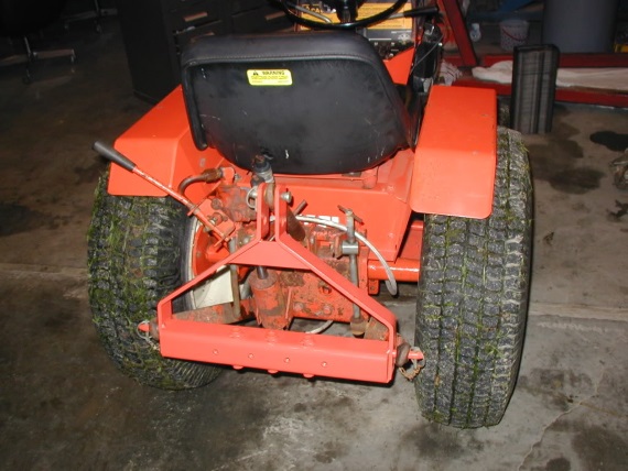

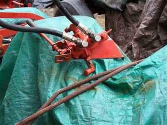

Have you looked into the hydraulic pto kit for the case garden tractors??
/ Hydraulic PTO Conversion #4
That is the best option for powering a hydraulic motor on the 3 point attachment. It is not mechanical, just plug the hoses in. It flows 9 gpm if I remember right.
I have that PTO for both of my tractors. What I want to do is mount a 6 spline output Hydraulic motor so I can power other 3 pt implements.
