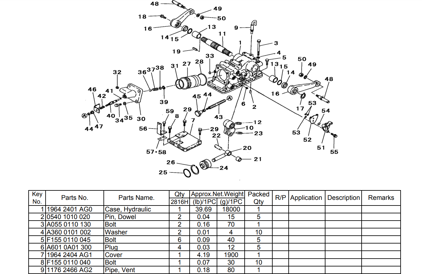

That sure sounds like a clogged vent. Accordingly to the manual, there is a vent in the rear, on top of the rock shaft housing.
Part #9 on the picture:
