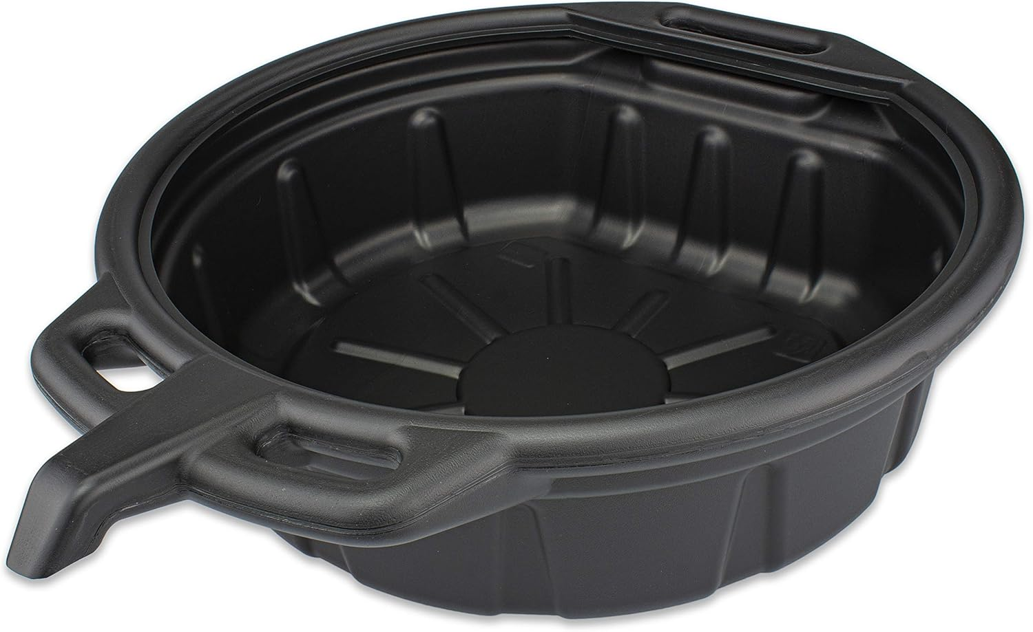

I need to change my hydraulic oil which holds 8.2 gallons. Anyone have a favorite bucket or pan to catch the oil?
/ Hydraulic oil drain pans #2
Get two of these in the 5 gallon size and put one on some wood blocks under the drain plug, and aim the spout into the second pan. Still low profile and doubles capacity.
A cheaper option is to get a plastic barrel and cut it down to fit under the drain plug, should fit 10 gallons easily.

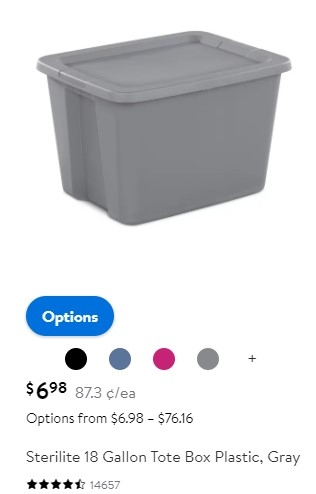

My M7060 holds 15 gallons of hydraulic oil. To drain it I just bought a cheap plastic tote at Walmart that held 20+ gallons. Then I used a big pitcher (half gallon) to scoop the oil out of the tote and into 5 gallon buckets to take it in for recycling. Snap the lid back on the tote and it keeps the oil clean and the tote clean for future use. Something like this:

All great ideas. I was hoping to use a couple of 5 gallon bucket but they are an inch or two too tall. I have several 30 gallon barrels out back I saw today, thinking the same as AaronD81 said, take one of those and cut it enough to fit under. That should hold what I need to drain. I hate to cut one up but that's probably the cheapest way to go no more than I have to do this. I might cut it enough to set it up on a creeper so I can roll it out easier. Thanks everyone for the ideas!

I grabbed a tote like Deserteagle did. Just measure clearance and then find a tub short enough with enough capacity. Or cut down one of those drums would work too.

I'm in the cheap 'tote'/storage bin camp. Most of them, these days, even have wheels on the bottom for ease of sliding then in & out from under the tractor.
I've used them a couple of times, then I duct-tape the lid on for either the short trip, in the back of my ute, to my local tip for disposal OR to a neighbour who uses the old oil on his wood fence posts.

So...... I got ready for my first hydraulic oil change on my M6040. It holds about 16 gallons. Five gallon buckets slide under with adequate clearance.
Then it hit me. How in hell will I slip an almost full five gallon bucket out from under the tractor. This AND then get an empty back under without making a real mess. AND do this four times.
I had a brain fart. My wife's Tupper Ware quilt storage tubs are 20 gallon and have a tight sealing lid. This all went well with little to no screaming or hotly thrown accusations.
