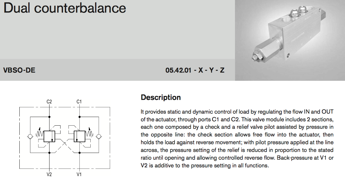

Here's a dumb question - do C1 and C2 go from the counterbalance valve to the motor or do V1 and V2?
   / Hydraulic motor sizing - weird project #59
C1 and C2 go to motor
V1 and V2 go to valve
since counterbalance is more commonly used on cylinders C = cylinder and V = Valve
