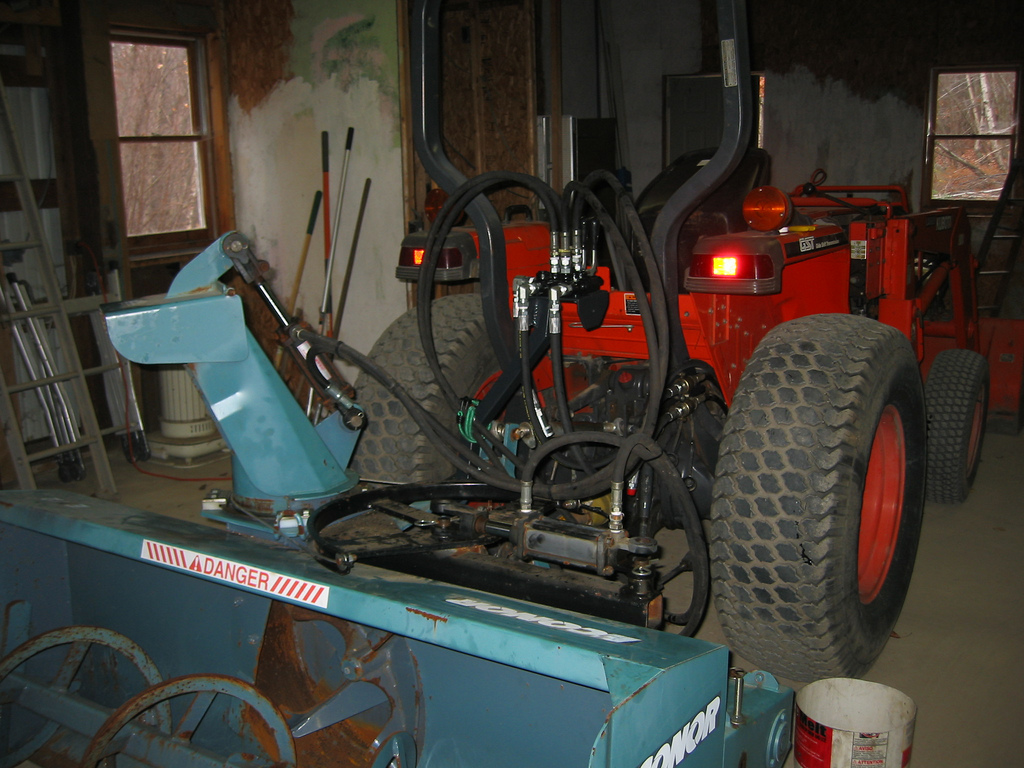

Why hydraulics instead of electric, you ask? With a loader setup installed, the BX22xx quick hitch uses the loader valve to lift and lower the blower. Since the controls are already there for an extra degree of freedom, why not use them? A joy stick up and down for lift n' lower, then back n' forth for rotation is about the most intuitive control I could imagine, and I've always wanted to set up a joystick chute control - the BX has me 1/2 way there already. Hooking a hydraulic motor to the existing chute rotation mechanism is trivial, as shown above. Setting up a cylinder is a seriously complex and expensive proposition. I have a hydraulic cylinder rotation (and flapper) on my big blower - the cable/hoop mechanism would be complex to build, and must be precisely engineered, as evidenced below (and yes, I know the chute cable is routed backwards - left over from the PO - its fixed now):

Seeing the pix makes a bit more sense of this - in effect, those notches and the "rotary spring" are acting as a worm gear, so your 500 rpm would probably translate to maybe 3-4 seconds for a full rotation of the chute.
Prior to the pix, it sounded like you were going to direct drive the chute - hence my smart-azz comment :laughing:
