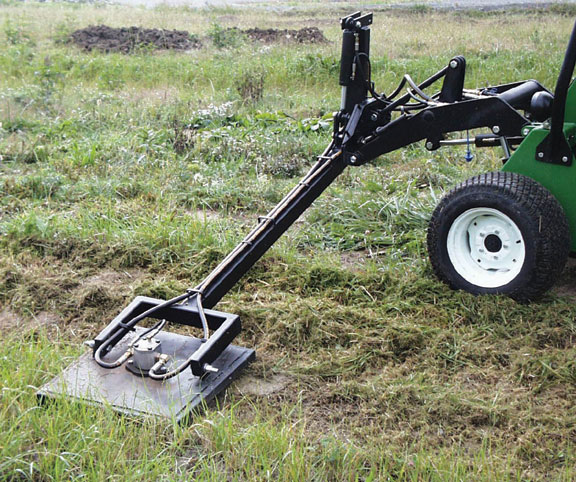

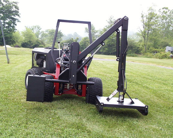

This 20 in boom mower uses 8 GPM.
The larger boom mower probably about a 32 in, uses about 15 GPM.
I used tractor 3000 psi to compute the torque for 8 GPM, = 955 in lbs, or 79.58 ft lbs.
You could also use a 6 HP two stroke engine for pond cutting.
