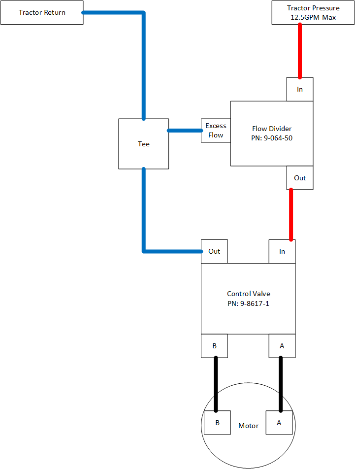

I would use that motor and a flow divider. Here is how I would plumb it:
For a flow divider, I would use 3/8 NPT HYD FLOW CONTROL VALVE W/RELIEF RDRS137-8 , I would then run it through a selector valve (such as 1 SPOOL 2 GPM HYDAC RM23 HYD CONTROL VALVE chosen only because its a cheap double acting open center valve) which you can tie into your emergency stop bar (you can then use it to reverse the flow and back stuff out when you hit the bar) and into your pump.
You actually only have 7.8GPM available at the rear remotes as 4.7GPM of the "total GPM" is from the power steering pump and is only available for the steering system.

Looks like $45.89 more to use the all in one valve. For both comparisons, I am assuming that we are running 3/8" NPT lines from the tractor remotes to the valve.
For the separate direction and flow control valves we will need:
2x 12" 3/8 NPT hoses to go from the flow valve to the directional valve - $10.20 - 3/8" X 12" 3/8 NPTM X 3/8 NPTM 3 PSI HYD HOSE
1x 3/8" NPT tee for the excess flow port on the flow control valve - $6.00 - 161-6-6 3/8" TEE
1x 3/8" flow 0-8GPM flow control valve - $93.55 - 3/8 NPT HYD FLOW CONTROL VALVE W/RELIEF RDRS137-8
6x 3/8" NPT to #8 SAE adapters to go into and out of the directional valve and the motor - $3.54
2x #10 SAE to #8 SAE reducers (for the in/out ports on the directional valve) - $11.20 - SAE 1M TO SAE 8F ADAPTER
1x Directional control valve - $59.95 - 1 SPOOL 2 GPM HYDAC RM23 HYD CONTROL VALVE
2x 36" 3/8 NPT hoses to go from the directional valve to the motor- $21.90 - http://www.surpluscenter.com/Hydrau...PTM-X-3-8-NPTM-3000-PSI-HYD-HOSE-903-3836.axd
1x Motor - $119.99 - http://www.surpluscenter.com/Hydrau...55400F3101AAAAA-HYDRAULIC-MOTOR-9-8632-VV.axd
Total cost: $320.33
To use the larger combined directional/flow control valve (which will be more "touchy" as well due to its larger flow range) we will need:
2x 3/8NPT to 3/4" NPT bushing - $4.90 - http://www.surpluscenter.com/Hydrau...ng/3-4-NPT-TO-3-8-NPT-BUSHING-9-5406-12-6.axd
1x directional/flow control valve - $214.60 - http://www.surpluscenter.com/Hydrau...-18-GPM-MOTOR-VALVE-W-FLOW-CONTROL-9-7458.axd
2x 1/2" 36" long hoses - $21.90 - http://www.surpluscenter.com/Hydrau...PTM-X-1-2-NPTM-3000-PSI-HYD-HOSE-905-1236.axd
2x #10 SAE to 1/2 NPT adapter - $4.50 - http://www.surpluscenter.com/Hydrau...ght/SAE-10M-x-1-2-NPTF-SWIVEL-9-6900-10-8.axd
1x motor - $119.99 - http://www.surpluscenter.com/Hydrau...55400F3101AAAAA-HYDRAULIC-MOTOR-9-8632-VV.axd
Total $365.89
Of note: With the combined valve (being as its a motor spool valve), the in-feed rollers will be able to spin relatively freely when the valve is in neutral.
As such, it will be harder to keep the chipper from sucking in a branch if you are trying to just feed a little at a time.
Aaron Z

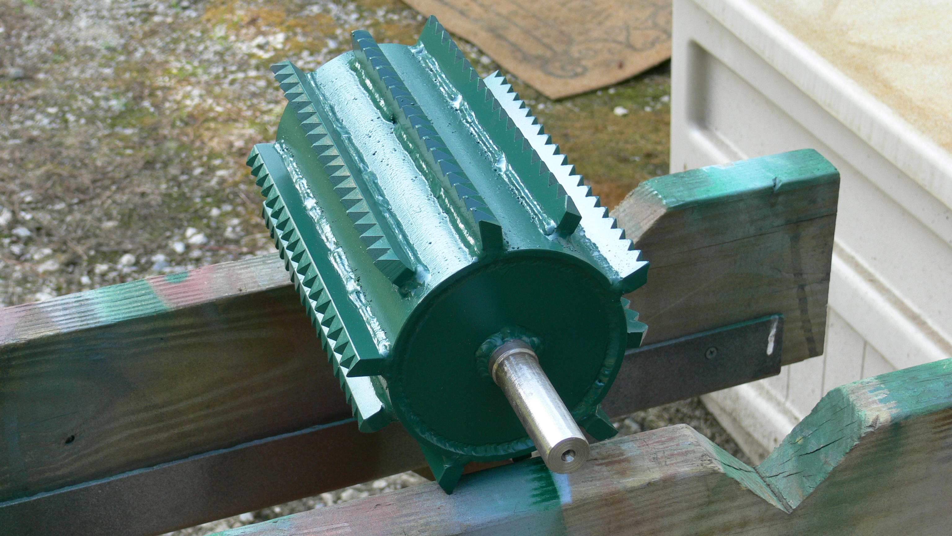

5030 - - now for the chipper story - - you asked for it:). When I first got the chipper the feed drum only had flat 1/8" bars welded across to grab branches. The bars would slide on branches and nothing would feed unless you pushed in constantly - - PITA. I ground notches in the feed drum to make them more like teeth and this worked until I bent the shaft and broke the nut on the drive shaft. I talked to the the dealer that sold me the chipper and nothing else was available so I made a feed drum and sent him a picture (see below) - - I now see that feed drums remarkably similar to mine are now for sale - - wonder where they got the design! Next I broke the nut on the drive shaft - - again. Back to the dealer and found that Jinma had a new design with U joints so I purchased and installed that. Then the bar that holds the feed drum was flexing and bending jamming the feed drum against the side - - gear box gone - - so I remade the entire drum support system using steel tubing - - NO flexing now, goes straight up and down with no problems. At this point I considered trying to design a hydraulic system but I needed the chipper got lazy and ordered another gearbox. I have no idea why this one broke. It was feeding fine, branches were 3.5" max and nothing strange - - it broke in less than an hour of chipping. All gearboxes break by snapping the bronze gear - - the steel worm input is fine. One other change to the chipper was the cutting blades. I found the tips of the "hardened" blades were curling over/bending. I made blades out of D-2 steel had them hardened and I ground them sharp - - blades don't get dull nearly as fast now and they don't bend!
All this sounds like I am a contractor using the chipper constantly but I am not. I bought the chipper around 2008 when I purchased some property with a bunch of pine trees. I chipped branches from around 20 pine trees.
Overall the chipper was fine. I expected to do repairs and stuff when you considered the cost of the chipper. Since then I have been working on some hardwood trees - - around 5 of them and the chipper has not done well. Also, I have never put a 6" branch in the chipper - - 5" has been the max. I try to cut the branches to minimize forks which block the feed drum.

The valve I linked to should be a FWD - OFF - REV valve (ie: it should work like a standard hydraulic remote).
The downside to stopping the drum with the flow control knob is that you then have 7.8GPM at 1500PSI (or whatever your relief pressure is) worth of heat that your tractor's hydraulic system has to dissipate. That could be problematic if you leave the flow control valve "off" for any length of time.

Nice drum, looks like mine.... I have no knife issues at all. Mine are 89 Rockwell, I tested them. I keep a 27 degree included angle and I sharpen them in an angle jig on one of out toolroom grinders... I own the machine shop. I grind them yearly....in the fall.
I've stuff a couple 8" knots in mine. It handles it. Barks a bit...lol Mine must be newer than yours. I've had mine maybe 8 years. Same gearbox, second driveshaft, third belt and 2 sets of knives and bed anvils.
I've found the 27 degree included angle does the best in hardwood. I just ran some old apple trees through it. Everyone wants the chips for smoking...lol

5030 - - 89 Rockwell seems really hard. I made my blades but had them hardened and tempered at a local shop with an oven. They put my small stuff in with other jobs and I think I end up buying the boss lunch for what they charge me. They tested the blades and they are 59 Rockwell C. I used a 40 deg. edge. I was afraid that too sharp would cause the edges to chip - - may have to decrease the angle but that isn't too easy using my old manual feed Brown and Sharp grinder. I have a home shop - - old small stuff by today's standards but I have rebuilt the equipment and everything works fine. If I never have to scrape another way it will be too soon!
