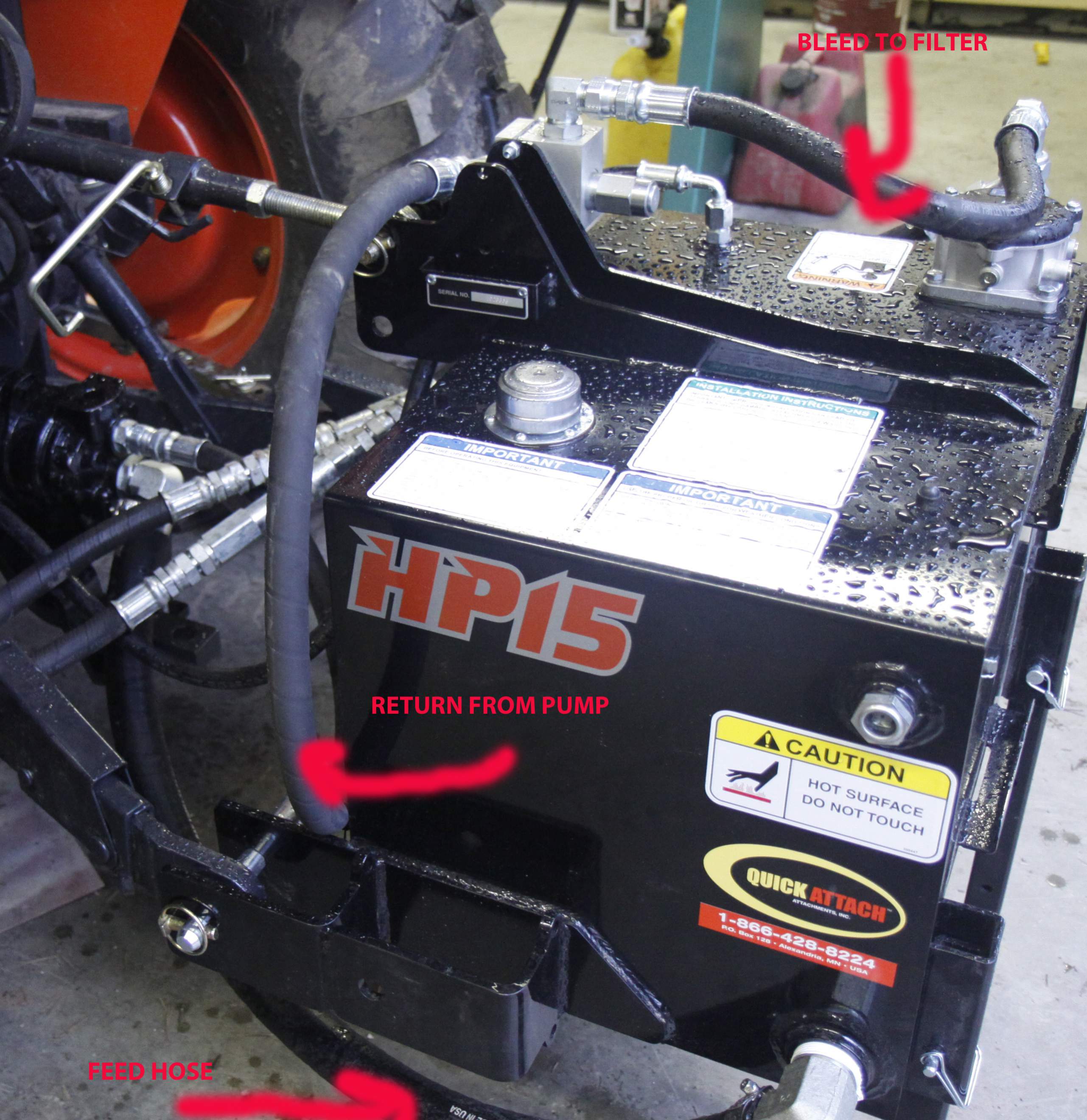

I have the rear powerpack and blower from Quick Attach for my loader mounted blower. I know it produces 15 gpm at 3,000 psi when operating at 540 rpm on 45 hp tractor. Blows a heck of alot of snow and can move piles 7 feet high ... which i can get when buildings shed. Have bern using it for 8 years now. Best plus is the hydraulic chute rotation, and deverter.. and NO SHEAR PINS.. I cant tell you any specifics on pump though, but there are alot of hoss, deverters, and large hoses. The tank holds 25 gallons of low viscosity hydraulic oil. The oil volume is necessary to keep temps proper. I believe 35 hp is smallest they recommend.

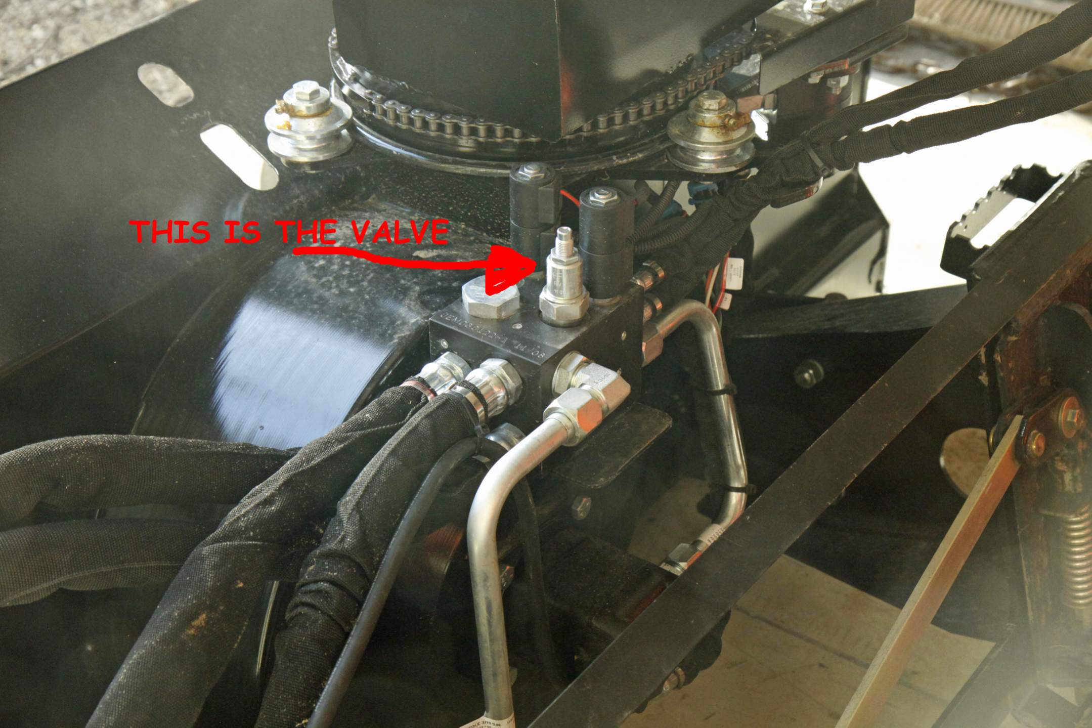

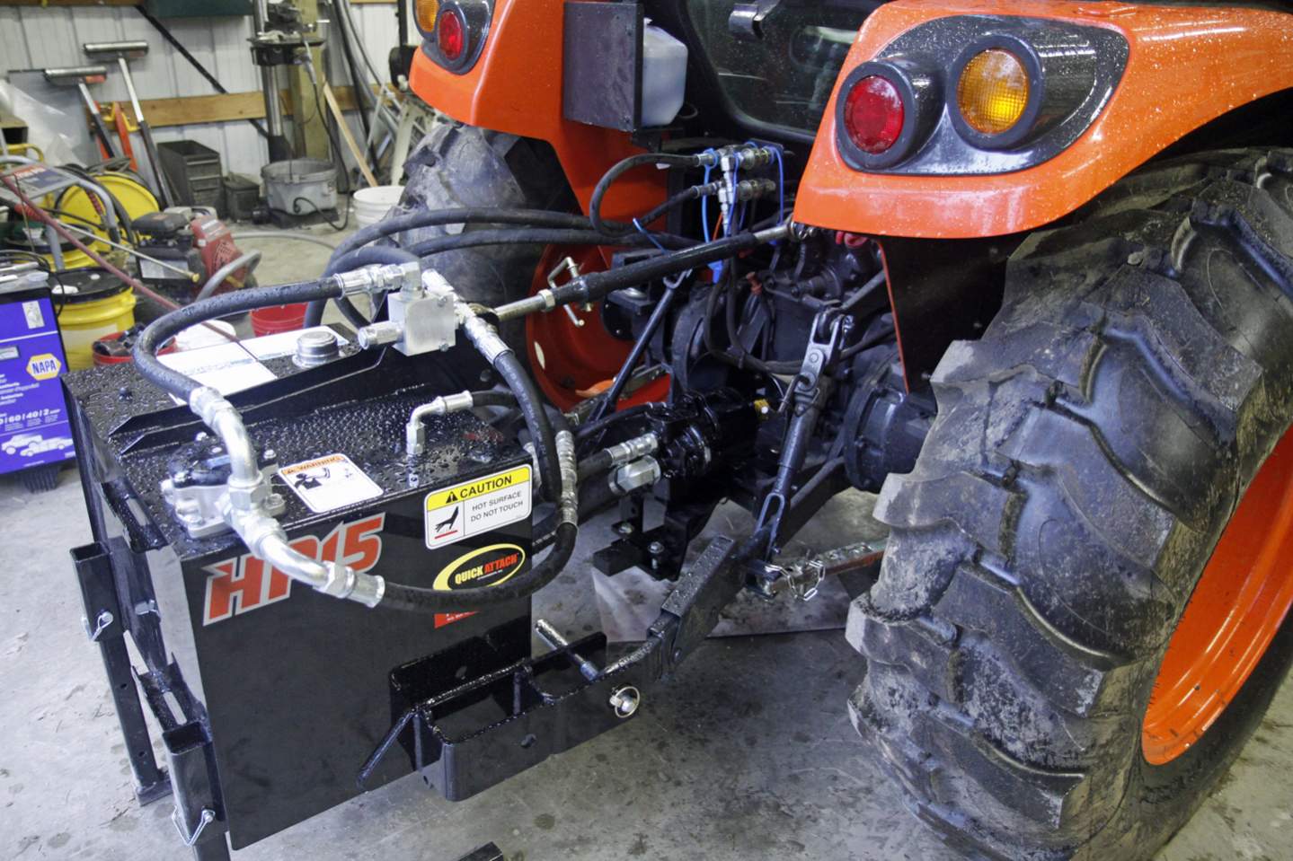

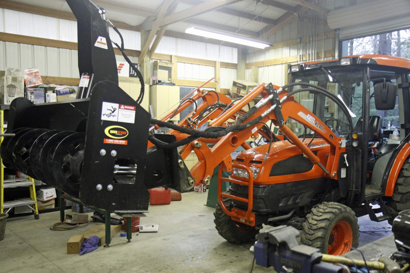

ya. pretty complicated setup. but i needed to be able to reach up high to clear berms and when shop and barn shed. also my neck is so screwed up ... mostly from 15 years of looking backwards to blow snow.side view blower and bracket 1.jpg snowblower installed.jpg powerpack 1.jpg ready to blow roof.jpg final rear powerpack 1.jpg IMG_20170204_080002602.jpg LEFT TANK SIDE.jpg RIGHT SIDE TANK.jpg rotator  text.jpg

That's a fine setup, looks like she can really make the snow fly...what speed does the blower run at?
   / Hydraulic motor advice #18
I actually have no idea. Tonight i as cutting thry wet snow drifts 2 feet thick and just ate them up. I only had 2 snow dams occure in over 3 hours of blowing snow. Got too hot in cab, had to turn on ac for a bit.
