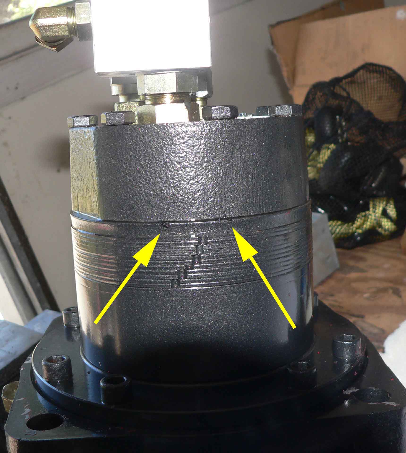

Udpate:
The leak appears to be out of the body of the motor about 2.5" back from the motor face with the hydraulic fittings.
The Fix:
Terry is prepping a motor with the minor hydraulic fittings and sending it out. I'll replace it and send mine back to him.
More as it unfolds.

Attached are two photos of the extracted motor. As you can see, there is the frayed remains of an O-ring protruding from the motor housing. The ends are indicated by the yellow arrows. The second photo shows the oil weep in more detail. Oil runs out of this space under no pressure. Turning the motor upright for the photos caused a tablespoon or two to weep out.
I have run the tractor for a few minutes with no leaks, so I hope that it is fixed.

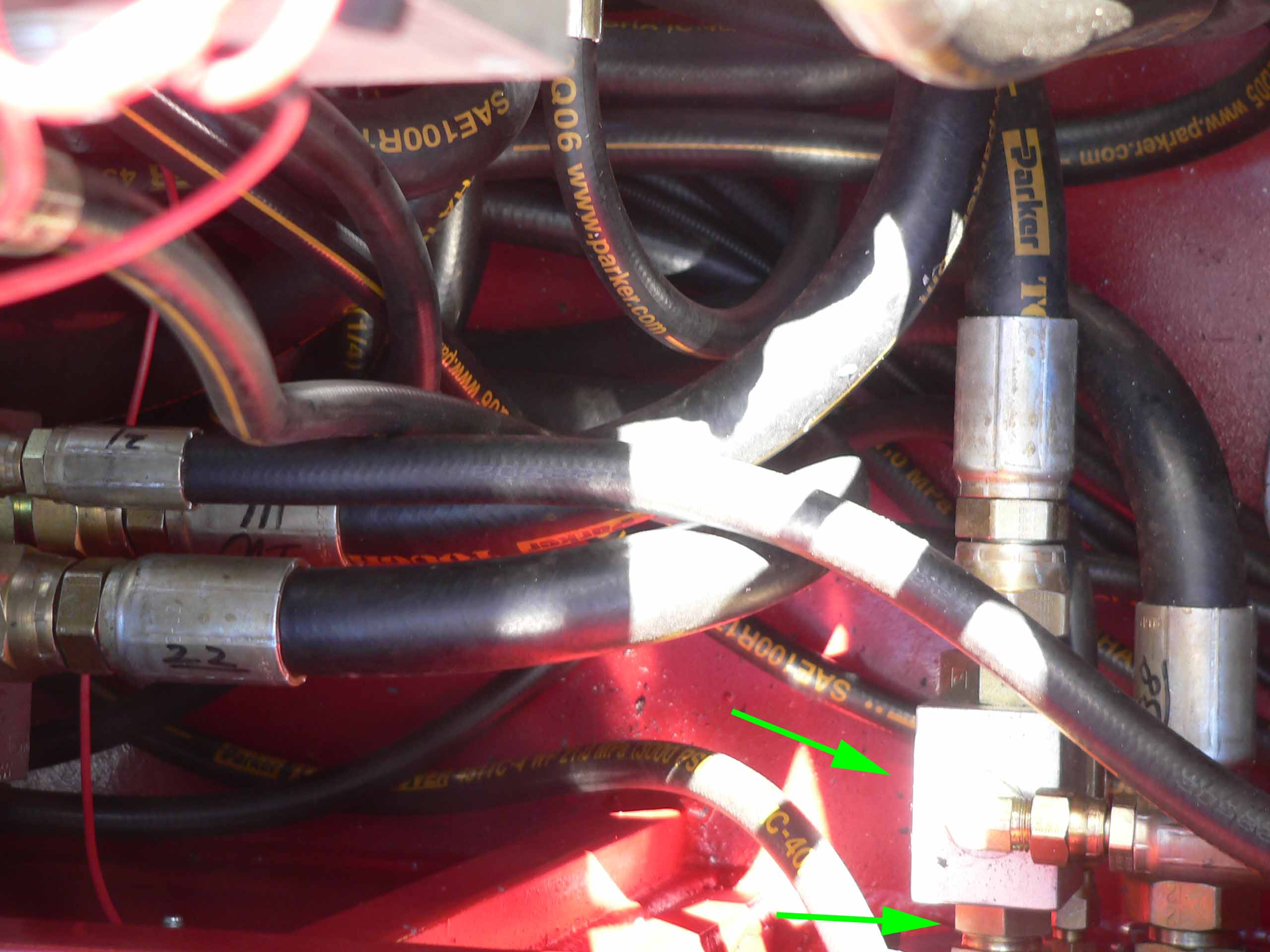

This time through, the wheel motor was 'naked', so I had to transfer the old hardware to the new motor. I had a slight difficulty with the aluminum "T" block assembly that "tees" off hydraulic fluid to the other rear wheel. I had to put a cheater bar on the wrench to get it loose from the old wheel motor.

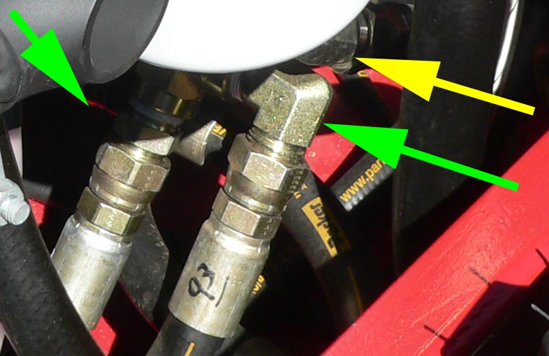

The "Tee" is aluminum rectangle shown in the image below (Upper arrow.) The lower arrow points to an adjustable spacer that adapts from the SAE o-ring fitting to the aluminum block. The block had been fastened to the fitting with sufficient pressure to indent the steel washer with a hex pattern from the nut. I hope this clarifies the issue. I think that the fitting was fastened to the motor, and then aligned by rotating the aluminum block into the stalled nut.
I am sure that PT has a torque wrench and I am equally sure that there are a number of fittings that via the pressure cycling get really embedded. I would love to know the early history on your machine; i.e. what was the reason that it got retired to be a donor machine for the other one.

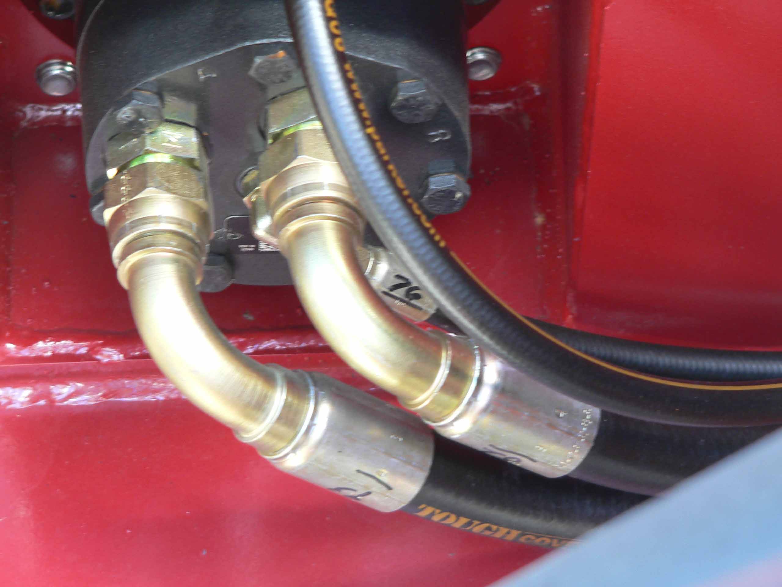

   / Hydraulic maintaince questions #16
Thanks for the picture Peter. You guys are right about how no one PT appears to be the same... I assume this picture is taken looking down, right behind the fuel tank. 22 and 11 are your PTO return and run, at your head (camera top) is draft control?
So that T connector I do not have.... I am really intrigued in its purpose. Hose 38 and the unmarked are your wheel motor hoses, right? Do you know where that T feeds into?

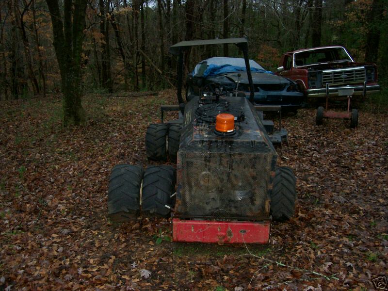

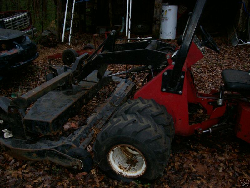

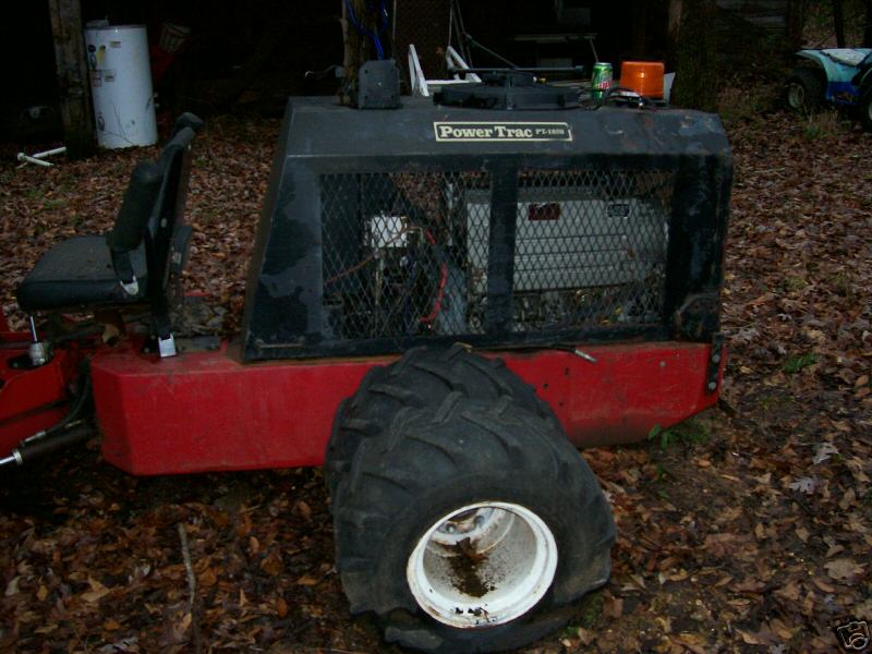

Ken may have more information on my PT, but this is what I think I know. There was a guy back east who had a slope mowing company. He also clearly had no concept of maintenance. Anyway. He bought this PT I think in 2002 and was doing state road maintenance. About 200 hours into operation he burned the motor up. After a fight with PT and Deutz he said he got a new one for free. His boys installed the mower, took it up to the highway to test and they melted down the electrical (It to me looks like they shorted the starter solenoid as the grill is melted there). Now he has this big contract he has to get done so he orders parts to fix the PT, but also orders a whole new one (Kens). But, he is lazy and crazy and never fixes mine, just leaves it outside and pulls parts from it. It was sold as a parts to Ken, and Ken decided to invest in fixing it up (thank you Ken). Ken and I talk frequently, he is one great guy. It is up for argument which of us got the better deal. We both seem to have weird stuff happen to our machines, but I abuse mine and Ken knows how to treat equipment.
One weird side note is that my PT does not have a serial number. Terry says that they have no record of this guy buying this tractor initially, but that did not mean much as PT is not great about records. Terry said it was not a questionable purchase. But without the serial I cannot get any accurate dates on construction or version history.
I am enclosing a picture of my PT, I think I have shown this before..
Oh, I have to say that is one of the cleanest tubs I have ever seen Peter.... Really impressive. Like you don't even use the tractor ;-)

To clarify:
The photo is taken looking vertically downward centered over the left, rear, hydraulic motor. On the left side of the image is a control block that has the PTO in it (hoses 111, 22) and the small hose (21) snaking horizontally across the image above the wheel motor connects to the brake accumulator off the image to the right.
The "Tee" enables hydraulic fluid to flow from one wheel motor to the other, enabling a differential like behaviour. In principle, I think that this could also occur at the hydraulic pump, but PT has it plumbed up this way. (Perhaps to reduce turf tear up?)

   / Hydraulic maintaince questions #18
So, help me out on this one because the 1850 with the wider stance has a bit of a tear up the turf tenancy...
You are saying that from this T at your rear wheel (This is the only T connection, right?) a hose runs up and connects to the wheel motor on the same side up front? This is where hydraulics all falls apart for me...

The "Tee" goes from the left rear wheel to the right rear wheel. While I haven't fully traced the front hydraulic system, it is missing the aluminum block, so I don't think that there is a special system for it.

Carl,
On my 1445, the pump fluid in the FWD mode, goes to a tee. then back to another tee which branches off to the wheel motors. The fluid also goes up to the front to another tee and then to the front wheels. The reverse path used a similar set of hoses. If I remember right , the wheel drain lines either go to the cooler or goes to the case drain and then back to the cooler.
They may use a block fitting or a tee fitting. They do the same thing.
