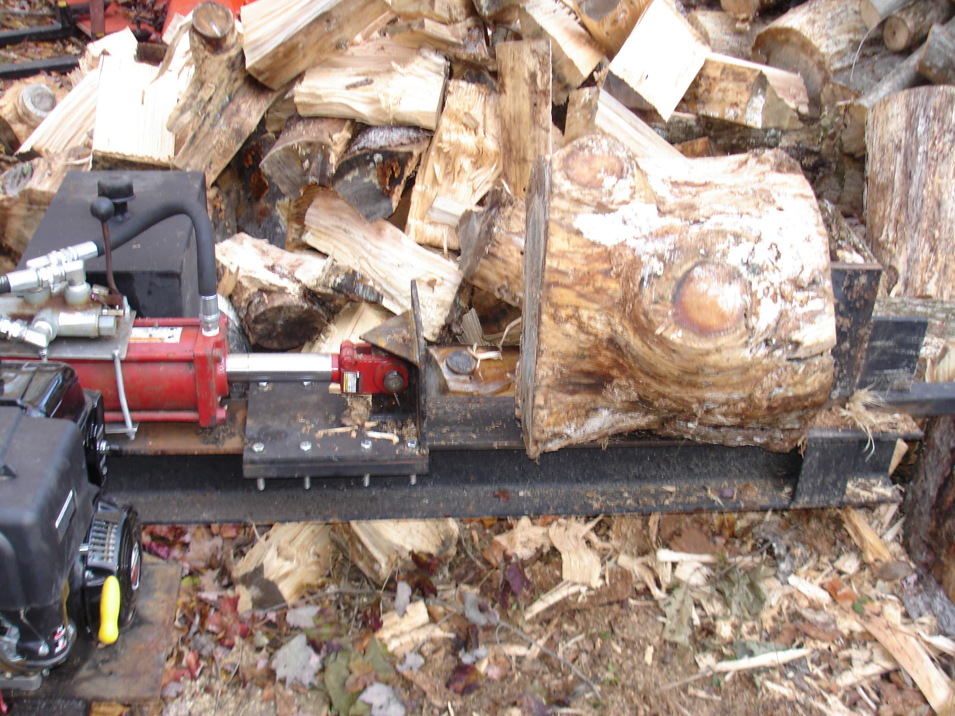

So it's good to know I am not the only one to have a wedge come off. My homemade splitter is a 13 hp with a 22 gal per min pump and a 5" cylinder. It was splitting fine until I had to try an oak log full of knots and twists :yell: I added a back up plate to mine and asked a Real Welder from work to weld it on for me. No problems now' nothing slows it down yet but no 4 way wedge for me. If the back up to the wedge in the pic is bad I can get a better pic. 027.jpg

So it's good to know I am not the only one to have a wedge come off. My homemade splitter is a 13 hp with a 22 gal per min pump and a 5" cylinder. It was splitting fine until I had to try an oak log full of knots and twists :yell: I added a back up plate to mine and asked a Real Welder from work to weld it on for me. No problems now' nothing slows it down yet but no 4 way wedge for me. If the back up to the wedge in the pic is bad I can get a better pic.View attachment 447677

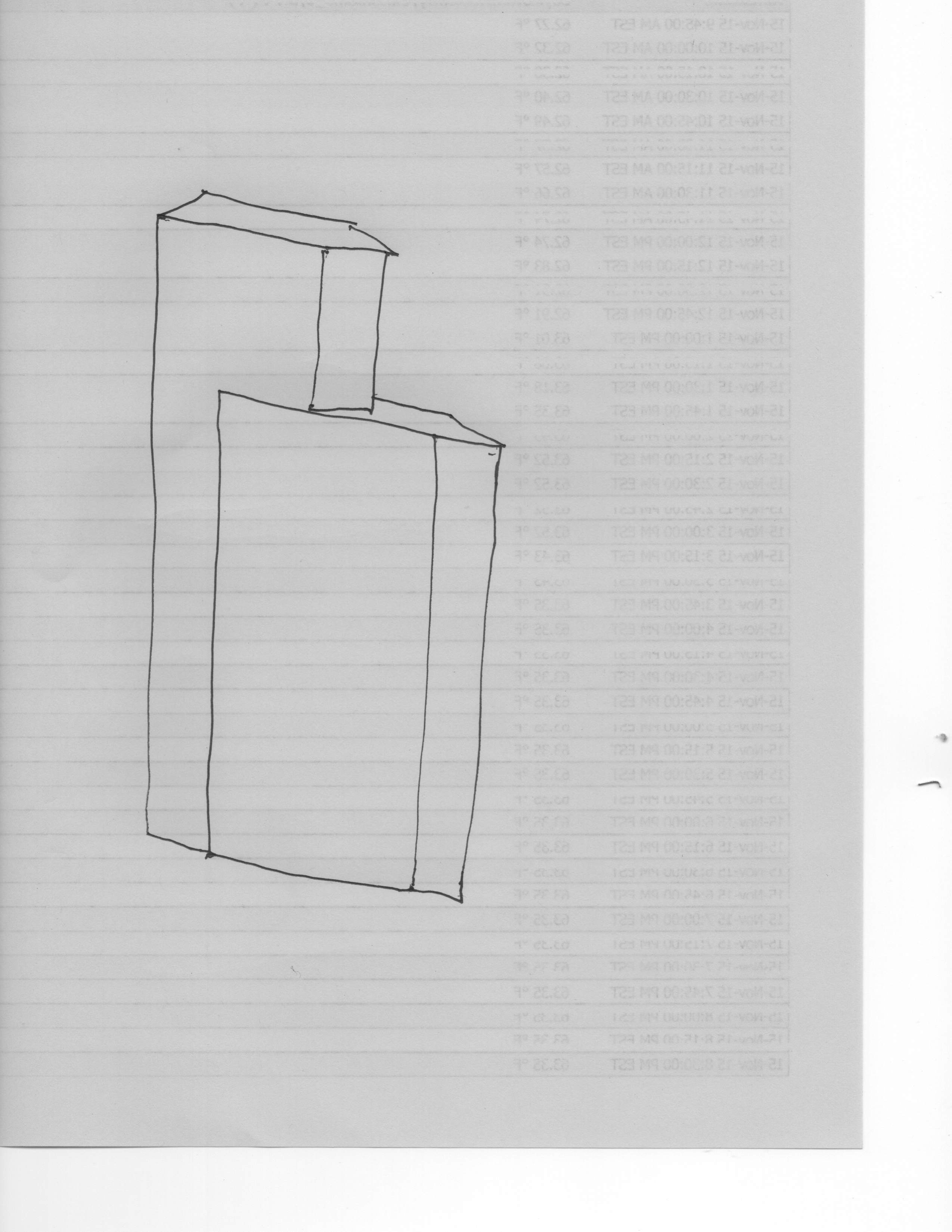

I do believe the trouble of ripping off wedges starts when a stubborn round rides high on the wedge itself. Creates more leverage to rip the thing off. That's how mine popped off. I had the 4 way on and it rode to the top part of the wedge and off it came. This only happened last year so I got 16 years out of the original weld. If I can envision what Turn key is suggesting, it may look like this which is not a bad idea. It creates height while re-enforcing the wedge a little bit itself.
Yep, that is the idea. I have seen pictures of splitters with that but haven't seen any reports about how well it works.
