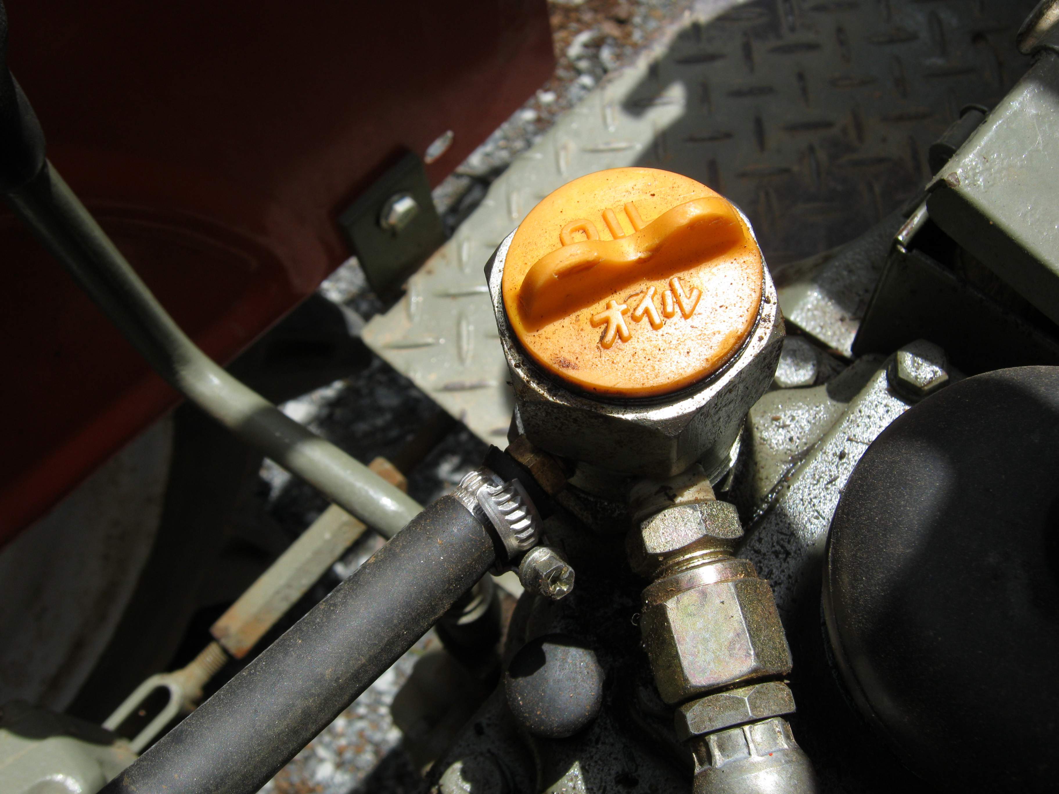

I really like that ! That should really help those that on't have a return to tank port..
Do you net a new dip stick to make up for the adapter, of just subtract for the adapter ?
Either way, a great idea !
If they had had it when I was trying to figure out a place to return, I would have bought 1..
I had to make another inspection plate, drill a hole and add fittings
/ hydraulic line return at dip stick #3
Yeah my return is in an adapter like that. 026.jpg I also added a filter to act as a breather to see if it stops it leaking oil out around the shifter boot but it didn't :thumbdown:

where did you get your adapter ? They 1 you have has a place for 2 hose connections

A lot of the original Japanese installed loaders also had similar adapters. They work really well but we could not find them any more so we had a batch made up.
It does not come with a longer dipstick so you should just keep the extra height in consideration when checking. I don't think you would ever hurt anything by adding an extra inch of oil though either. We can also make custom aluminum dipsticks to any length you want.

I think a kit with a new stick would be a cool addition to it. But i agree i doubt an extra inch of oil or half inch or whatever just to get on the Original stick would hurt. If anything be better as more fluid

My Kubota B7100 had that type of return.
With proper threaded off shelf fitting it should be no problem duplicating or making your own.
/ hydraulic line return at dip stick #12
I added an extra relief valve to the hydraulic circuit of the FEL, on my Jinma. I added a similar arrangement to return the oil back to the tank using pipe fittings. Works good.

well, If I hadn't already made my return to tank. I would have ordered 1 of these... I looked for 1 after talking to dave @ Dave's tractors in red bluff cal..He's the one that yanmars came from the factory loader had these as a return
