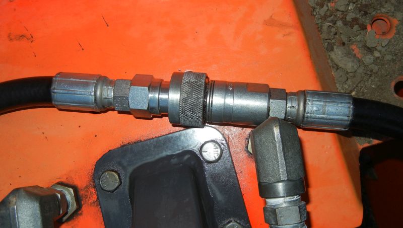

I have a new to me L3400 with a Bradco backhoe.. There were no leaks or anything that I know about until this past week when I disconnected the backhoe.

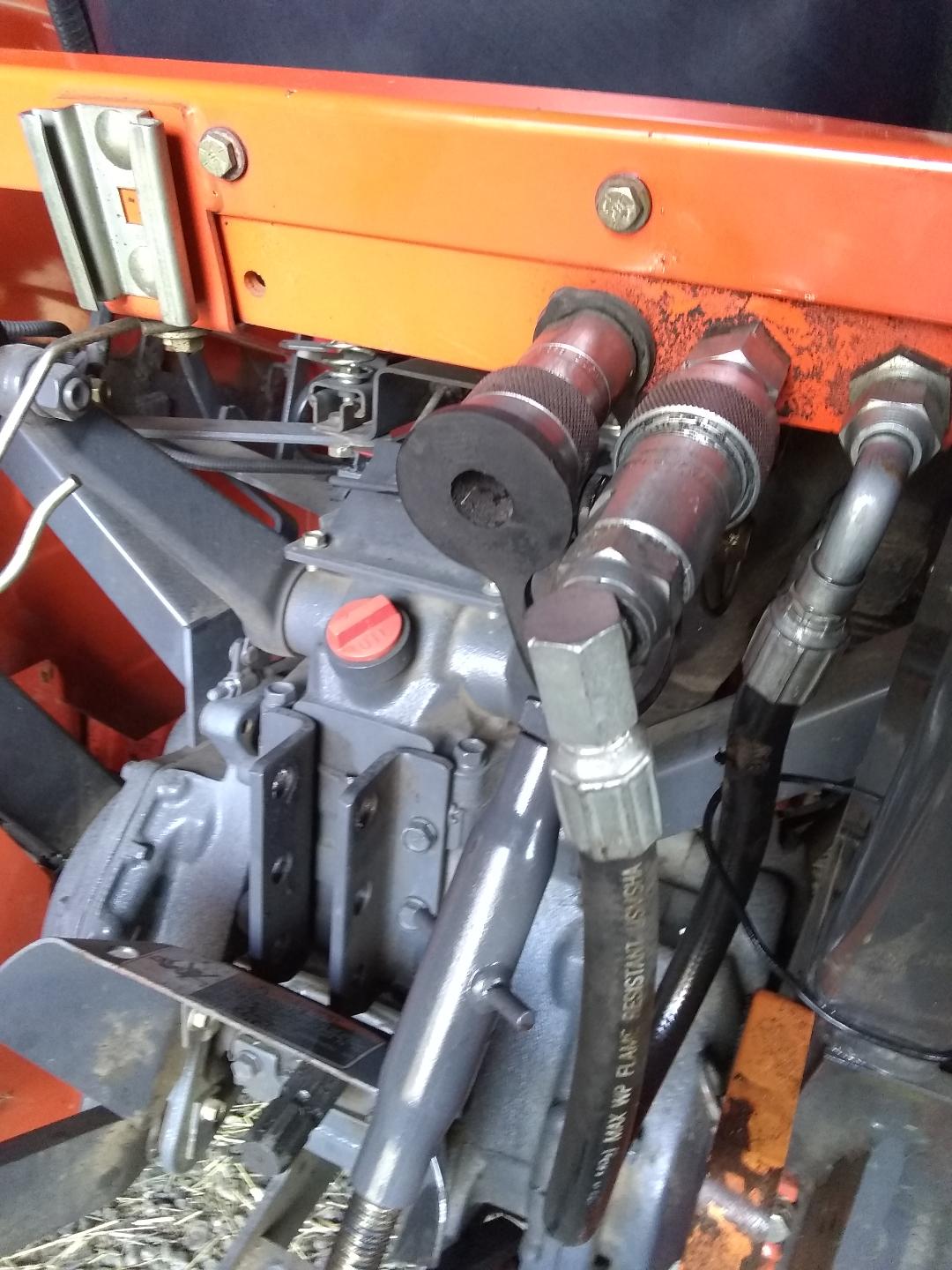

The tractor has a male and female quick connect at the back where the 2 backhoe hoses connect.
When the backhoe is off there is a short hose coming out of a 3rd port on the aux block with a female coupler that hooks back to return the fluid.
So my problem is that regardless if I have the loop/bypass hose hooked to the tractor OR the backhoe female hose , the coupler drips constantly.
I have tried cleaning everything but still drips. The fitting on the tractor is male and all the orings and moving parts seem to be in the female side. Seems odd that
both the backhoe female fitting AND the Bypass fitting would both have bad orings , doesn't it?? The drip is enough to soak a rag in 5-10 min of use. (I tied a rag around the dripping fittings)
Another question is when the backhoe is off, I connected it's 2 hoses to each other, thinking that would keep the ends clean as it sits in the yard. That connection is now dripping as well.
I guess that makes sense since it is the same female end that was dripping on the tractor. Should I be looping them to each other in storage like this or is that a bad idea?
Also when you connect/disconnect these fittings, is it normal to get a dribble of fluid out? I have tried moving the levers around before doing so to relieve pressure but I always get a dribble.
My last question has to do with the safety of this fluid that is leaking? Is this basically the same sort of thing as ATF from my car in terms of toxicity/handling? I got it all over myself and I am sure some drips have reached the ground. I have read horror stories of people getting poisoned by hydraulic fluid.

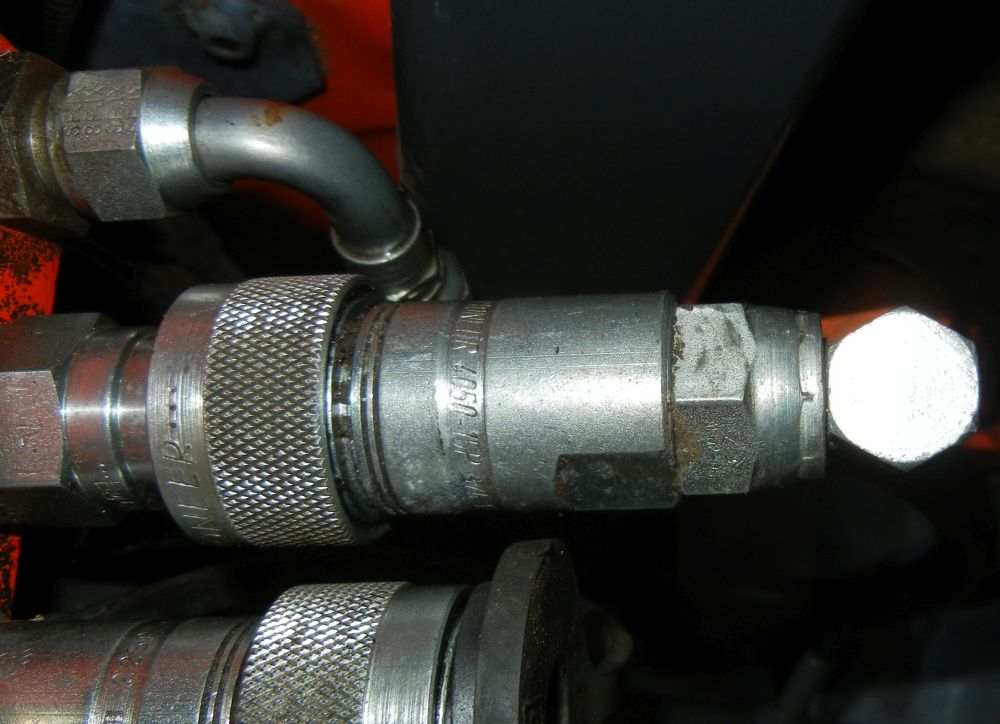

Best to get male and female parts as a set. There are two types of ag connector- ball valve and poppet valve. Poppet is the newer style and most tractor makers use them. Most poppet connectors are supposed to handle ball too but sometimes they don't. The male sides cost $5-6 so there's not a lot of reason to use old ones.

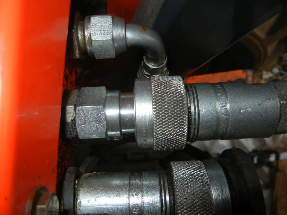

The female connector with the 90 elbow on it does not look like the standard NPT female. You may need an adaptor between the connector and the elbow.

My feeling now is that I am not getting these hoses on all the way. They are on enough to not fly off and for fluid to pass but not to make a good seal. I notice a shiny area that is exposed when I have the couplers connected. I look at my loader couplers and there is no such space. I also looked at some at the dealer on backhoes and no such space.. Granted the loader and the dealer backhoes are different brand couplers, kubota ones.. Mine say made in italy.. so maybe they connect differently but it seems mine should go on more but I have moved the bucket control every which way til nothing moves and I have lowered my 2 pt hitch all the way to the ground and I still can not push this on any further. I have tried with/without the collar retracted.. See photos.fittingopen.jpgloaderfitting.jpg

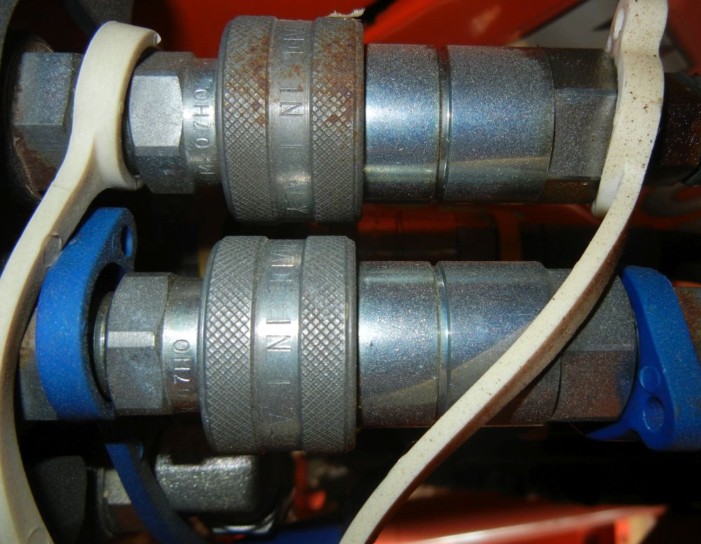

Pioneer 4050s have the regular collar that pulls back to unlock. When the male part is fully seated the collar snaps back and there's a click.
1/2" couplers can have 3/4" threads.

Revisited this today with a clear mind.. The coupler is going on all the way. That exposed band in my pic is normal, based on the distance from the ball bearings to the end of the female 1/2 and the distance of the groove in the male... Fired it up again and let it idle about 5min, still got a drip at the bottom. Doesn't seem as bad as it was the other day but it's 50 deg out and it is all cold.. The other day when it was dripping fast, the fluid was hot as I was working it pretty hard.. I think I just need to replace these and be done with it. thanks all
