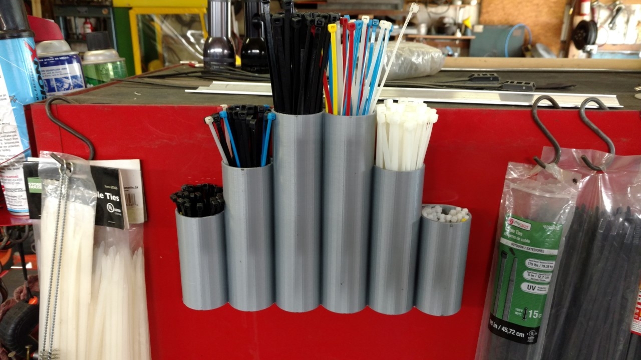

I thought about that, but I'm not sure the PLA I use would be strong enough, and I probably spent less time making it on the lathe than I would have making a drawing and printing it out.
I have made several tools and other items for use in the shop in the last few years since I got a 3D printer. The last one was a tool to install the lower crank seal in the Briggs engine in my niece's LA125 lawn tractor.
Here's a cable tie holder that hangs on the back of my tool box.
