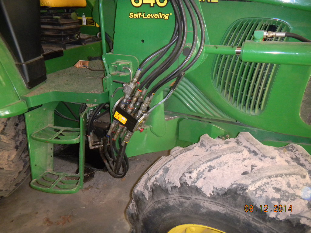

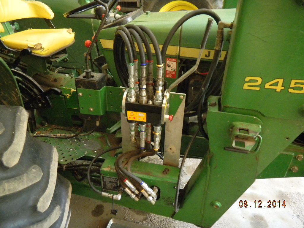

I noticed the colored tie wraps on the lower hoses, nice touch.
I would add them to the upper (loader) hoses in case a dust boot gets torn off.
I put them on mine even though I have Multi-coupler. It confirms I am putting the coupler half on right (even though it only will go on one way)

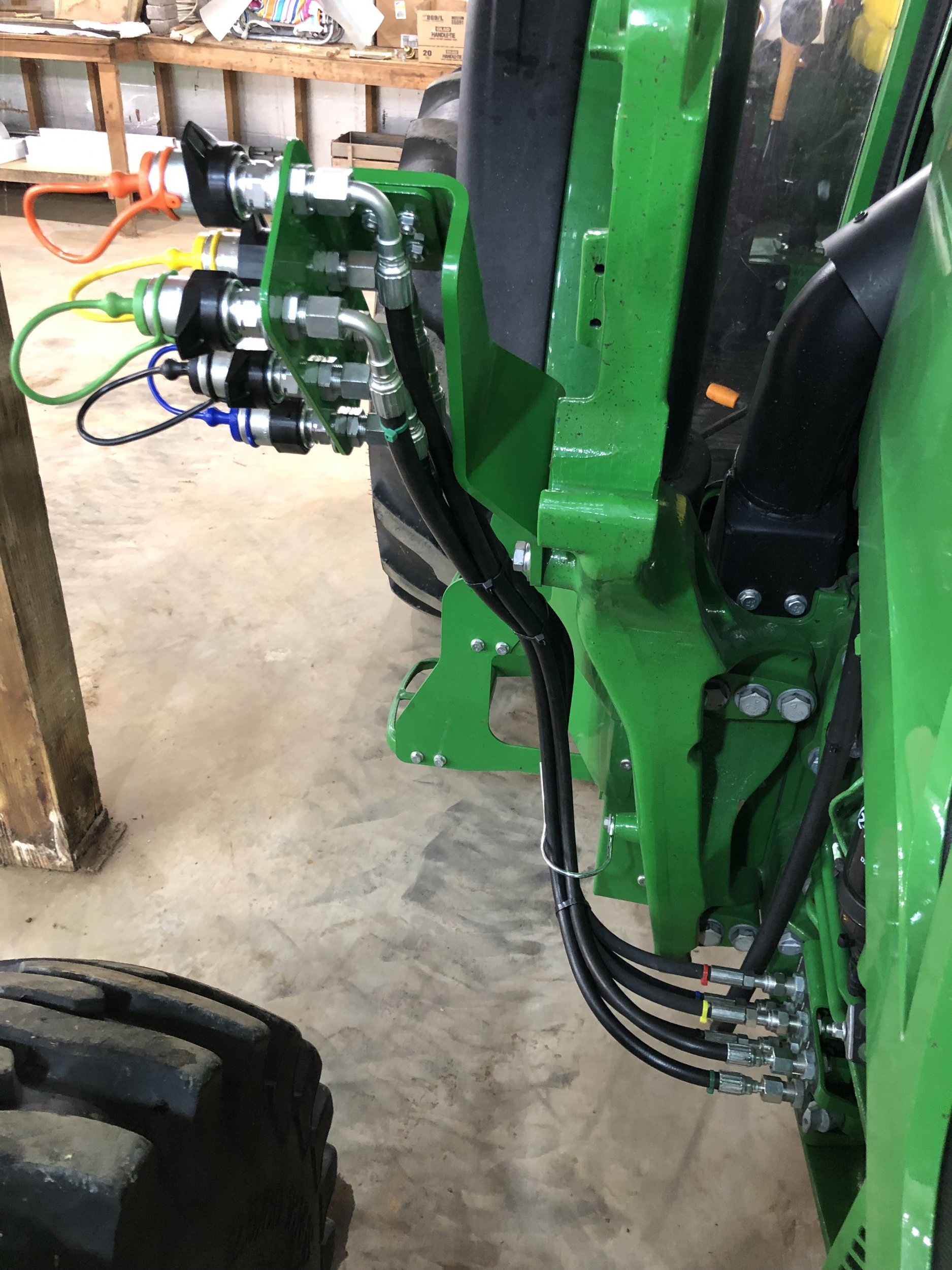

Real nice work BD I like the uncluttered look also. You were fortunate to find another 5115m set up just the way you'd order it, especially the creeper gear option. I've got a question , does it look like those 6 bulkhead female couplers would also mount to the lower mid frame bulkhead and thread right on to the ORFS female fittings? I've been looking at your good pictures and they appear they might be what I'm going to need for my 540 loader when it arrives. Thanks
   / Hydraulic Hoses, Couplers & Brackets for JD 5115M Loader Frame Bracket Mounts
#50
Thanks Seven Gables.
The 6 male flat face o ring fittings down on the mid frame has female caps on them when their is no hoses connected to them.
they are the exact same male fittings as the quick couplers up top has on the backside of them.
I think their called #8 (1/2”) flat face o ring fittings.
both are male fittings so you would need a double ended female fitting with swivel fittings on each end to connect the two together.
I hope I explained it correctly.

You miss understood my post just a little. I want to remove those 6 male orfs mid mount fittings that came w the tractor, unthread them from there steel lines. Once I do this it looks to me like those 6 female couplers would fit in the bulkhead mount and as I said before connect directly to the Female ORFS fitting on the steel tubing in back of the bulkhead mount frame. Thanks again.
#52
Oh sorry.
that might be possible idk.
I hadn’t had those male fittings down there unthreaded from the tractor
the hex nut you see against the black sticker is a jam nut to keep the male o ring fittings from turning.

Good picture. I’m just gonna remove those male jam nutted fittings and replace with the 6 female couplers that you have. The female couplers will thread directly to the Green painted steel lines.

That’ll work.
it’ll be like the older JD where loader hoses connected down under the floorboard (y)
That will keep you from hanging tree limbs you mentioned.

That'll work is what I wanted to hear. Another question, does it look like the 6 loader hoses are long enough to reach the lower mid mount bulkhead where my couplers will be? In your pictures the hoses appear to be quite long, be nice if I don't have to add a short length. I realize they can't be so short there almost kinked.

My 540M & H260 loader hoses are a little too long but they would never reach down to the frame connections.
Is your cab tractor a 5115M or R ?
   / Hydraulic Hoses, Couplers & Brackets for JD 5115M Loader Frame Bracket Mounts #58
First thanks for your help BD, your thread came along at the right time for me. It’s 2019 5115M . I thought the hoses would probably be too short but was hoping they might make it. I’m kinda green around the Green iron
