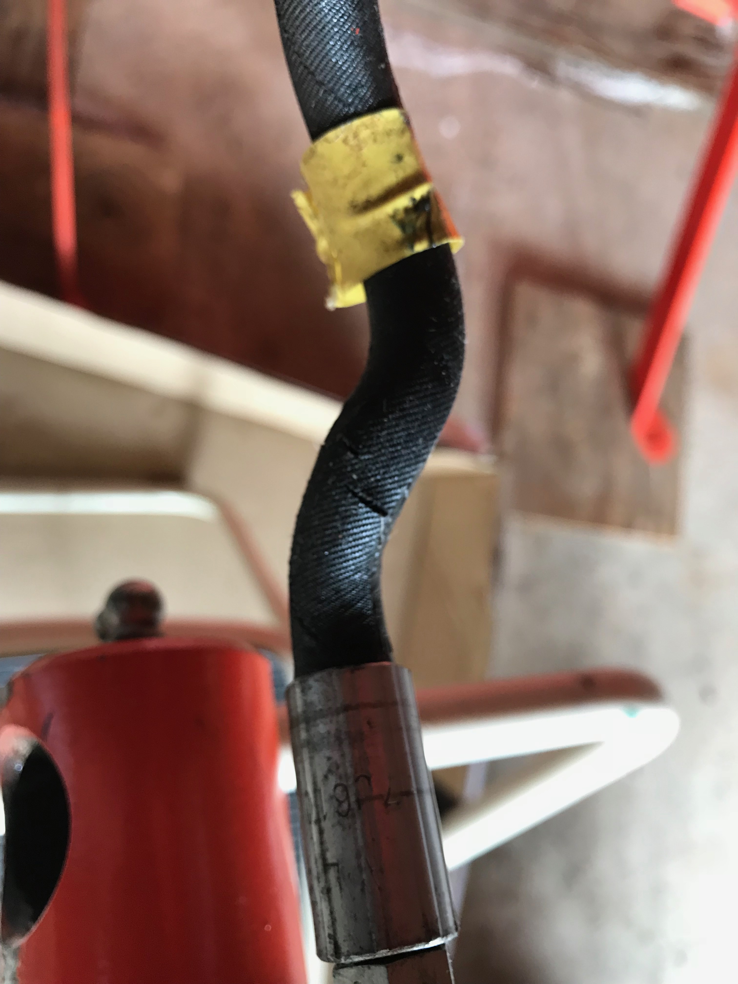

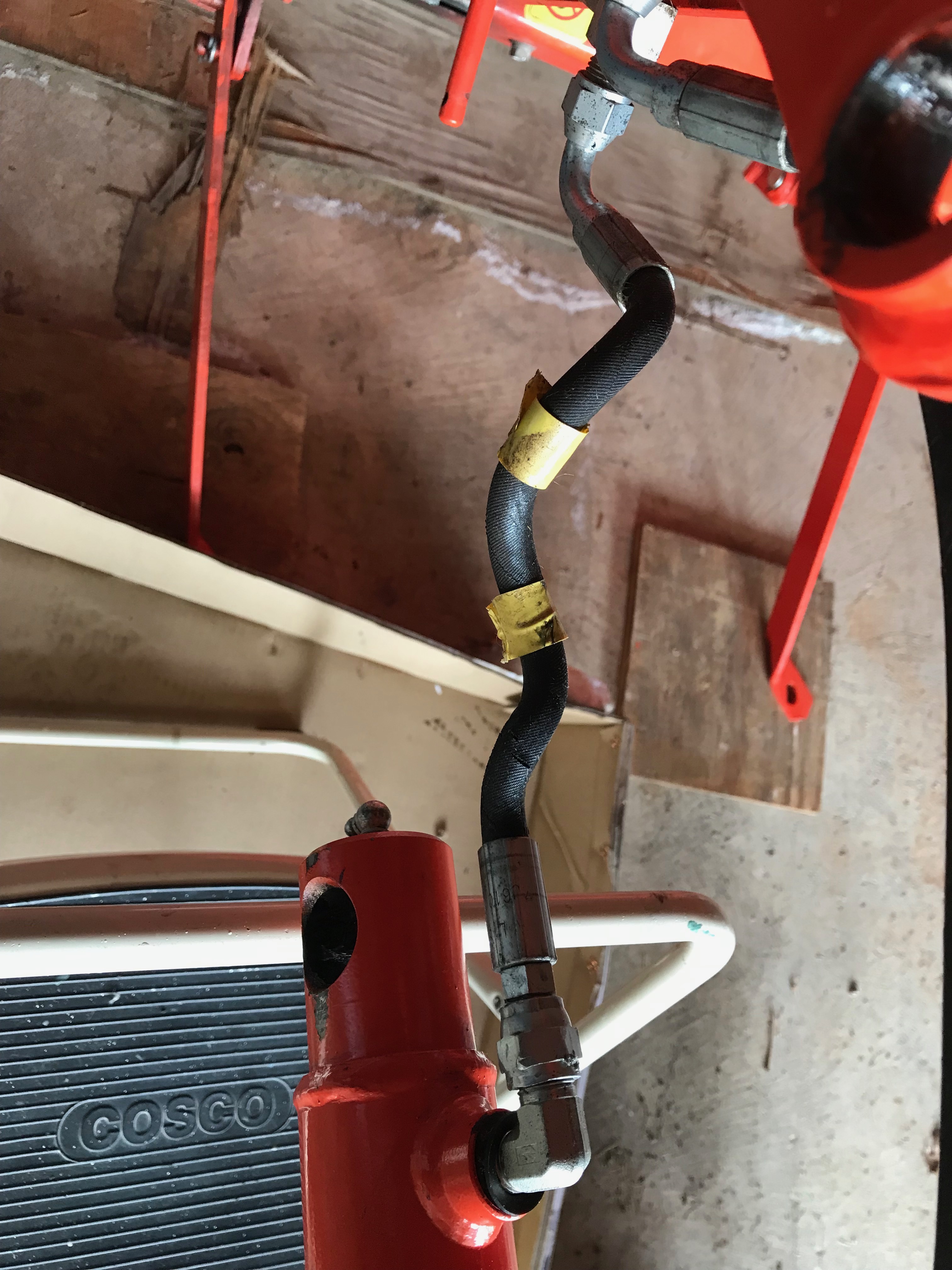

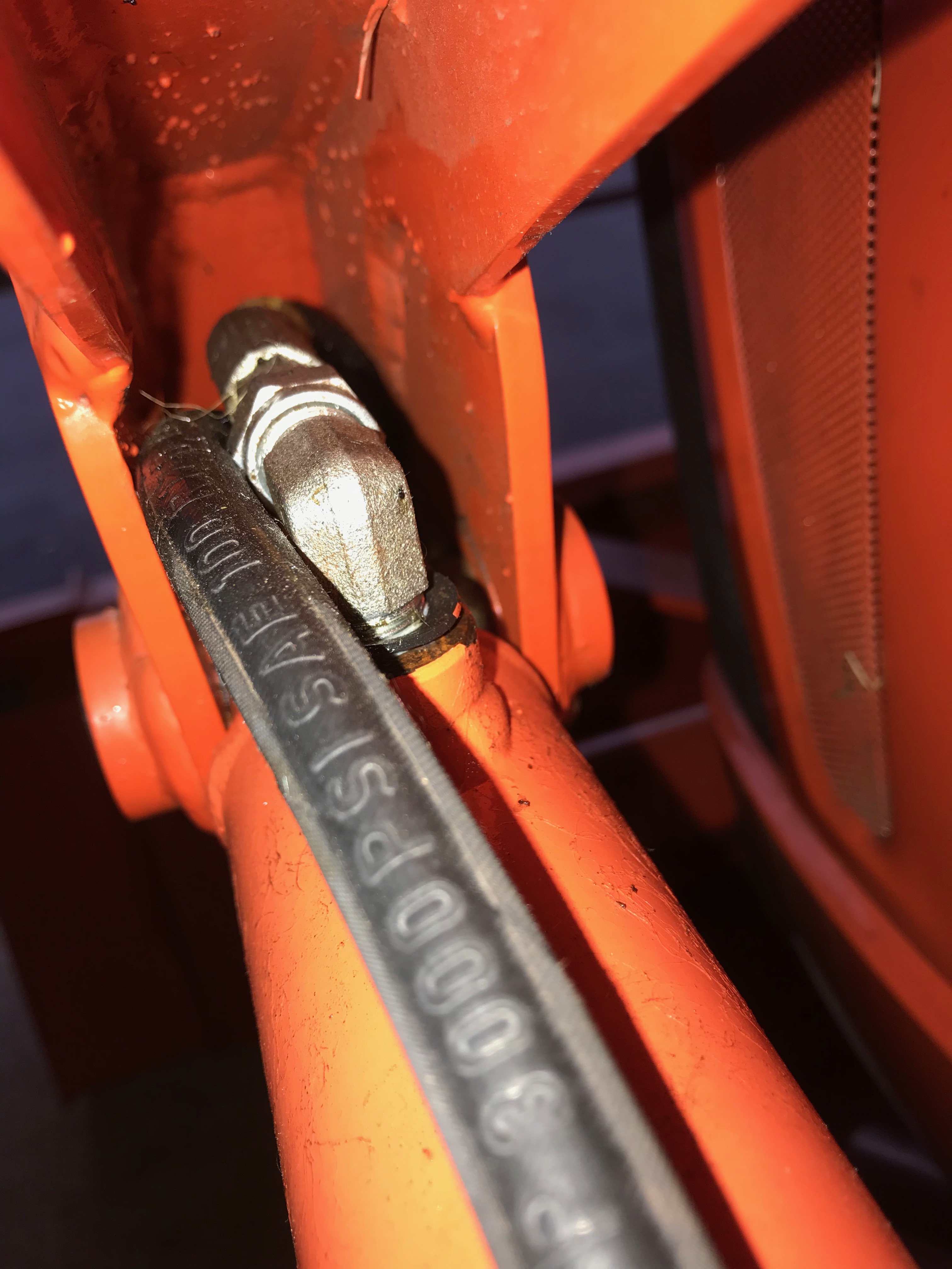

I have the LA534 Loader on the B2650. Just at the end of the season I noticed a leak just by the cylinder (see first photo.) I couldn't tell where it was coming from. Now that I'm preparing to reattach the FEL, I thought I would drop the pin on the cylinder and take a closer look so I could fix it.
When I dropped the cylinder the hose was twisted up and I can see a crack in it. I'm not sure if it's leaking from the crack or where I screw it in the cylinder. I assume to replace the hose and put it back in so its not twisted so much.
I've never worked on a hydraulic hose before and wanted to ask if there is a tool kit with various hose sizes that you can recommend for this machine, seeing that I'll be doing this on the regular and dont have the time or the resources to drive it an hour away to the nearest dealer.
I would appreciate any feedback.

No hydraulic shop to have hoses made , The end on the piston if you loosen the fitting you can straighten the hose out and use two wrenches one to hold the hose and the other to tighten the fitting
/ Hydraulic hose repair kit #3
Can you take the hose off and take it to a local hydraulic shop? Even Napa makes some hoses. If the hose itself is leaking there is no fix.

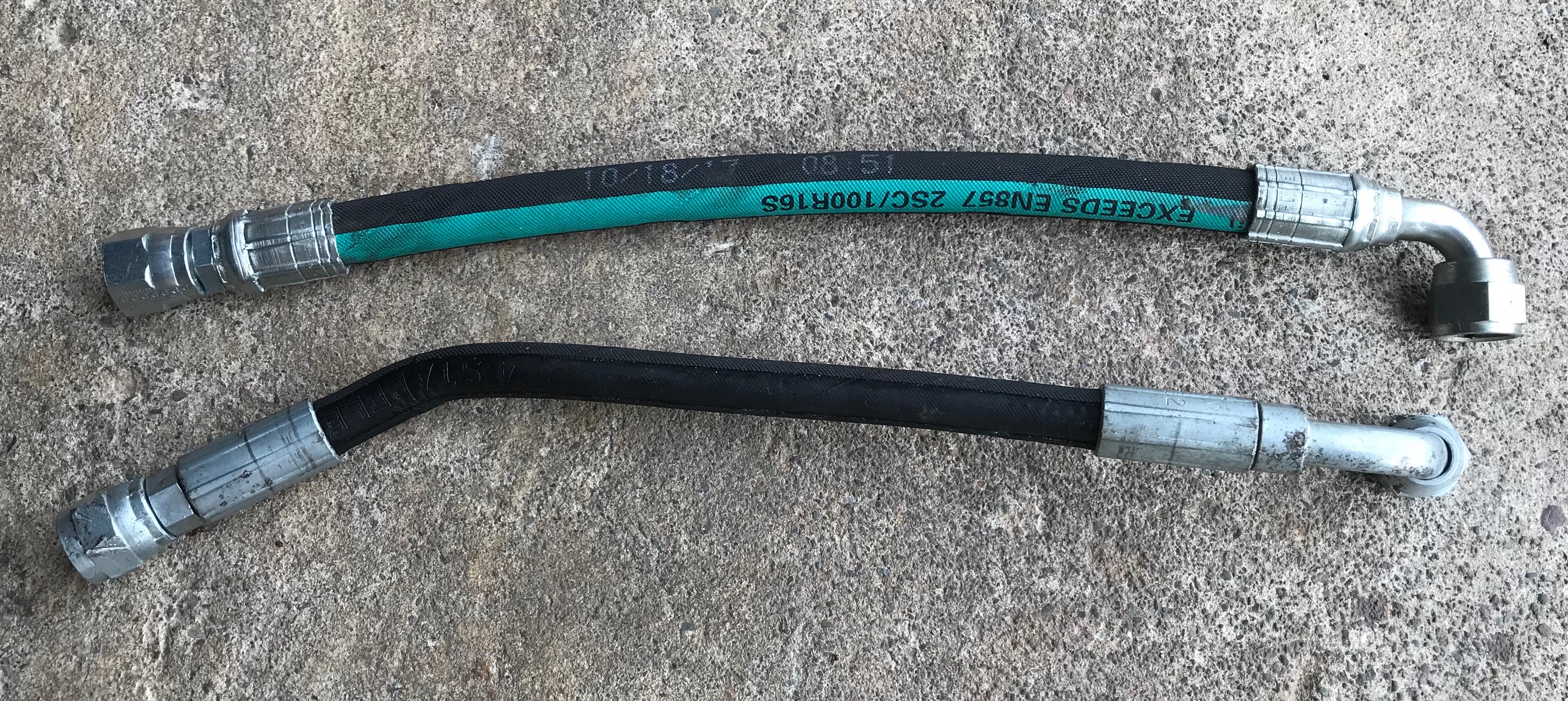

Just got back from the hydraulic shop. The new hose is with the green stripe. When I asked the shop guy if it was OK that this one's a little fatter because I had to run it in the groove of the FEL, he looked at me kinda funny. I guess it was a stupid question. lol.
Being that the cylinder is somewhat empty, I'm curious how once I plug it back in to the tractor and get it running, how does it deal with big pockets of air. Is there a breather or something that gets rid of the air so the system is pressurized?

Just move the loader up and down , open and close the bucket it will bleed itself ...

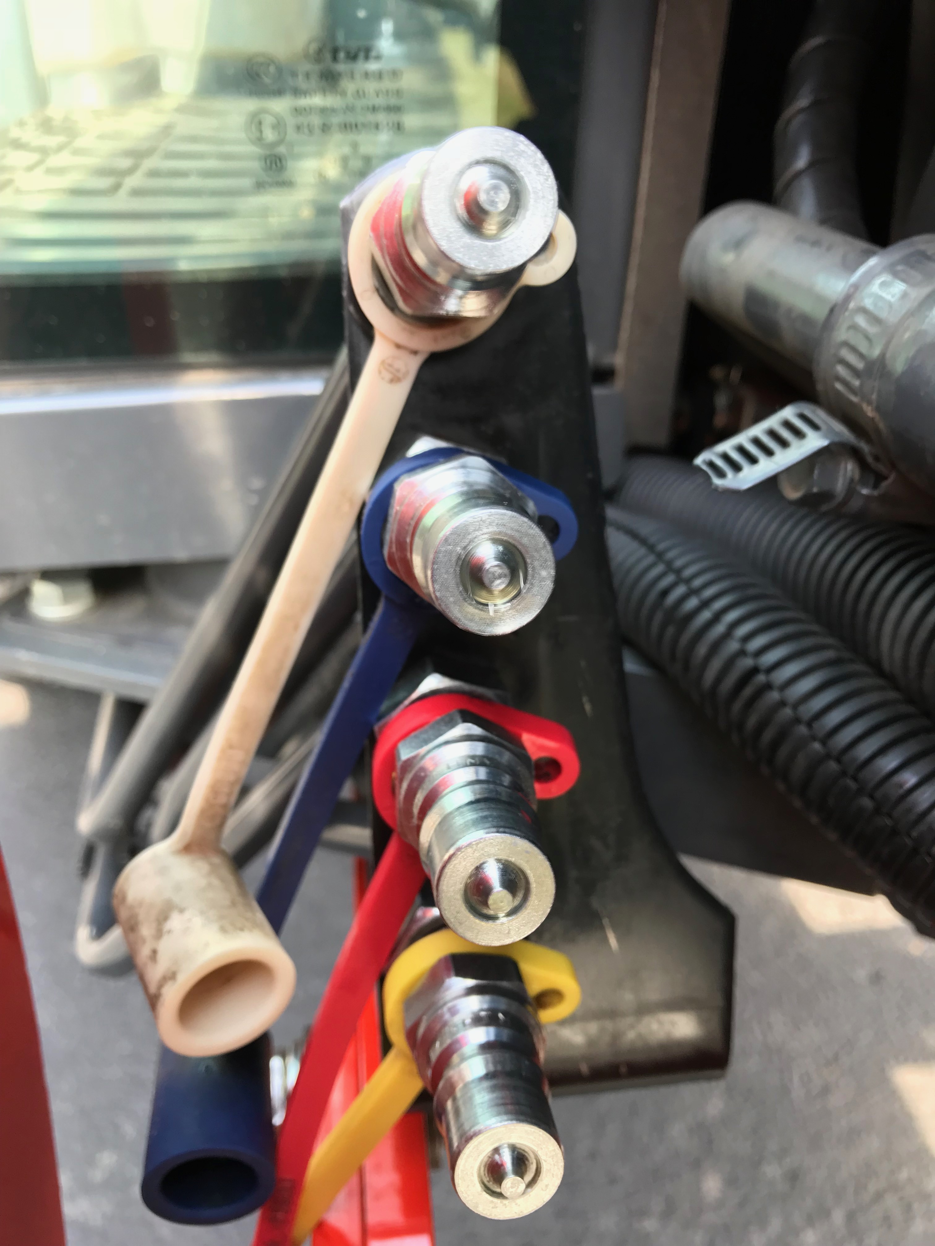

I just noticed a leak on the floor. I thought it was just from taking the hoses on and off. I wiped everything down best i could and revved it up to 2000 rpm's. I can see the blue male end leaking from the center pin piece. Is this something I can order and simply screw on and off myself or should I have the shop do it? It's still under warranty. I wonder if it has anything to do with the hydraulic cylinder breaking a few days ago, when I turned the blade to the left and it popped. Is left blue?
Please advise.

If those QDs were connected when things popped those sealing surfaces would be not touching at all. It could be a result of the repairs if you got any pipe tape, dope or other grit in there. It would prevent the poppet in the QD from sealing properly if it got lodged in the wrong spot. As likely to be a cheap or defective QD though. They are $30 or so to replace, but your dealer should take care of things under warranty.

Revving the engine up should have no effect on that QD leaking, unless the control valve is leaking a LOT. Maybe the extra vibrations or something, but there should be no real pressure on that QD unless you as actuate the valve.

those are jic fittings (a flare fitting) if any thing a touch of oil on the thread but that is not even necessary, all the threads do is tighten the flare up as that is the sealing surface.

Often a very tiny piece of trash causes a leak like you have. With tractor off and pressure broken, push the center in and wipe it and you may get it clean. Put rag over the fitting, push in with a tool such as socket extension to have a flat face to push with and let the rag control any spray if any pressure remains and to wipe the fitting. Try to be in habit of wiping those fittings clean before connecting them.
Note some companies use a more expensive push to connect and pull to disconnect then the female fitting you must pull the outside sleeve back to connect or disconnect, those are costly.

I used the flat end of a chisel to push the nipple in while the engine was off. Still leaking. I turned the engine on and pushed the lever to the right , pushing more fluid out. I used the chisel again and more fluid leaked out, no great pressures to deal with. Still leaking. I hope by swapping out to the new nipple it will hold. I'll post my results after it comes in sometime tues or Wednesday.
