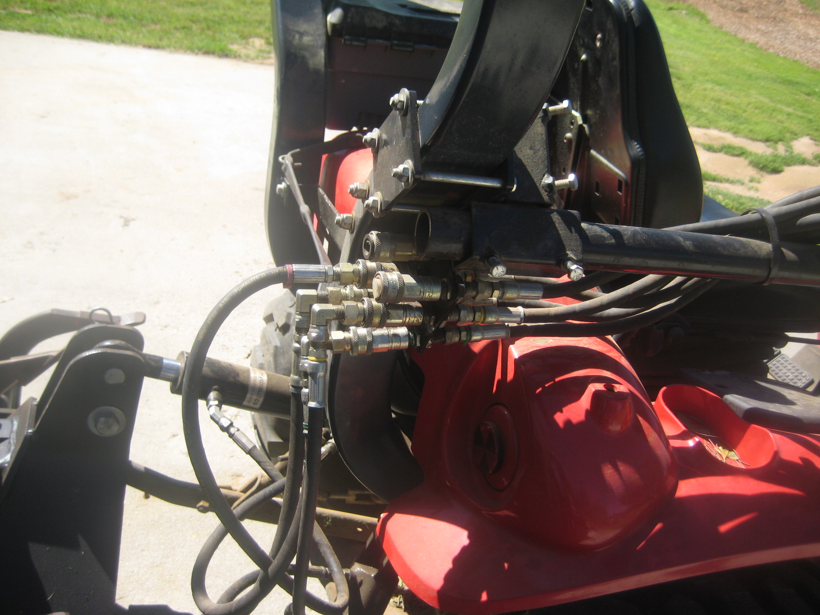

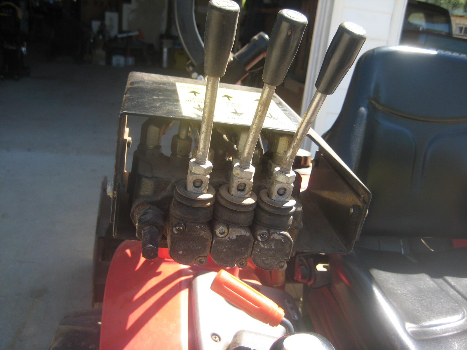

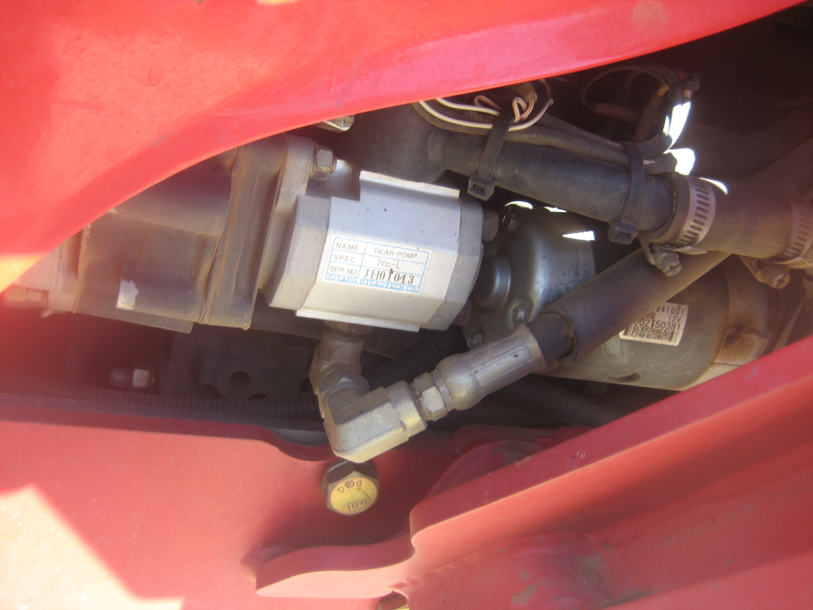

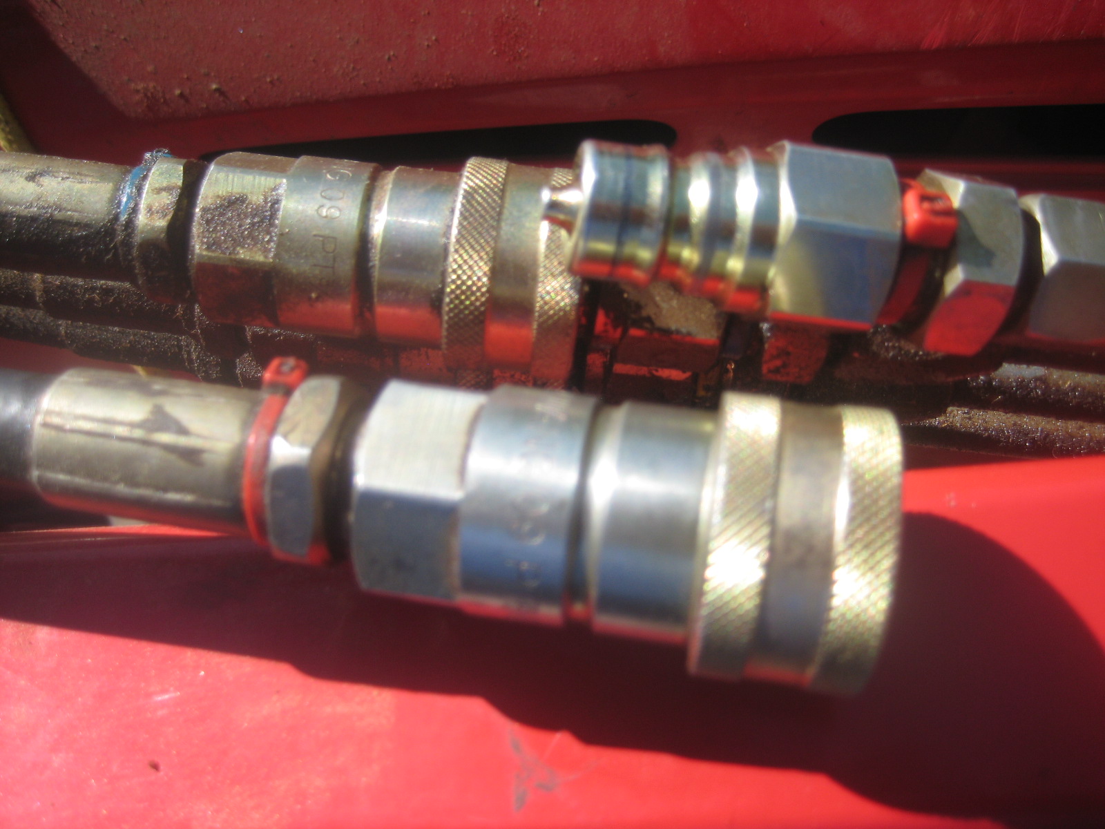

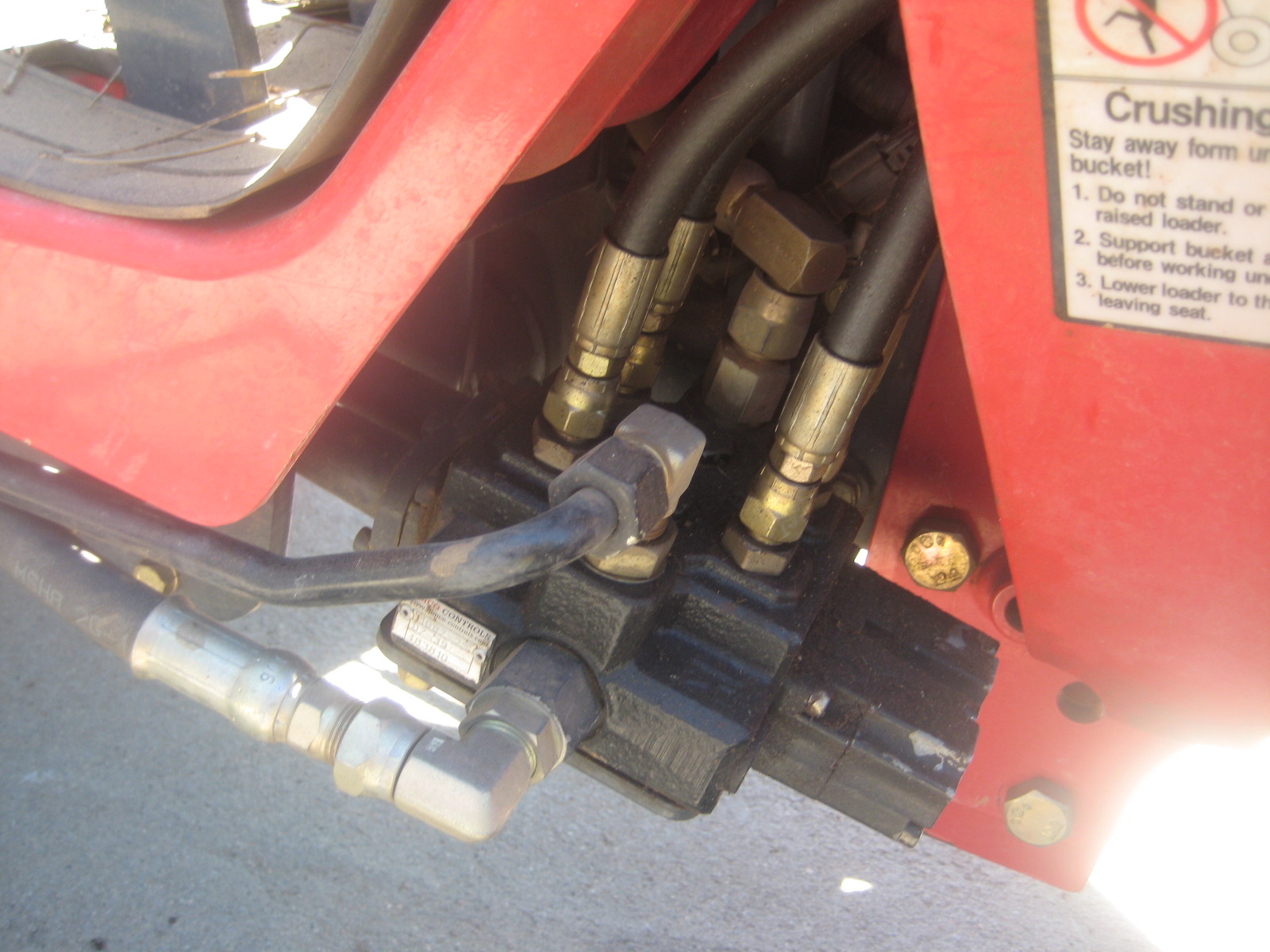

Anyway, here are some pictures of the valve, hoses, loader, etc. etc. Loader Hydraulics 001.JPGLoader Hydraulics 002.JPGLoader Hydraulics 003.JPGLoader Hydraulics 004.JPGLoader Hydraulics 005.JPGLoader Hydraulics 006.JPG
Pic (1) is valve, (2) is the KWANG fitting to be interchanged with, (3) shows my loader connects, (4 & 5) are my aux valves - Top&Tilt&spare, and (6) is feed from my pump - which is where I think I will install (eventually) a permanent gauge to monitor my system. I believe a Tee will work just fine there and it's not that difficult to get at. That's all just future thoughts at this time tho.

Hi Marty, My 7241-A QD's came last night. I only had time to give a quick check and "Yes" they fitted into the KWANG's nicely! I didn't run under pressure yet but am sure that as long as they completely connected together they will be fine. It looks like I will now have several spares on hand also. I will be able to complete my gauge and then begin focus on my step by step diverter install. Thanks Much for the right information that I needed. I will also post this in the hydraulic section since I originally asked for help there also.
Thanks a bunch! Greg
