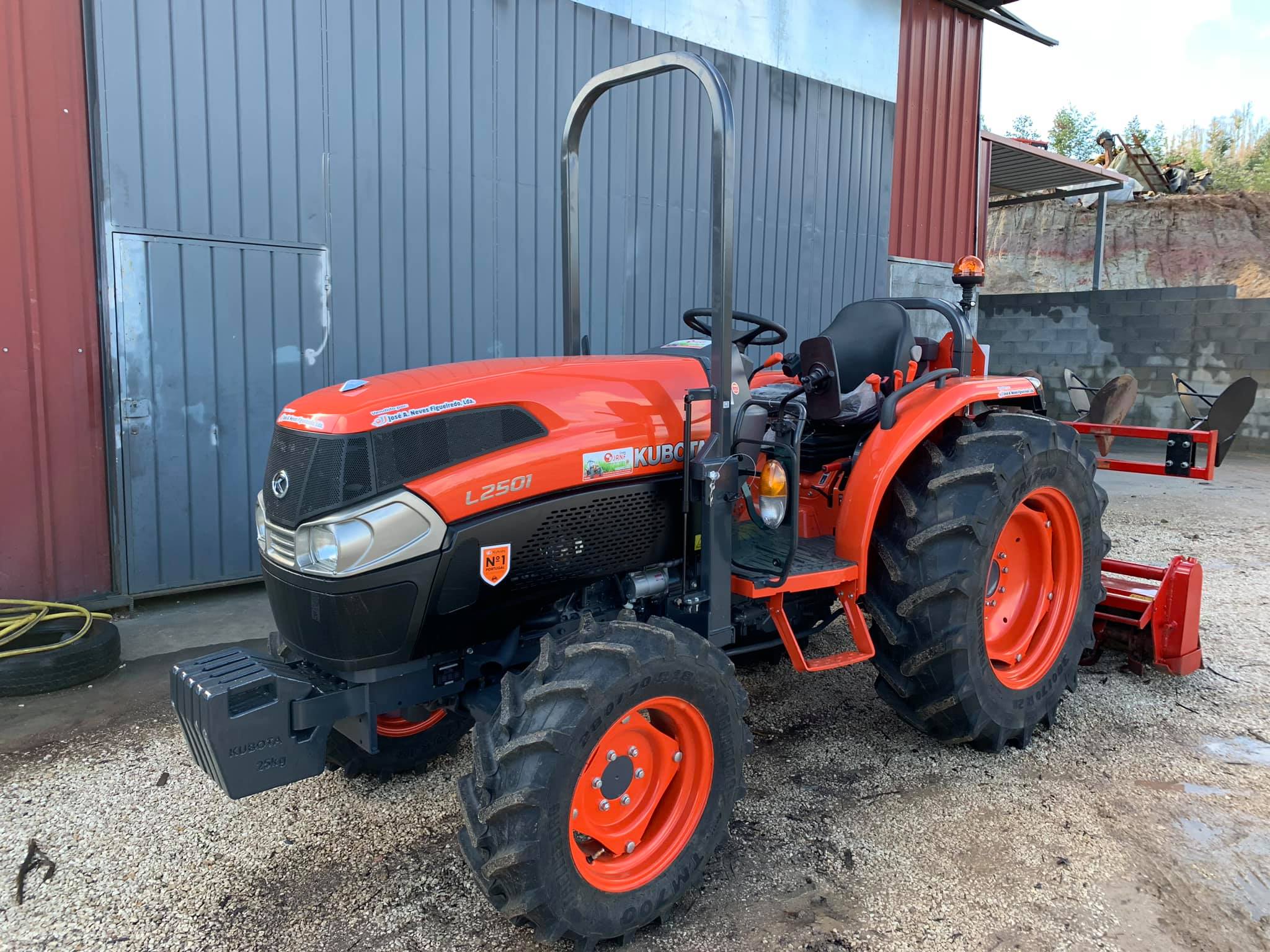

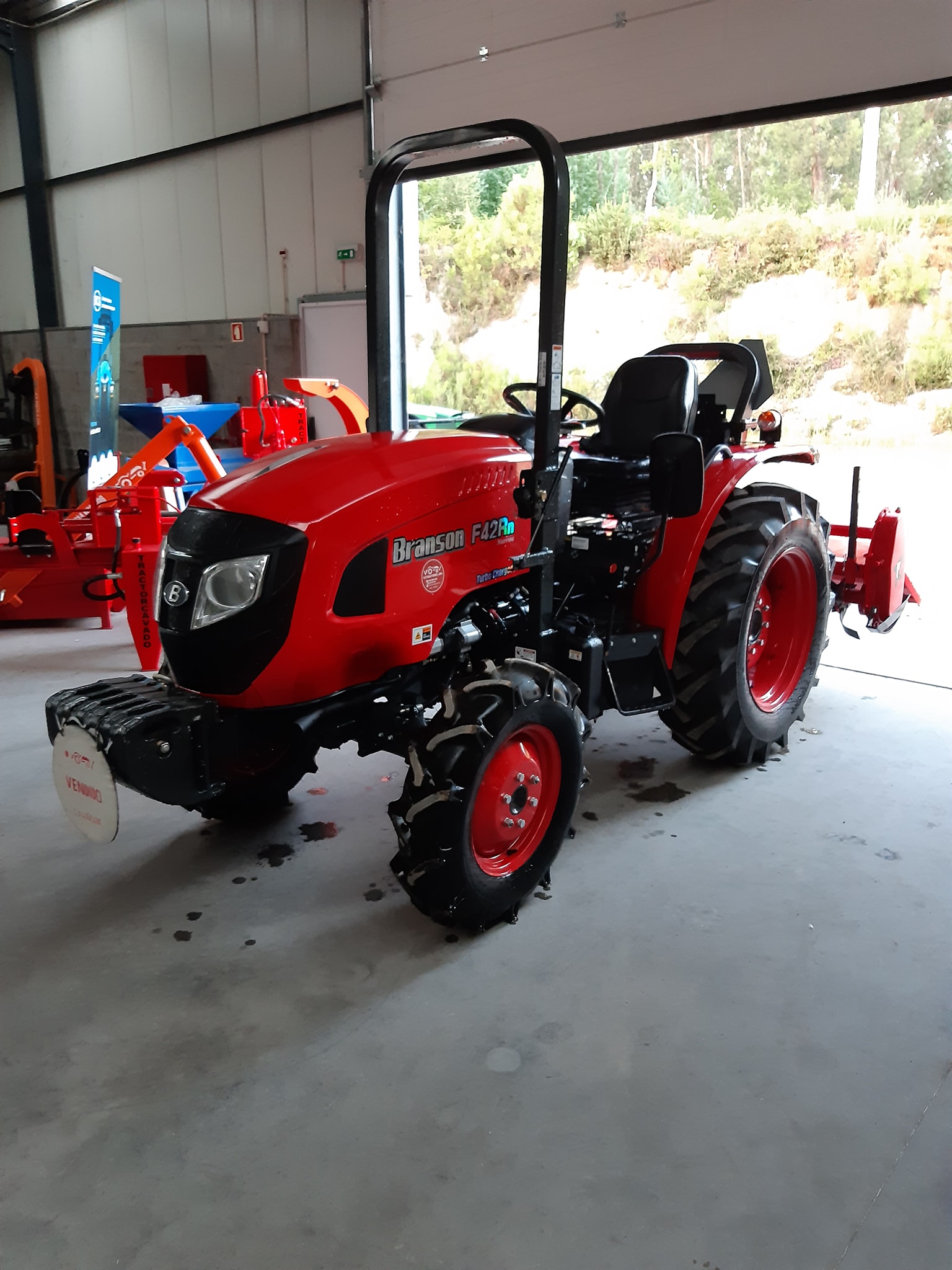

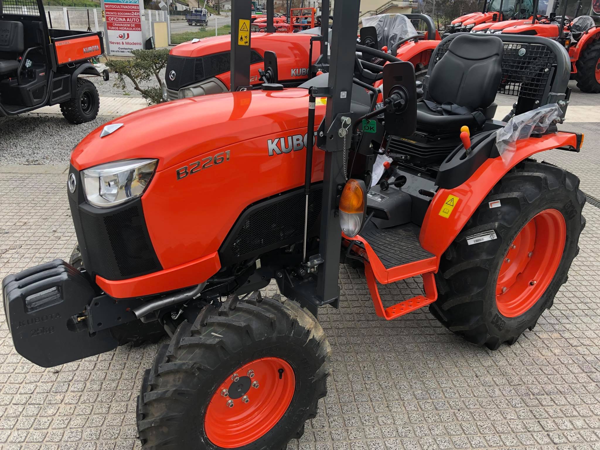

In Portugal, Spain, Italy and maybe a few others, tractors come with a Mid mounted ROPS because the tractors are used under trees (orchards) most of the time. This style of ROPS folds over the hood and makes the tractor have a very low profile, the highest spot being the steering wheel actually.
Anyways, these style of ROPS is very heavy and hard to fold up, since it's such a big loops. A couple years ago, most manufacturers start adding gas cylinders from factory to help lift up the ROPS. I'm pretty sure it was mandated by the UE, since we're having so many deadly tractor accidents because the operators won't lift the ROPS.
I'll try to share a couple of pictures to give you an idea. Granted, you would have to come up with all the proper geometry for the rear mounted ROPS, but it shouldn't be to hard, plus you plan on using U-bolts which allow for ease of change on the pivot points.
Note the gas cylinders attached to the ROPS. One on each side of the tractor.

Thanks for the information.
Gas cylinders could be a workable idea but it would take some work just to loosen up the action on the ROPS. They are so stiff on both my tractors, even with loosened hinge bolts, that it takes quite a bit of effort to fold them down.
