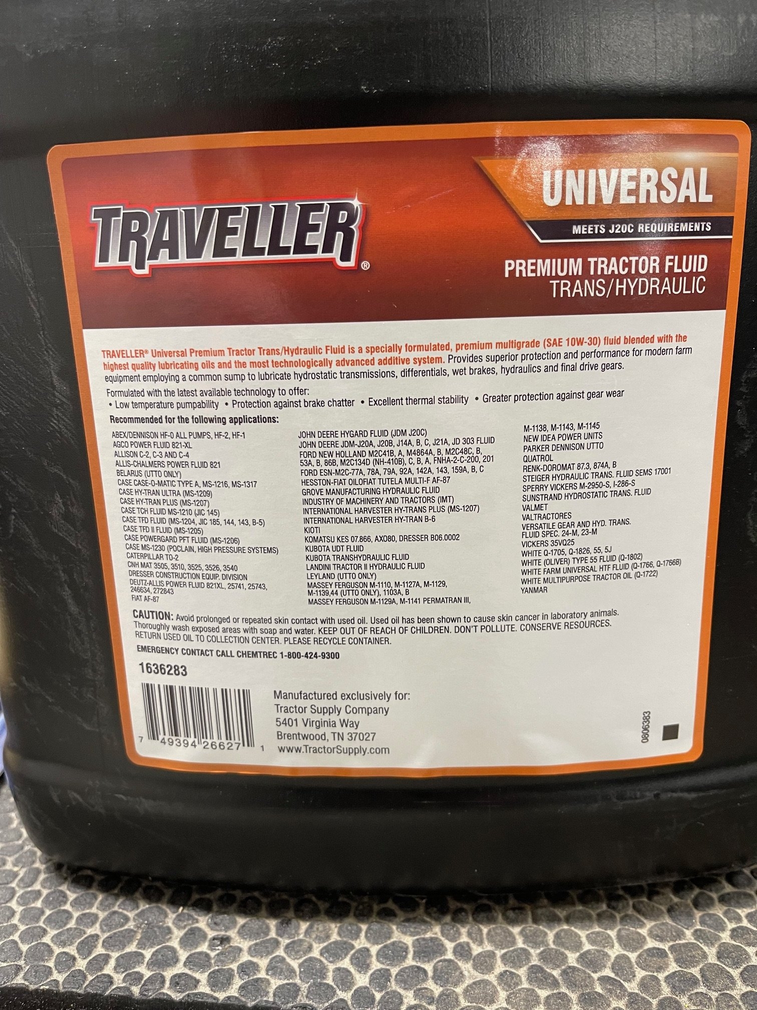

Just to keep everyone on the same page….
I realize that the title is “Hydraulic Fluid” but the op really needed info about Trans/Hydraulic fluid which is different than Hydraulic fluid.
This is what he was inquiring about…
Traveller 5 gal. Premium Tractor Trans/Hydraulic Fluid​

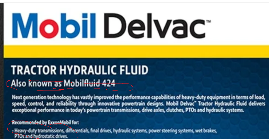

I was surprised to see that Walmart carries 2.5 gallon Mobil Delvac Tractor Hydraulic Fluid, which is the same product as Mobilfluid 424. Mobilfluid 424 is one of the Kioti service manual named fluids to use, even in Hydrostatic tractors.
Walmart link: Robot or human?
I think that you can probably find all the fluid you need if you're willing to drive around to a few Walmarts, the price is pretty decent too, right now it's $43 for 2.5 gallons, and there is a $10 rebate (up to two of them).
