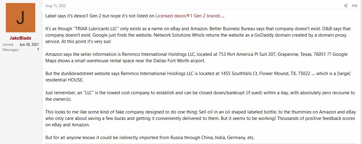

Good grief! The scam artists are tiring of making telemarketing calls and gone off into selling oil...well maybe it is oil. Or air or ....maybe you will never know because nothing would be delivered !!
