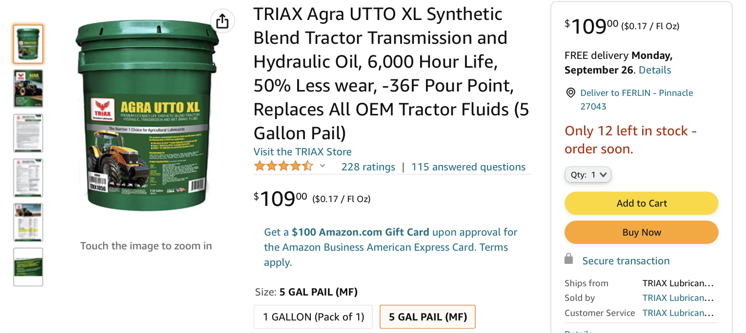

Good grief! The scam artists are tiring of making telemarketing calls and gone off into selling oil...well maybe it is oil. Or air or ....maybe you will never know because nothing would be delivered !!
I'm pretty sure that the company delivers their product. But what is unknown is the source of the oil. No refinery listed. Where did it come from? Do they refine it themselves, or repackage another refiners product. Just because a label says it meets spec, still requires due diligence. OEMs usually don't list detailed spec sheets as they often switch suppliers and formulations can change, but the refinery is normally listed in the MSDS. Triax seems to be located in a warehouse/cross docking/distribution facility in Texas.
TRIAX LUBRICANTS LLC
1809 W Frankford Rd #160, Carrollton, TX 75007

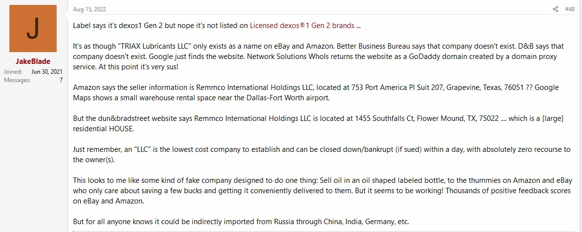

I'm pretty sure that the company delivers their product. But what is unknown is the source of the oil. No refinery listed. Where did it come from? ... Triax seems to be located in a warehouse/cross docking/distribution facility in Texas.
The plot thickens.
Google shows some Unit 160 tenants, not including Triax.
And ... Honeycloudz! Cute website :
And;
In summary - Triax, selling only on Ebay and Amazon, is a drop-shipper of someone else's refinery. Maybe Warren or Amsoil? Their business activity is billing, not buckets. The BTOG post saying they use a licensed trademark while they are not listed as a licensee, isn't reassuring.
