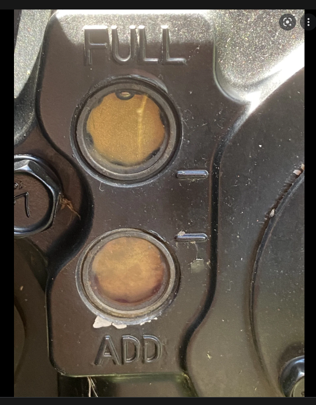

ya you should have a eyes glass to see your level it can be hard to see if full (most likely the case) and when your oil is newer its pretty clear, if you put your tractor on a decline front wheel down check it then put it back level and you will see the difference.
/ Hydraulic Fluid
I’ve inspected my 2025 pretty thoroughly and have yet to see something like this but I’ll check again.
Thanks!
