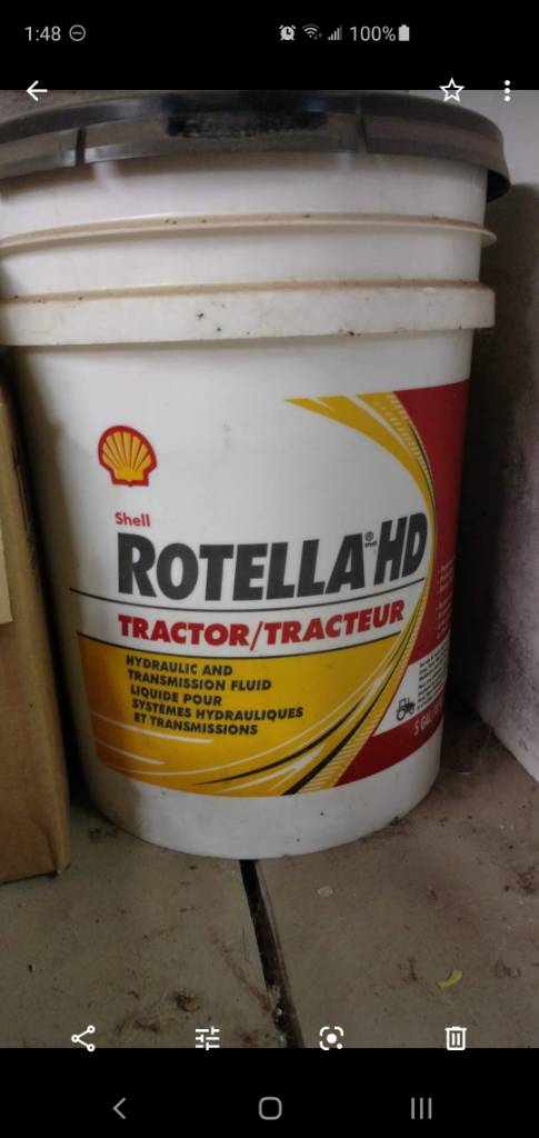

   / Hydraulic fluid #4
I've always used Shell in my Max 26xl. Typically from Tractor Supply because its close and always available. Screenshot_20200723-014812_Photos.jpeg
