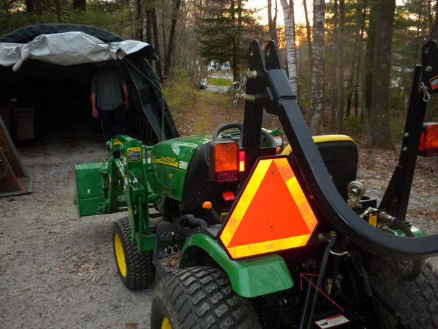

okay dumb question here:confused:. I have had my 2320 for almost a year now and can not figure out how to check the hydraulic fluid level. None of the manuals I have for the 2320 shows me how to do this. I know this has to be pretty straight forward....... but I am asking..... because I don't know...

IIRC, there's a "Oil Level Eye" in the rear a few inches high to the left of the PTO shaft.......
it should read in the middle of the eye with all cylinders retracted
   / hydraulic fluid #5
Here......at the arrow

as wdchyd pointed out, there is a sight glass near the rear PTO. I never saw any bubble in my window so I decided to add some fluid. It was almost 3 quarts low, and I feel it came this way from the dealer when I took delivery last may. I never had any issues but its good to know now that its at the proper level.
