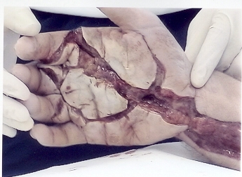

Here is an example of hyd fluid injection.
Most of the damage is caused by the removal of contaminated flesh.
You can see the hole where it went in.
