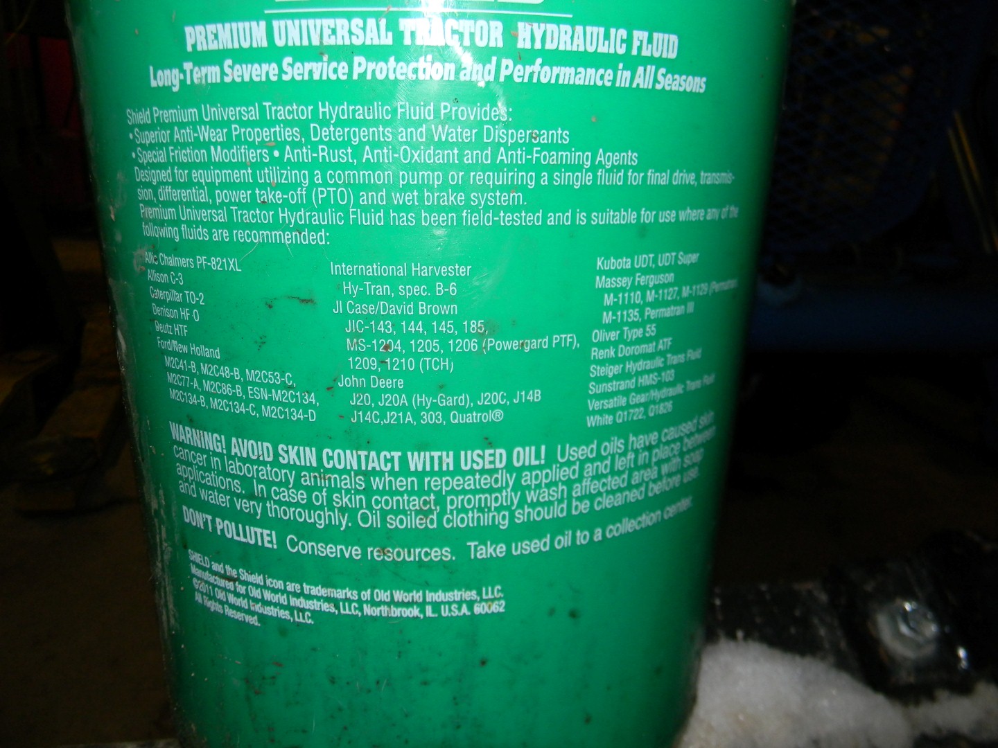

So what is consensus on the brand and type of hydraulic fluid to use when replacing it?
This what my dealer gave me for my gear drive.

I use the Traveler Premium in my Hydro. From what I read here on TBN, it is up to most Mfg's specs, and it is good for cold climates.
