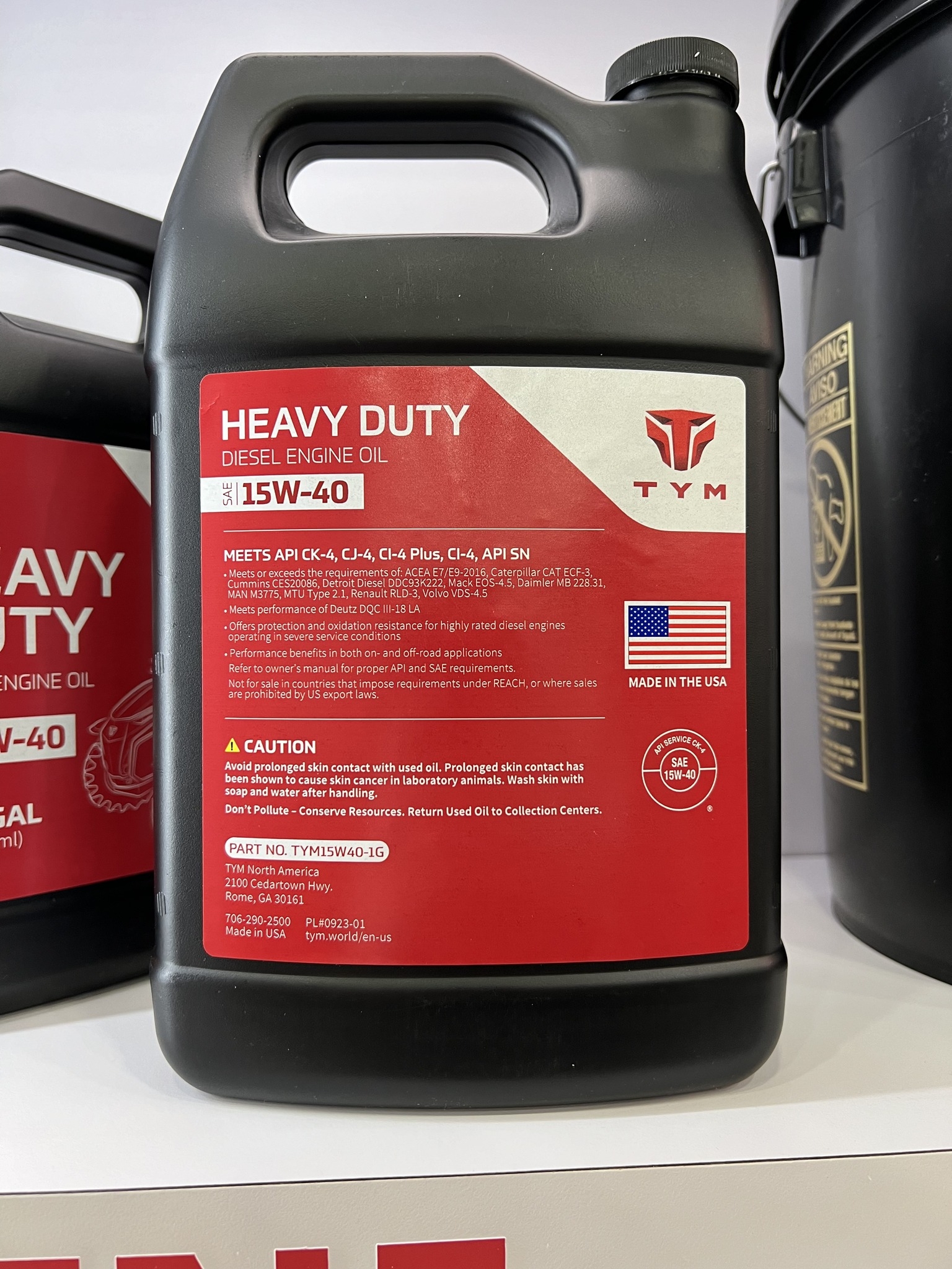

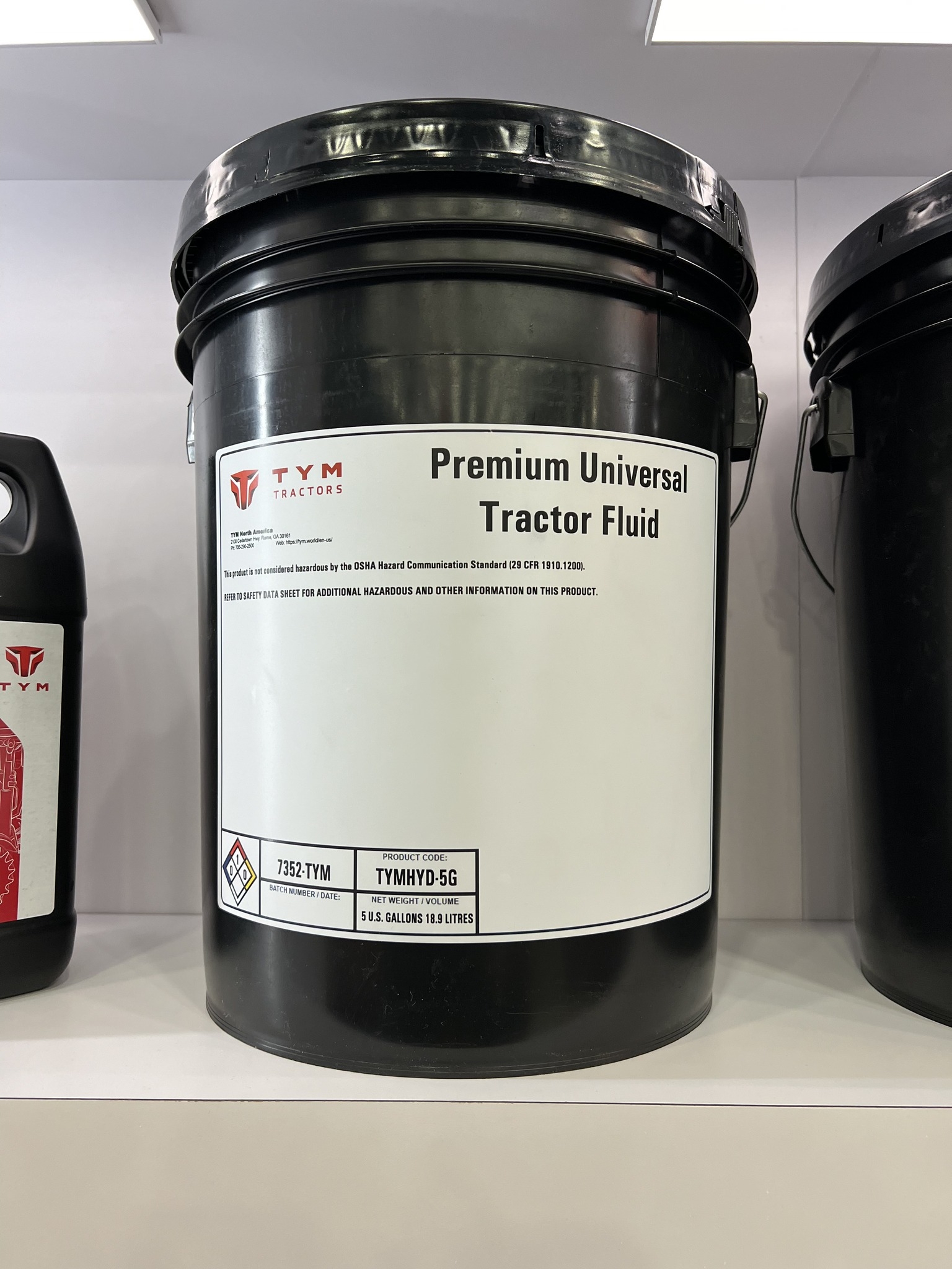

Early this year in National Farm show, TYM presented its new range of fluids. Engine, transmission, coolant, etc. Looks like those are made by American Refining Group, Inc.
