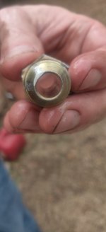

Noticed my hydraulics were leaking. Couldn't figure it out as to why and noticed the fitting had some pitting and scratching on it.
Does anyone know the size of this fitting? Hoping to get it fixed by tomorrow morning and finish up some take before it pours for a week straight

Sorry for the terrible angle. Took a photo to show the fitting that shouldn't have passed inspection.
It's a JIC to Orb?
/ Hydraulic fitting help #3
Any numbers stamped on it?

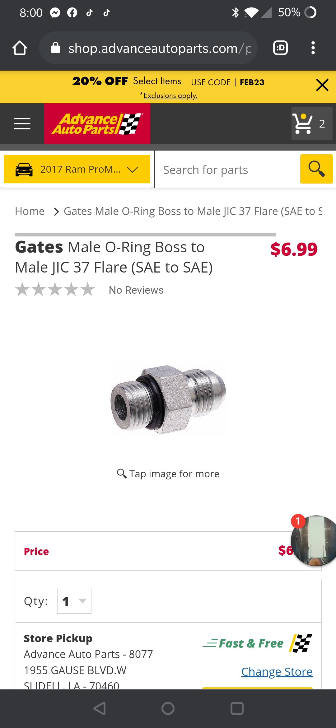

/ Hydraulic fitting help #5
Being that your thumb is about 1" wide, I guessing that it is a JIC 5/8 with a 7/8-14 thread. The other end could be ???
Were you using about a 1" wrench?
That sounds about right. I was on the trail and using a crescent wrench. So I would guess around that. Going to AutoZone or advanced when they open and see if they have a few different sizes and buy them and return those that don't work.
I'm hoping it's not the hose too.
