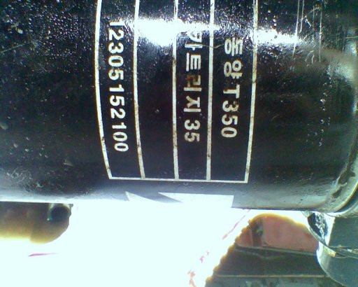

All the info I find on they hydraulic filter for my 2004 Gear 3510 is WRONG.
It says WIX 51621, which is the wrong diameter inside and out.
Here is a pic of my Mahindra filter. Please help!
Need WIX cross ref, if possible.
(I put the old one back on)
Thanks.

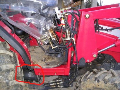

This is someone else's project photo, but it show the same filter and location as mine. (I've circled it)
I apologize to the original poster, I would give credit, but don't remember whose pic it is.
- JC

By the way, just paid $45 for a filter from a dealer that knows next to nothing about tractors- at least Mahindras. More on that later.
- JC

The filter you have circled on that 4110 is a large, cartridge type filter (suction side filter) that is inside the large metal canister and I have always had to buy mine from a Mahindra dealer, never could find a cross in any brand. If I remember correctly it costs somewhere between $25 - $30. The filter number you mentioned in your original post is a higher pressure spin-on filter (similar to an engine oil filter) that on my 4110 is located at the left rear of the tractor, up higher about seat level - you access it from the 3pt hitch area. My 4110 was built in 2001, don't know what filters they use on later models but I think the 3510's always used the same filters as the 4110.

Makes sense they moved the filtration from the high pressure side to the suction side. But this isn't a cartridge filter on mine- just a very large spin on. I haven't been able to find them anywhere except Mahindra, too. I'll be pre-ordering next time.
I had the system apart and drained before I realized the error, and with the about 10" of snow today so far, glad I got one right away!
- JC

I figured they probably would have changed alot since mine was built, plus being built by another manufacturer altogether would add to that assumption. You should be glad that filter is now a spin-on, it is a real pain in the a.. to change the cartridge in mine !! That canister is pretty heavy and the hoses & bracketing make it tedious, you have to drop the whole thing to seperate it to change the cartridge. Besides the cartridge filter and spin-on filter on mine there is yet another filter in the very bottom of the trans. case - it is a fine metal screen that has to be checked/cleaned.

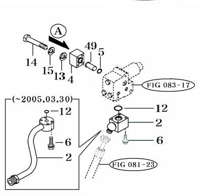

There is a second filter in the diagram for the PTO, just a 80 mesh screen (# 49 in the pic) Is that the one?
I haven't seen that NAPA #1621 listed, but looking at it on napaonline, it looks very close. Keep us posted.
Yes, the cross reference (I didn't put the list together) is for the long can filter.

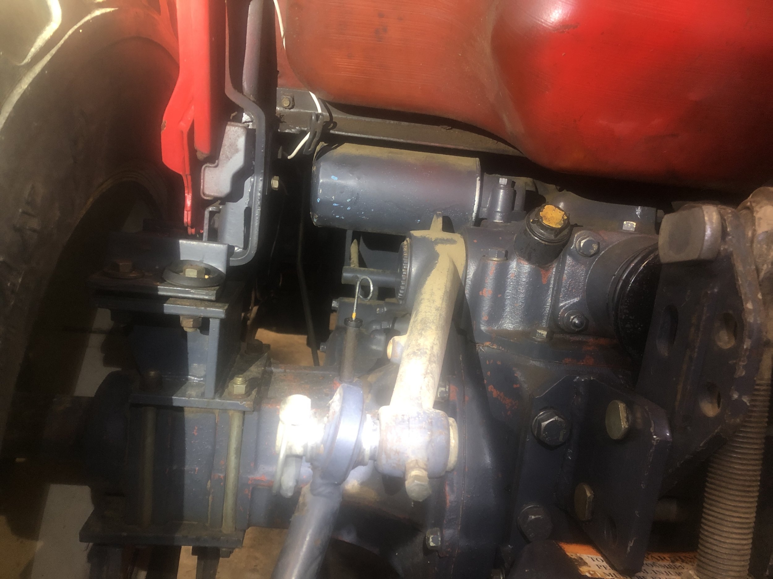

I’ve got an 02 3510 that has that filter on top of the transmission. Best I can tell it is a 15645153410 that is a left over from the old sheetmetal tractors. Billstractor says it would be on top left of transmission. Just when I thought I had changed all the filters I found your post and checked my tractor.
Next question, what fluid flow does it filter since there is another screw on filter under the floor on right side?
