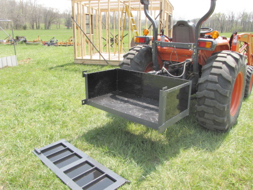

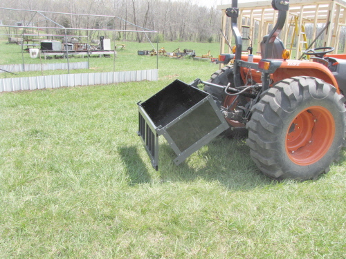

Here is mine that dumps. It's also my weight box.

Leejohn, now THAT'S a carryall:eek: Great design.
I particularly like your swing tailgate for spreading dirt.
I wondered for a minute how you get dirt into the dump carryall using the FEL.
Then, it came to me, just like flipping pancakes....
scoop with FEL, FAST curl and max bucket raise, dirt flies in a semicircle over your head and lands perfectly in the carryall. Now, all we need is such an action picture with you in in the driver's seat filling the carryall with dirt:cool::D

Yes that would be a good one... I have a B7800 also to I fill it. I have a lever on it now to unlatch the latches.
