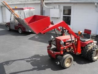

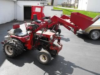

Does it look like this one that showed up on an image search?
