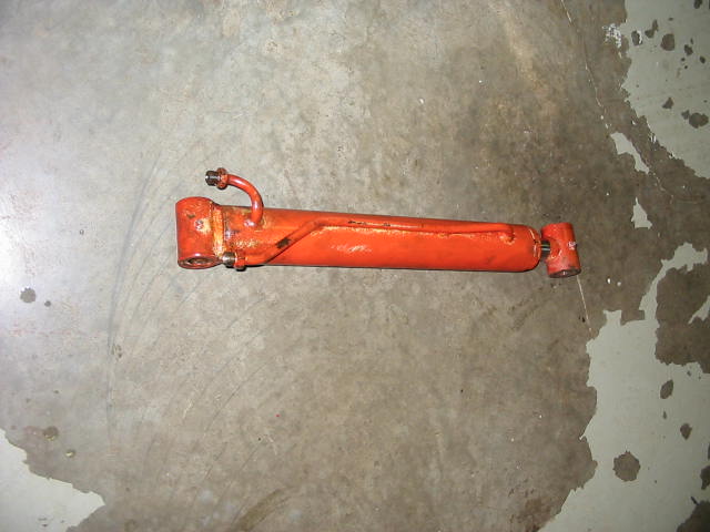

I took the cylinder off and there was no fluid in the cyclinder to drain out. Does that mean the cylinder could be air locked or some other problem. Fluid will squirt from the detached hoses when actuated. I have attached photo if that is helpful.

One other thing, when the rod in all the way in, about an inch or two of the rod sticks out of the cylinder. Is that normal, or could that indicate the rod is hitting the nut keeping if from pushing all the way in.
/ Hydraulic Cylinder Problem #16
Not normal...I bet you could pull that rod all the way out!
/ Hydraulic Cylinder Problem #17
I believe (from your picture) that it should go in to the paint line on that cylinder.

I do believe the nut has come off the bottom of the rod that secures the piston. That is why you have no movement on the cyl rod, and the reason the rod moves freely.
