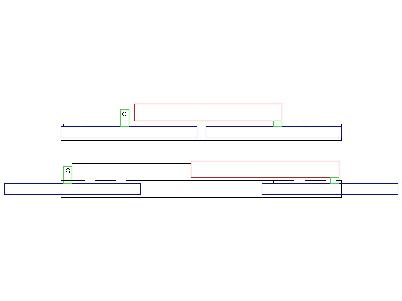

Sorry, forgot the stupid pic - BTW, sorry about the skewed perspective, did it in Paint :thumbdown:

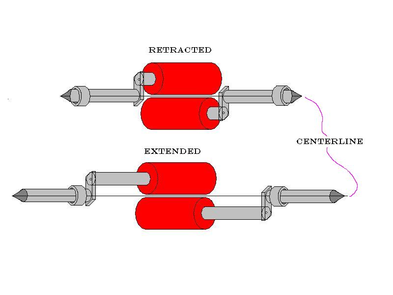

A bit of all of the ideas together has gotten me to this:
Top drawing is retracted
Bottom drawing is extended
Red is the cyl body
Blue is the pins
Black is either the rod of the cyl or the main tube that the pins would ride in
Green is a tab attaching between the pins and the cyl that would run in a slot in the main tube
10" stroke cyl providing 5" movement on each pin
Main body would be 24 3/4" long
Pins would be 12" each leaving 3/4" between at full retraction for crud buildup
To keep things as compact as possible and to lessen the leverage forces on the tabs, green tab would be welded to both the pin and the side of the body of the cyl
At the rod end of the cyl, there would be a bolt connecting between the green tab and the rod
Design would be fully greaseable
Small hurdle to overcome: crud getting between the 2 pins especially since the slots would be on top for best location of cyl for protection
/ Hydraulic controlled bucket QA? #24
I like it. For crud between the cylinders, what if you put a 1/4" hole all the way through in the middle and put either a 1/4" cotter pin or 1/4" bolt in there? Cotter pin should allow dirt to drop out, the bolt would keep it sealed, but let you remove it and blow out the space with compressed air.
If you wanted to seal the opening, you could put a pair of flex seals or door sweeps such as Amazon.com: CRL Clear "T" Type Shower Door Bottom Seal and Wipe - 36 in long: Explore similar items or M-D Building Products 69644 2-1/4-Inch by 36-Inch DB038 Heavy Duty Door Sweep with Vinyl Seal, White - Amazon.com

Just a thought because I have been batting around ideas for our JD, what if your cylinder was in line and floating with your pins. Both pins with stops on them so that it didnt matter which pin pulled out first, when it reached its stop it would pull the other pin. Same with going out, when one pin was seated it would push the other one in? Use a 10" stroke cylinder and make the pins to match the left over distance?

Sounds to me like that would work. The stop collar on the pins is the key item that would make it work.

Thanks for the input but the option wasn't explored further for me after Steve mentioning it as there just isn't enough room in my application. With Steve's 580, that would likely work well and inexpensive. I simply don't have room for pin guides with that setup. That I why I tried the off-set design which is allowing for the pins to ride over 50% in guides all the time and using all but 1/4" on each end of my main tube as stops/retainers. Even at that, a 10" travel cyl with collapsed length of 14 1/4" is going to take some custom mods to do.
