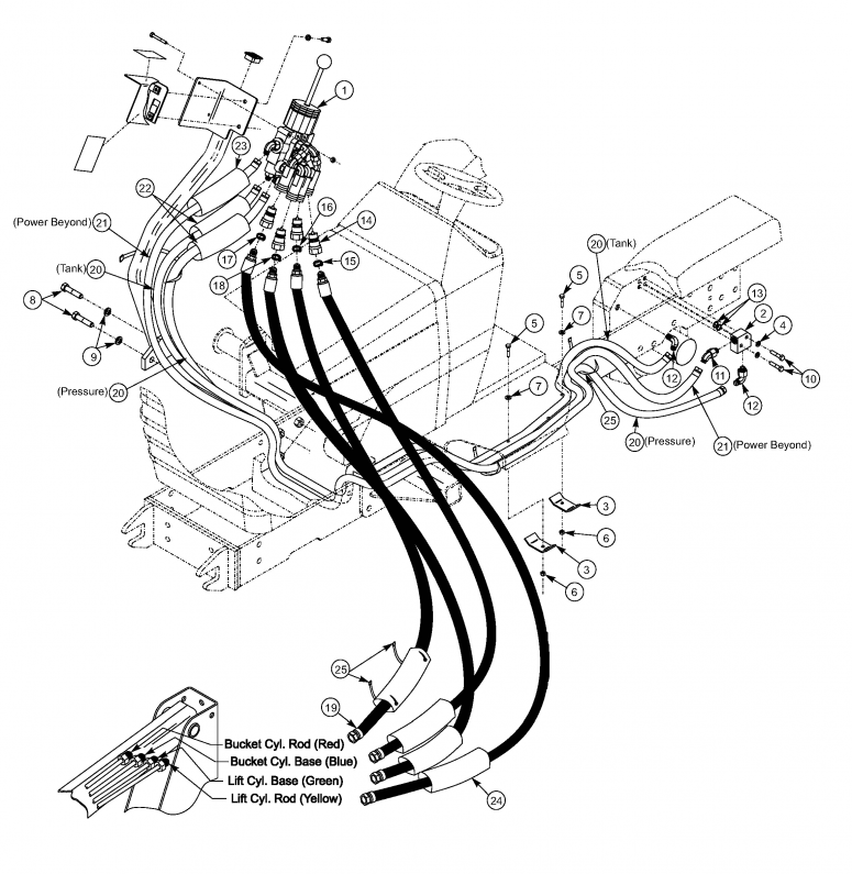

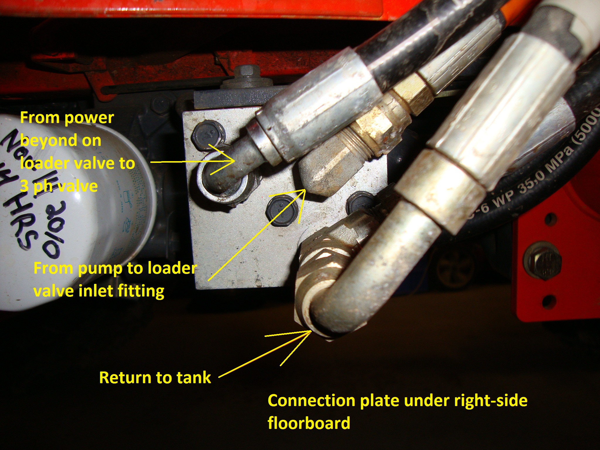

Does your hyd block not have a pressure out port and PB in port and maybe a return port like this.
Jere is the schematic for the B2330. May be similar

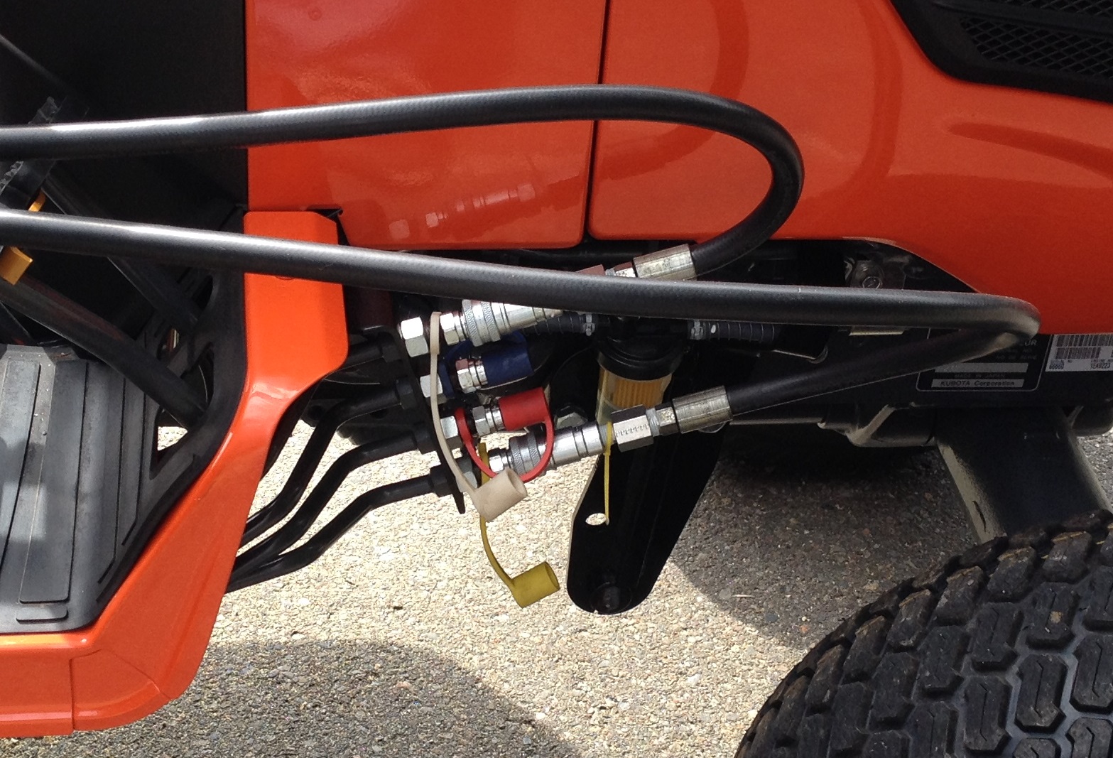

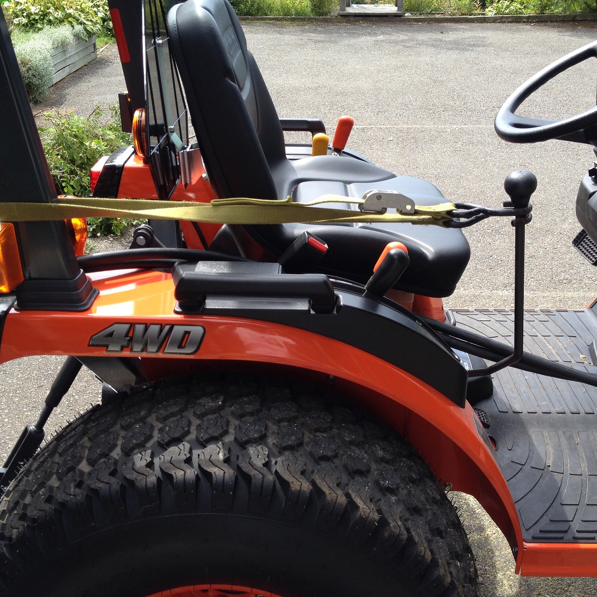

Hi JJ,
Sorry for disappearing for a month. Life got very busy. It appears that the power beyond circuit is tied up by the 3 point hitch. There is almost no room to even get a close look at the FEL valve without removing one of the rear fenders. Bear in mind that Kubota started including a FEL valve with every B2320 even if the owner did not purchase a FEL. So, not only do I have the FEL valve, I also have a set of 4 quick disconnects for FEL hoses. I was proposing (and did) tie into the quick disconnects to power my log splitter. Everything works great so far and I am pleased. I can still adjust the splitter up and down with the 3PH, although not while splitting a log. I will try to post some pictures here. The tie-down is the only part I am not proud of. I built the splitter about 20 years ago and it has performed very well over the years.
   / Hydraulic connection for log splitter on FEL circuit of B2320 #6
Thanks for posting back.
Glad you have everything working for you.
Are you using the FEL lift QD's?
Yes, I am using the FEL lift QD's, since I don't have a loader anyway it should be ok I would think. If I ever get a loader, I guess I would leave the bucket on the ground but curled up so I could still move the tractor a bit if I had to while splitting wood. In any case, since the QD's are all identical, it is a simple matter to swap my splitter to the bucket curl (dump) circuit.
If I have more time and feel braver, I may try cutting the steel line and use compression fittings like you suggested. But for now I have something that works and was very inexpensive and easy to install. Thank you for all your input JJ.
