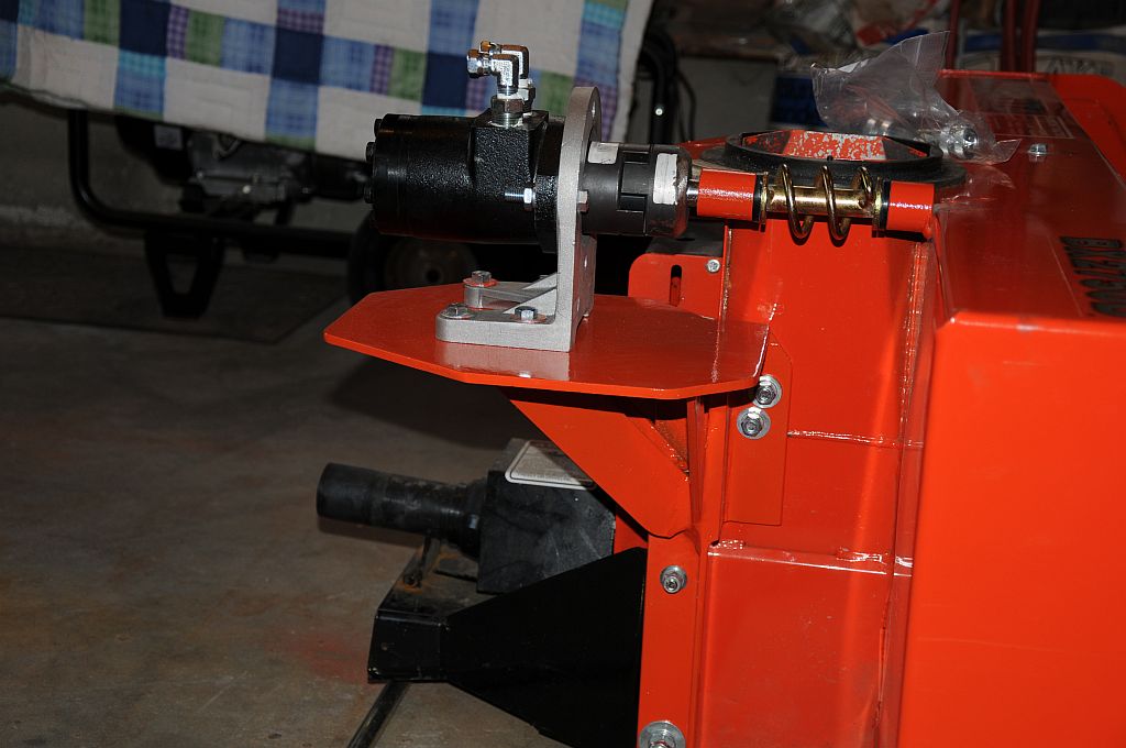

I just completed a hydraulic chute rotation system for my neighbor. The blower is a BX2750D and is front mounted on a B2620. I have a similar system on my BX1800 and BX2750. My chute will rotate right or left from the center stick position with increasing speed as I put more pressure on the stick either right or left, except when I'm rotating right the stick will hit a point where all rotation stops, so I just ease up a little and the rotation will be at the fastest speed to the right. If I had a bucket, I assume the bucket would dump at the point where my chute stops rotating? Anyway, my neighbors installation works fine to the left and can be feathered depending on stick pressure, but will not turn at all to the right until I hit that dump point and then the rotation will be at top speed with no feathering ability. I know I've read about this before on TBN, but am not finding the threads now. Is there anyway to make this rotate to the right from the center stick position...as my BX1800 allows me to do? Thanks in advance. Dyer, retired

Do a search for "regen". It sounds like your tractor has a three position valve, and your neighbors has a four position. Many of us have been through the same issue when using a four position valve to rotate our snowblower chutes. It is something I had to get used to when turning my chute to the right...... I can now go to the edge of the regen position and feather to the right fairly well. Unfortunately, the other option would be to operate the chute rotation with a seperate valve such as a rear remote.

Ductape, Thanks for the info. I've done the search and finding all the stuff I remember seeing before, but your explanation pretty much covers it. Even at full speed, the rotation is not out of control, so he's pretty happy with the installation. Unfortunately, we'll get a chance pretty quick to try it out for real. Thanks again. Dyer, retired

This wasn't a Kubota kit, but something I came up with after reading about other installations on TBN. I'll PM more pictures and a list of the parts if you'd like. The Kubota Dealer wanted $358.00 for thier hydraulic kit three years ago....and that was before labor. It's a really nice upgrade...especially on those windy nights. John

I ran into the same problem with the hydraulic rotator on the Kubota snow blower I bought this year. Ductape and KennyD straightened me out on what I was missing. There is mention of it in the FEL manual but I didn't know enough about it to understand what it was saying.
In the kit for mine two orifice fittings were included, 0.047" diameter holes drilled in them. One is installed on each side of the hydraulic motor between the motor and the hose. It still turns plenty fast with these installed but helps to make it controllable. If your kit does not include these I think it would be a useful addition. Adjustable restrictors might be even better.

I put a Needle valve on mine....adjusted it to where I wanted it, set the set-screw on it and presto...the rotation speed is PERFECT.

Pretty inexpensive solution if he finds it rotates too fast for him. We also notched the chute, so even if he passes where the old stop was, he won't rip out the worm gear. I hope people seeing this picture know that we don't turn these things 360 degrees, even though we could....it's just a precaution against destroying the gear.

Do you just use caution when you get to the point where the notching stops? Someone on here had some relief valve installed on their unit, so that when it hit the stop on the chute, it shut down before damaging the gear....don't quote me, but I think that's how it worked. I agree on the price of windows. I don't turn mine beyond the 45 degree mark, so won't get hit in the head with anything, although I'd probably wouldn't get hurt much getting hit in the head, ha!
