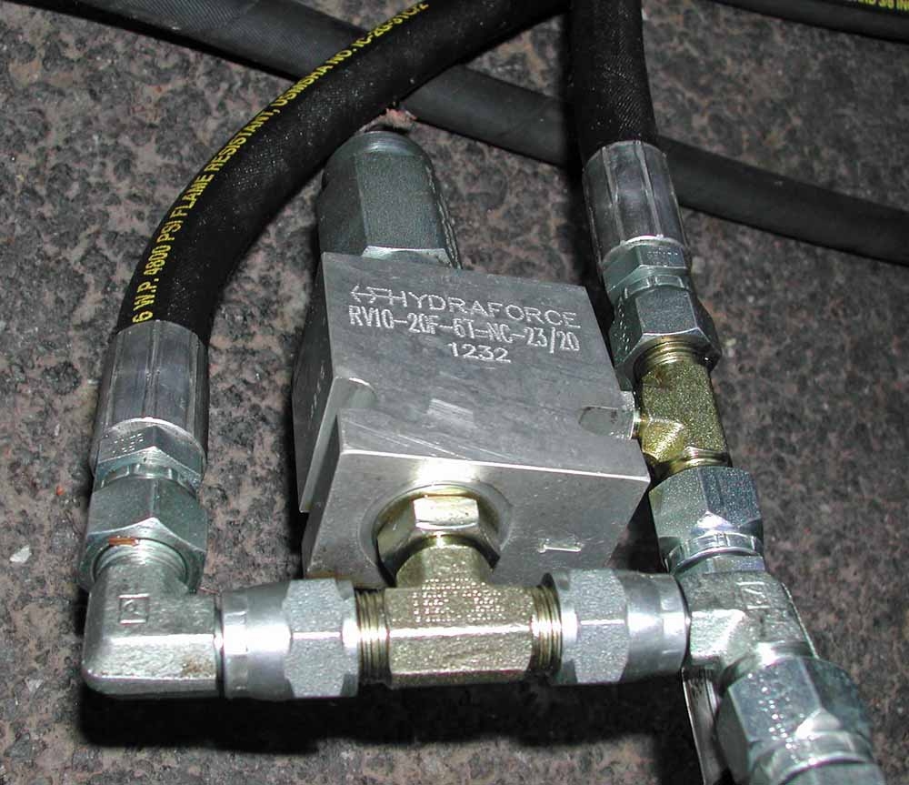

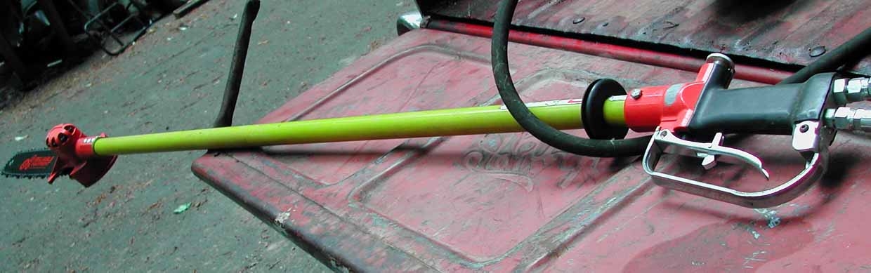

It has now been over a dozen years since I set this Reliable brand hydraulic polesaw up for a guy to operate from the seat of his tractor. He could drive around his property and trim trees without leaving his seat. I did have to add the 2000 psi cross-port RV to it, as I did with my Fairmont saw.
Since then, battery-powered polesaws have gotten better and better. So good, in fact, that I don't see any reason to go hydraulic unless you are a tree company with hydraulic power already plumbed to your manlift bucket.

I have remote hydraulics at my BH bucket, no electrical. I was thinking of making a telescopic 4-8' pole that connects with my QA and had a hydraulic saw on the end. I'd like to be able to trim branches around my fields as high as possible using the BH.
/ Hydraulic chain saw #19
That makes sense. You will need RV protection for it, and you will probably want to idle down when cutting, so you don't overdo the flow rate.
Also, long 1/4" hoses are fine for intermittent flow of 5GPM or so, but heat up the oil noticeably.
If you do this, start a thread. Sometimes you can find hydraulic chainsaws pretty cheap locally since they have a very limited market.
