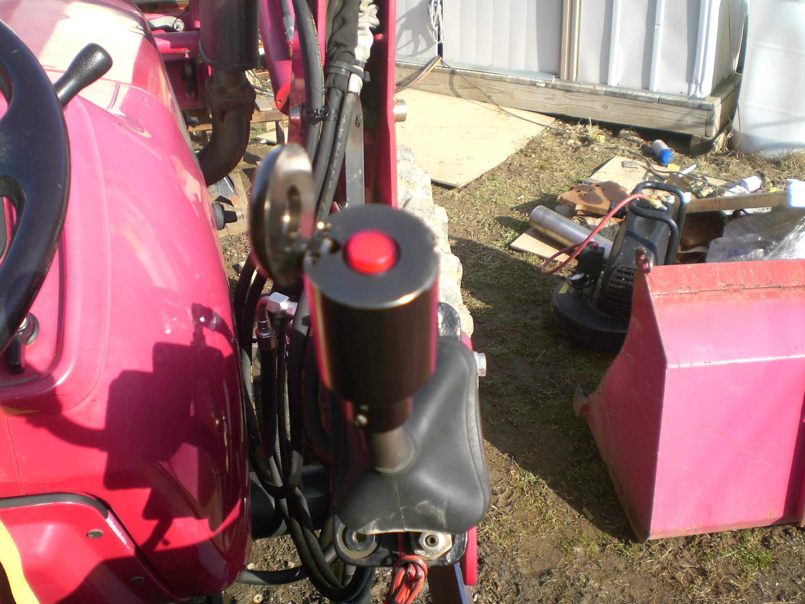

/ Hydraulic Auger Mount
#48
I finished the knob switch and wiring harness. The knob is from Custom Accessories and picked it up at O'Reilly Auto Parts for $12.99, along with 8 feet of 1/4 inch heat shrink for $5.29. I love running wires in heat shrink, as it makes a nice black harness installation. The switch is from here.... Mini SPST 1.5-Amp Momentary Pushbutton Switch (2-Pack) - RadioShack.com and cost $3.19 for two switches. For a total of $21.47, not counting the wire I already had.
I had to counterbore the top of the knob for the switch, as the top is over .6 of an inch thick. Which makes the switch tuck nicely inside the top.
hugs, Brandi

/ Hydraulic Auger Mount #49
The switch looks good, nice job.
I did find the switch I used, I bought mine on amazon though.... I have never delt with this company. about the same price, I think I paid $23
Autoplicity.com. Pilot Automotive PM2109S SHIFT KNOB W/SWITCH SLR - PM2109S
Just a heads up on that valve. I could not use 90* -8 fittings, they hit each other when trying to put them next to each other. I ended up useing one -8 SAE to JIC 90* and one -8 SAE to JIC 45* fitting and used a 90* hose end on that hose. You can see them in the second and third pic.
Maybe you will have more room??
I dont ever use the right side to get on and off tractor, so mounting the way I did wasnt a problem for me. It actually made the loader valve more comfortable to use, no more reaching. I would have like to put it where you are planning, it would be tucked out of the way nicely.
Brian

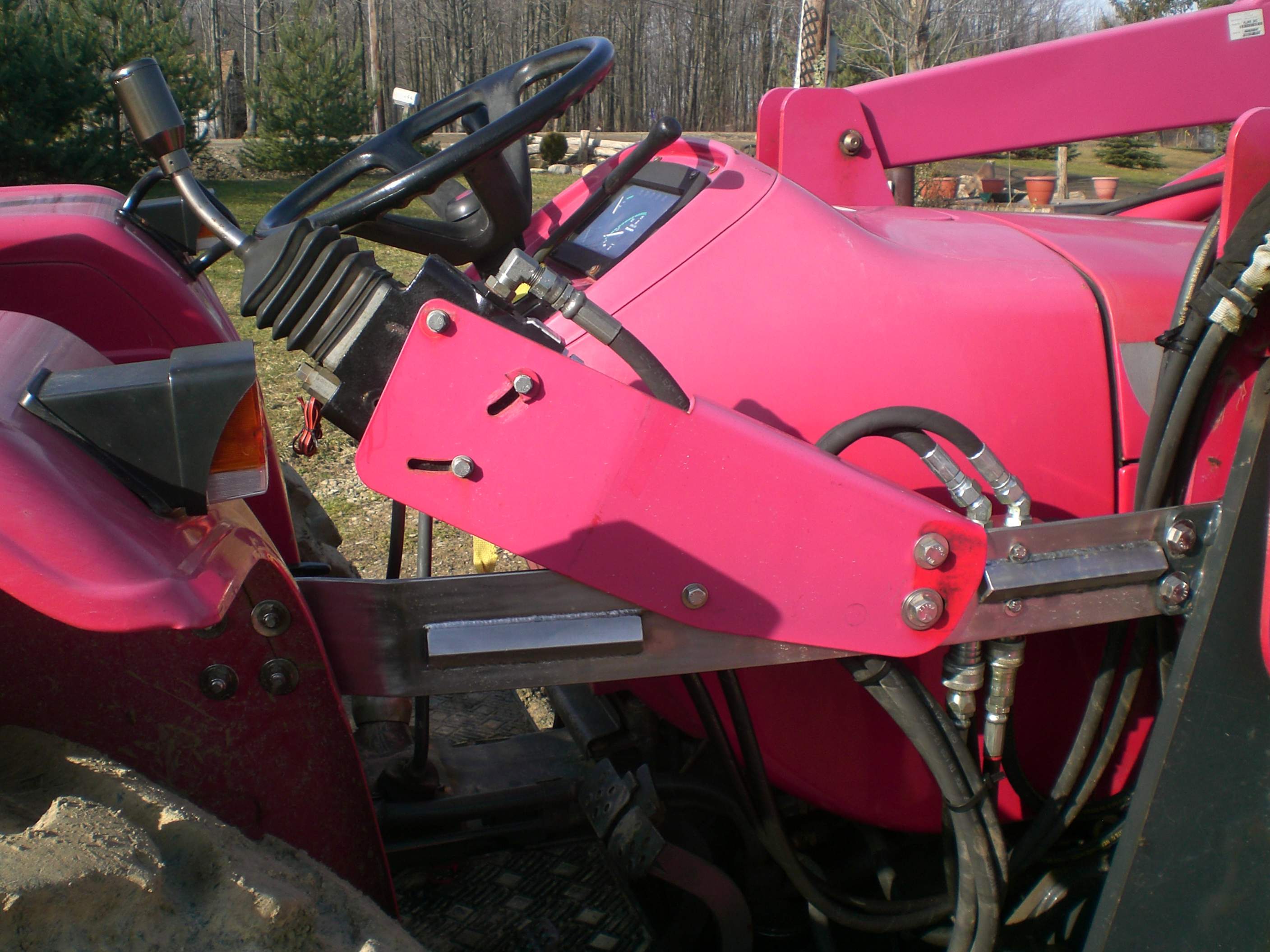

/ Hydraulic Auger Mount #53
bindian
When i was searching for The "right" Hyd. fittings for a compact set up for my do3 dual sol.valves Discount Hyd hose was a great sorce as they had a selection of fittings that really help me.Especially the long sae#8x 90*x jic and a short one that really helped in making a very compact set up.
ak9
/ Hydraulic Auger Mount #54
bindian
ak9
Viola
#55
bindian
ak9
Thanks AK9. These guys..... SAE 37° Flare (JIC) x O-Ring Boss (ORB) 90° Elbow have more of a selection and are cheaper than Surplus Center. Since I am going to buy my bulk lines and reuseable fittings from them, I will get my valve fittings from them also.
I already decided to go long and short 90s. The long one may rub the engine side cowling, but I have the tools to relieve any rubbing and make an opening and cover the opening from the inside if needed.
hugs, Brnadi

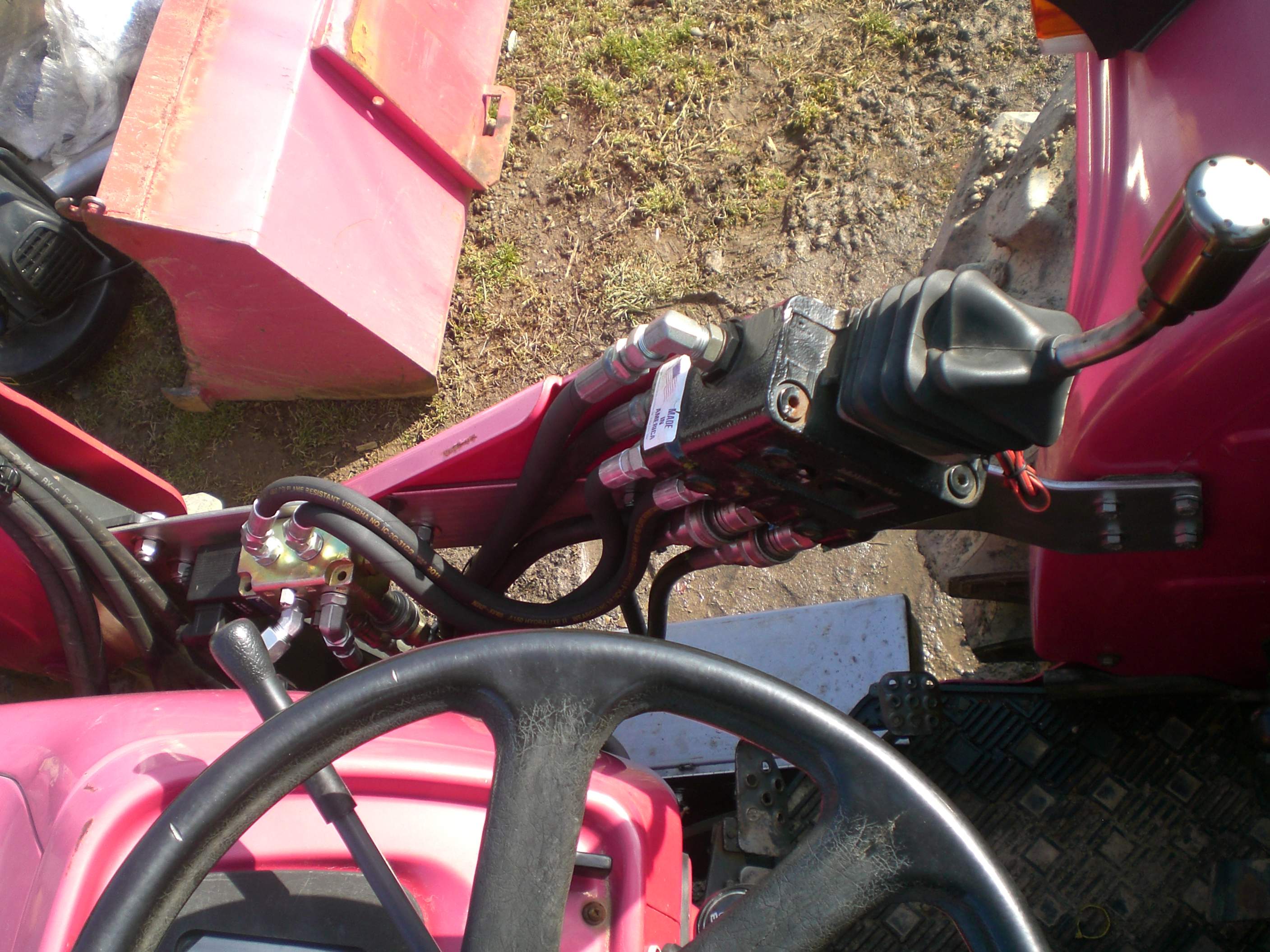

/ Hydraulic Auger Mount #57
bindian
Here are a few pics of my Hyd valve set up i made . I chose this location because it is was as close to the loader valve as I could get it and was easy to pass the Hyd lines to the front. I really liked the way the long and short 90* fittings nested in tight to the tractor and The PB & tank lines were easy to run in this location.
ak9
#58
bindian
ak9
Thanks for the input and photos. I have plenty of room forward of my loader valve on the mast. So that is where I bolted the valve. I have plenty of clearance, even hood clearance. The knob switch is all finished and the wiring harness ready to install. I extended the threads on the shaft for a jam nut.
Just ordered fifty something dollars of SAE fittings for the valve installation. I ordered extra of different fittings to make sure I have what I want when I move lines.
Oh yeah, the white thing on the valve is a rubber glove I used to keep metal shavings out while marking holes. The blue fittings are aluminum AN fittings and caps, which are the Army Navy version of JIC. Those are there just to keep metal shavings out also.
hugs, Brandi
