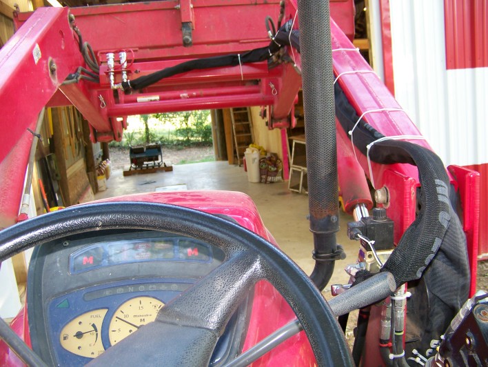

Brandi, beautiful work as usual - only suggestion I might make is about the white Ty-wraps. I've used tons of Ty-wraps in industrial settings over the past 35 years, and the ONLY ones I found to last more than maybe a year outside, were the Panduit heavy BLACK ones - all the others don't seem to have enough UV resistance to hold up in direct sun.
(Not that you'd ever get direct sun in Texas) :laughing:
I use a lot of the re-usable fittings I saw in your pics, and love 'em - I find it's more sensible to attach ONE end, run the hose where it needs to go, mark the hose and THEN cut it and attach the other end. I've never gotten an EXACT length using the "garden hose" trick, every hose has a different flex characteristic.

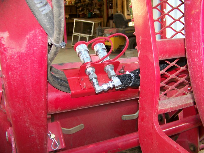

I first mounted the valve. Then I ran electrical. Then mfg. QD mount and installed it on the hose cover on the crosstube. Then I hooked up the lines and figured out fitting styles and locations. You can hang the grapple to see where the grapple lines reach and are out of the way to figure out where the QDs are to be installed.
I did not use power beyond. I ran the dump/curl hoses from the (joystick) loader valve to the diverter valve. Then ran the dump/curl lines from the diverter valve to the dump/curl cylinders. The grapple open/close lines were ran from the diverter valve to the QDs I installed on the loader's crosstube line cover. View attachment 438341View attachment 438342View attachment 438343

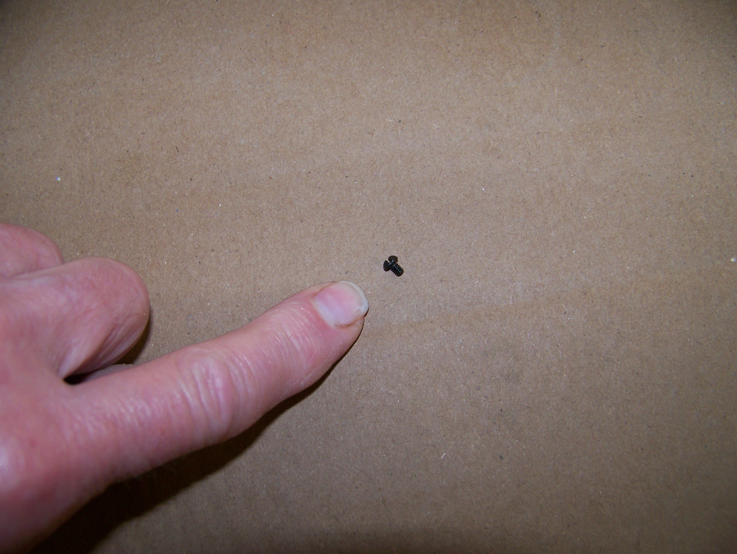

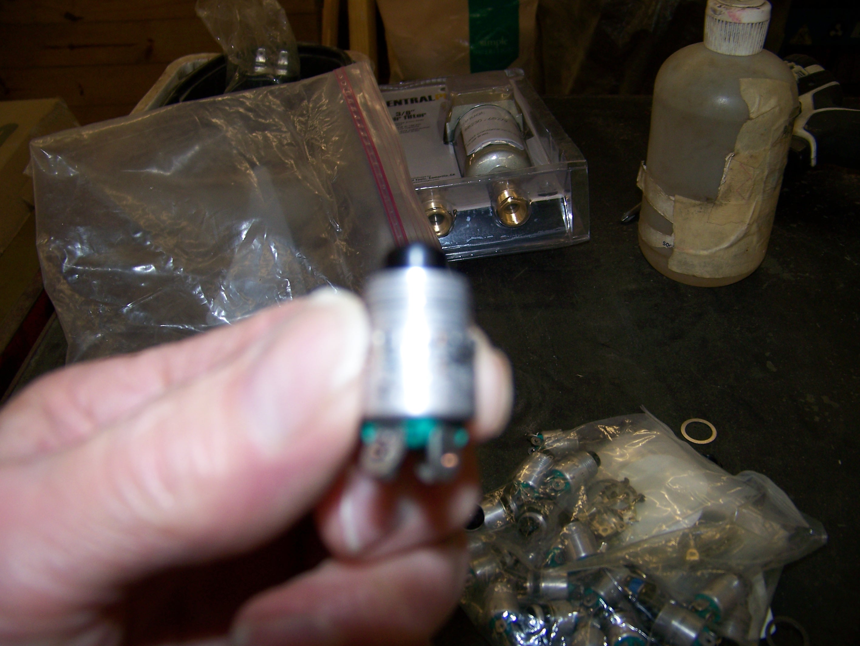

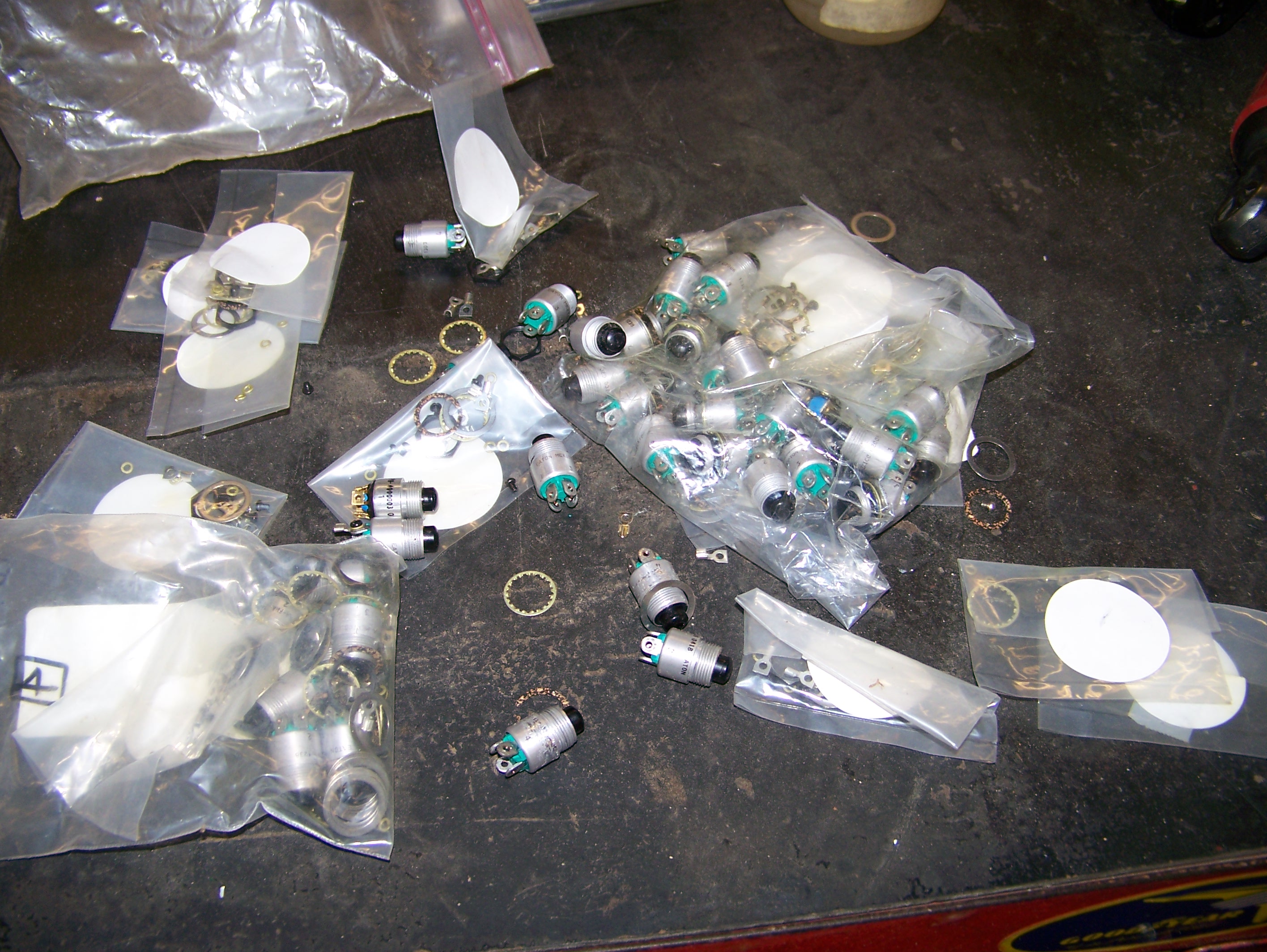

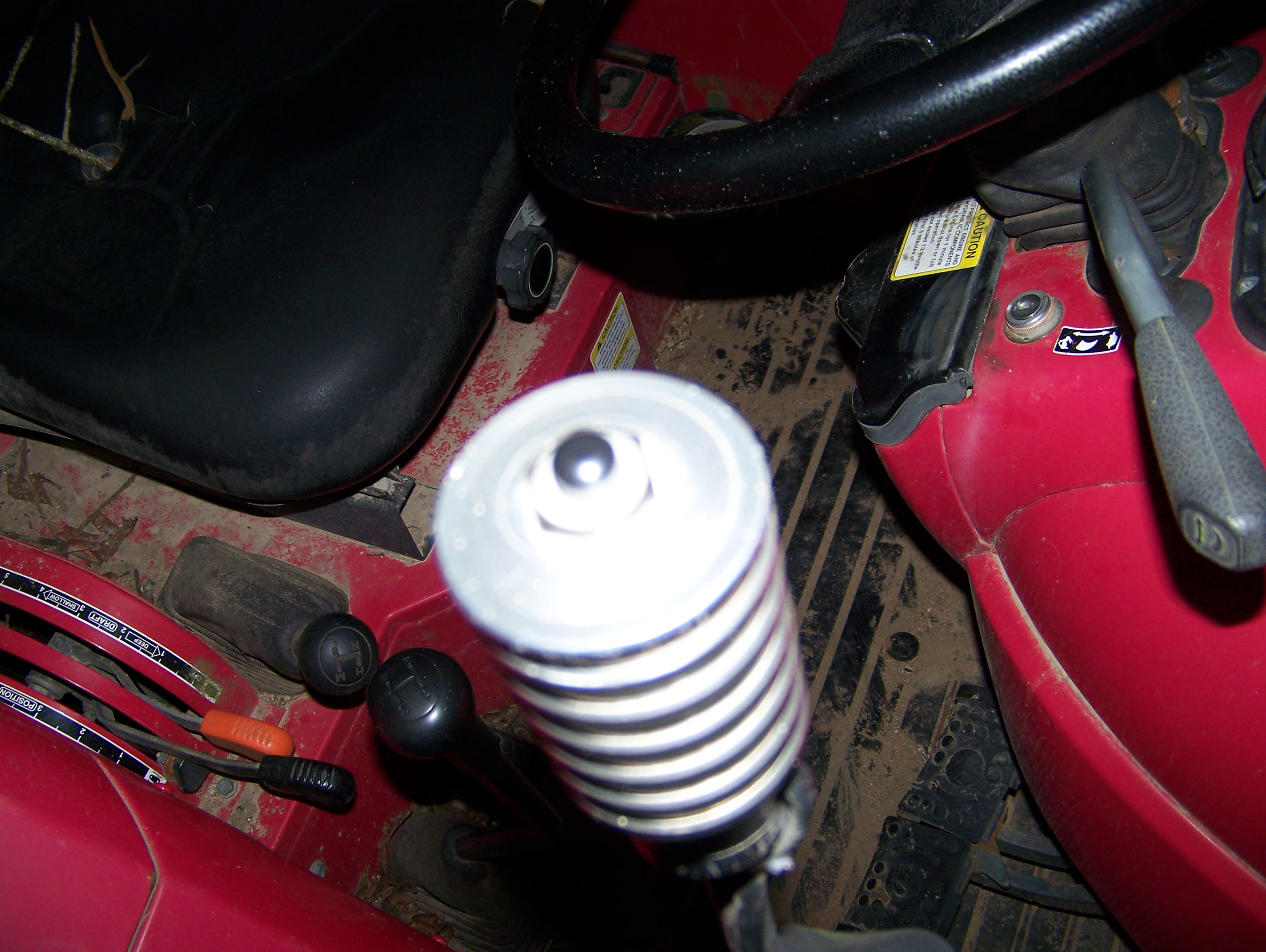

Over the years, the Radio Shack switches in the joystick just didn't hold up to joystick abuse. Years ago, Southwest Airlines upgraded they cockpit yoke radio switches. I told the guy doing the replacements I wanted all the old switches and hardware. This how many I have.
The joystick knob is big enough to house them, as it is a large switch.
The wires are crimped with soldered terminals, then screwed to the switch with these screws.
I use these 2.5 magnification glasses while crimping and soldering and installing the screws.
Makes the job a whole lot easier with the cheaters. If anyone wants a couple of the switches, let me know. I've got way more than I will ever need.
