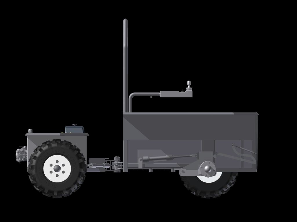

I'm designing a machine that has a hydraulic lowering system, I was thinking about incorporating some sort of accumulator system to absorb some of the shock when the machine is being driven.
I was looking for someone who might have done something like this before, and might have some advice.
I don't really want to go to an air system, because the machine is going to be completely hydraulic. And I don't really want to start mix-and-match systems.

If you don't want "air" type system then you will have to go with some form of spring loaded or other mechanical device since hydraulic accumulators are pre-charged with nitrogen.
These can be tricky to design or incorporate and usually require special plumbing and considerations for safety lock outs / bleed downs.

The job of an accumulator is to store energy or absorb shock loads AT WORK
and to reduce pulsation therefore dampening the pressure spike to a manageable pressure.
If you are designing an articulating steering system you need a cushion valve in the steering circuit.
A far as the need to install an accumulator to do what you are describing it can be done BUT its a waste of money as the accumulator will increase the amount of bounce if it is installed in a double acting hydraulic system.

Is the intent to store energy or dampen surge pressures? Either way with an accumulator you will be storing some energy. If you choose a very small accumulator precharged to system working pressure it would dampen w/o storing much energy. Cood be good for what you want. You could bias the in/out flow rate with a custom check valve to improve system properties.

Is this for ride control? If yes, several companies are already using this concept for construction and ag equipment. Most of them have a solenoid operated valve so you can choose when to use this feature and when you want to lock it out.
Any idea on what pressure you are going to be working with? Reason I ask is that I think there are some regulations on hydraulic pressure allowed next to people in an enclosed or restrained environment.

Yes it is for ride control, I want to make it a little bit smoother, could you give me an example of a company that is using this. I would like to see what exactly they're using. The PSI will be fairly low, probably below 1500.

John Deere has a Hydraulic front axle suspension system on some of their tractors. They call it Triple-Link-Suspension (TLS) 6030 & 7030 series have availible. Uses hydraulic cylinders and accumulators (3)
John Deere also has a loader suspension system (LSS). It uses an accumulator with an valve to shut off system teed into the line to the loader lift cylinders. Lift side of the cylinders.

There is no compressor required, you just precharge the accumulator with air/nitrogen and unless there is a leak, there is no loss of pneumatic pressure.

Very interesting! I think youll need to use a small accumulator for each wheel to in effect make a tunable spring damper system. They are a bit more expensive than I thot but McMcarr is not the cheap supplier. May not have to go with the top pick bladder style.
