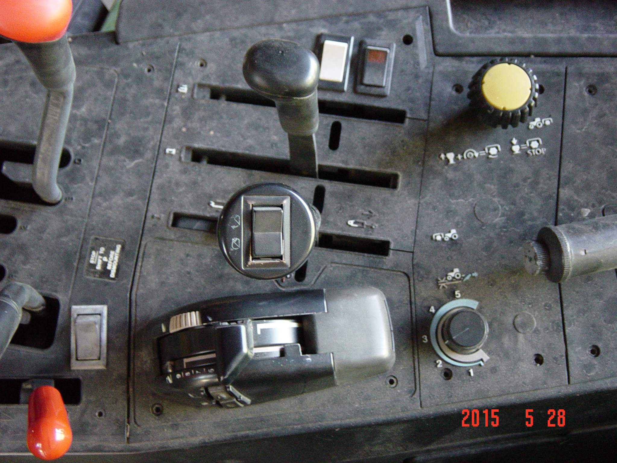

Is it possible that only the first SCV on a JD 6200 Tractor has float? I wanted to float the Harley, but found that I apparenty could not. There was apparently no detent on the second valve. I can't use the first, because I have a toggle switch atop that lever to control the electro-hydraulic valve on the Harley.
   / Hydraulic 3PH Links. Confused. #16
If your valve is a loader valve, then you probably have float.
What has the switch got to do with float. They are two separate functions.
You can also add float to a cyl .
Is the Harley on the front or back?

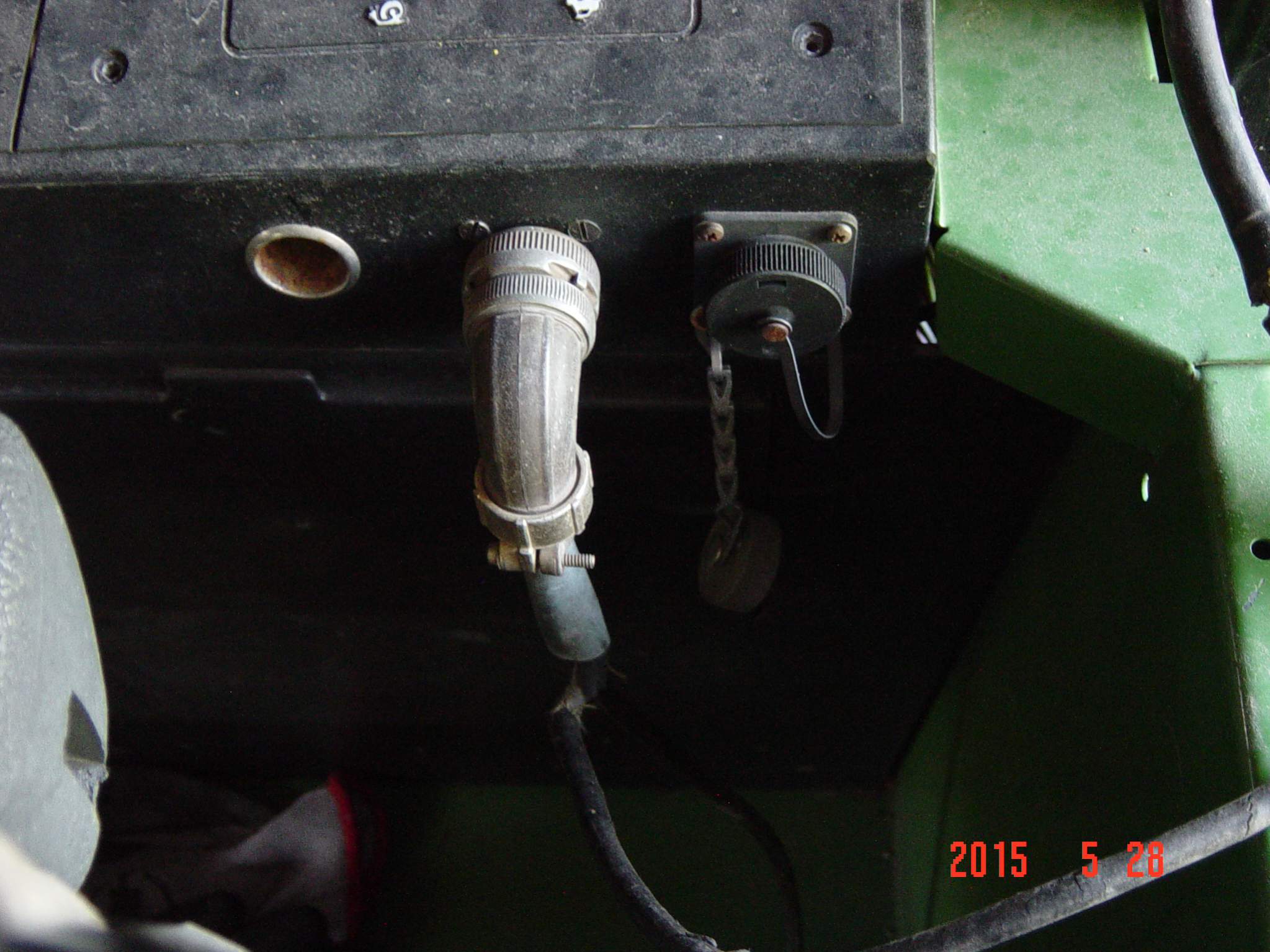

I am still having computer problems.
I spoke with the Service Manager at our selling dealer. I was very impressed that he knew immediately what I was talking about. Apparently it is not uncommon to not have float on addition SCVs.
Since I have a loader two SCVs and an electic valve spool for the loader grapple, I am out of stacking locations on the valve. Another SCV (with float) could have run 2Gs anyway, so that was not an option.
So, I thought my goose was cooked. BUT, what I will do, is merely change the control cables going to the valves, so my second lever has first valve with the float.

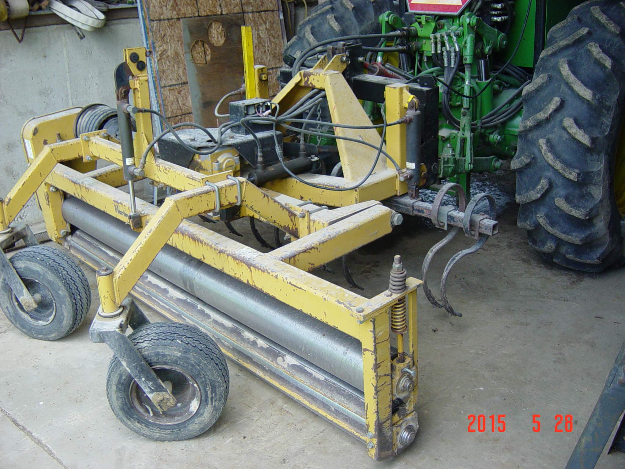

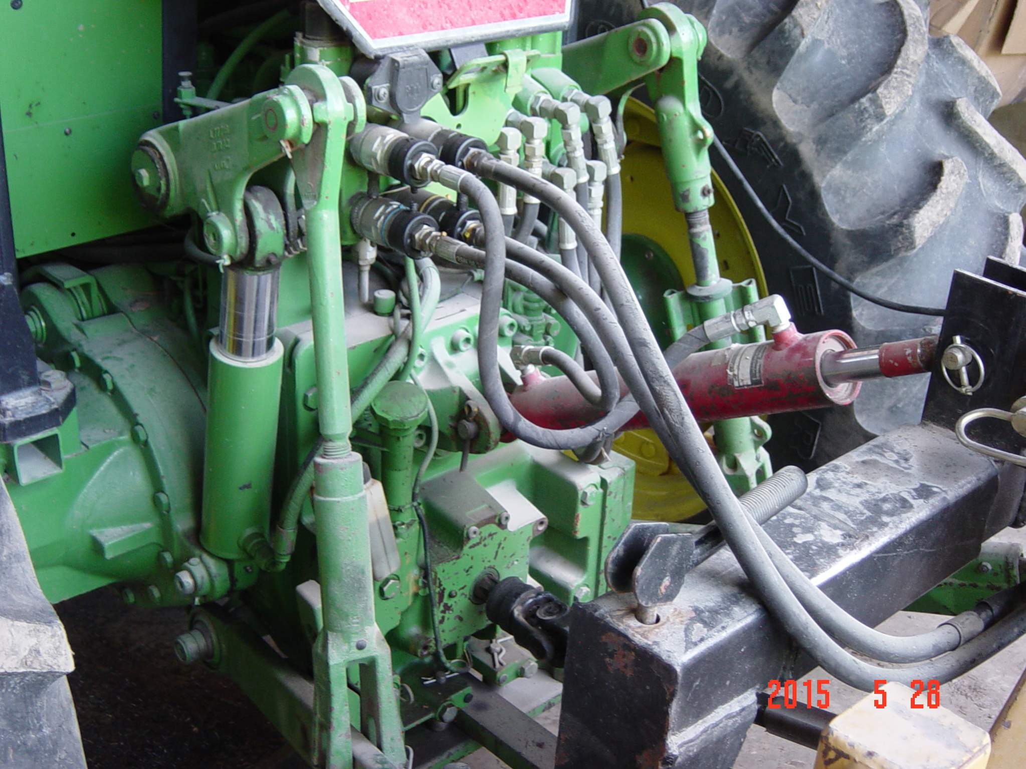

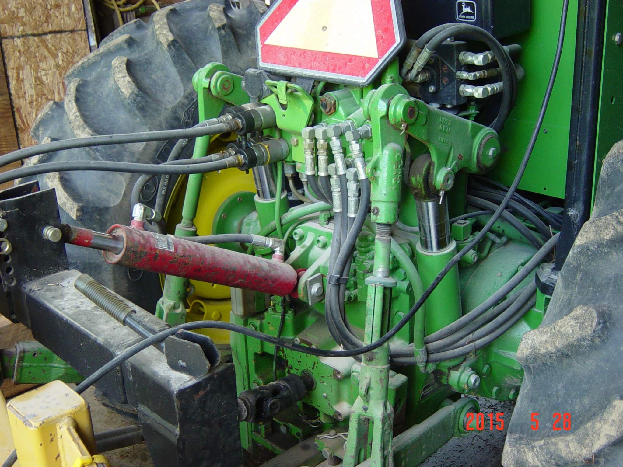

As far as what the switch has to do with float. As you can see in the pictures, I rigged up another loader style joystick handle on my SCV. Took some machining and clever work, but it runs a couple of relays and goes out to the receptacle into which I plug in my Harley three way valve. I never did get the control box with the harley, but with a hundred things happening at once when you are using this, this arrangement is really slick!
It is also a really good reason, to never be able to lend out the rake.
So I guess it takes me back to my original question. What to do if I want float but want that top link cylinder not to move on its own.
That, and how can I tilt this rake?
