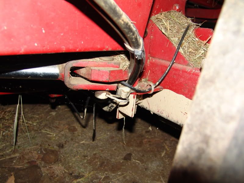

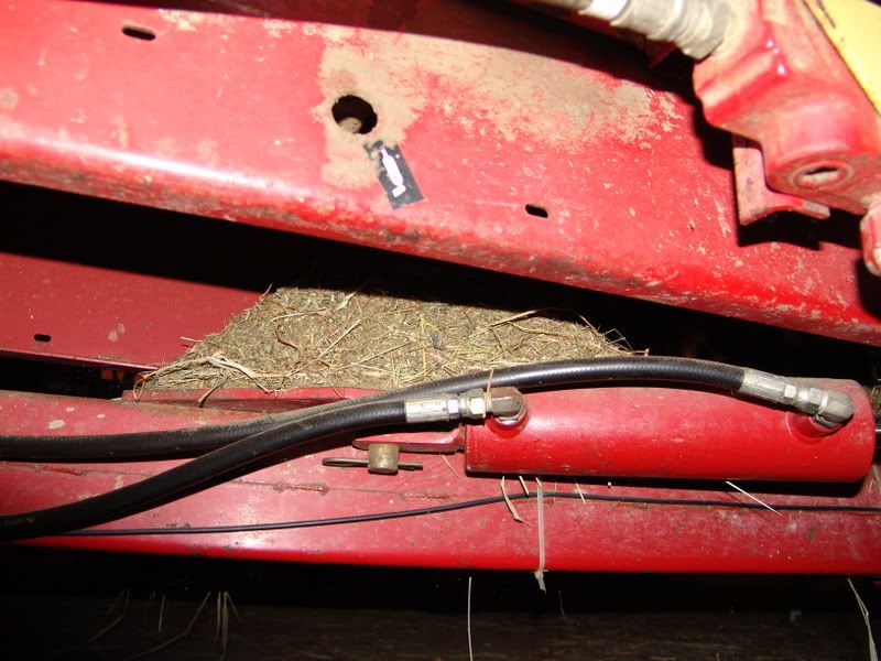

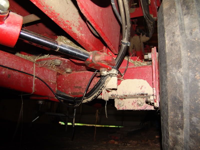

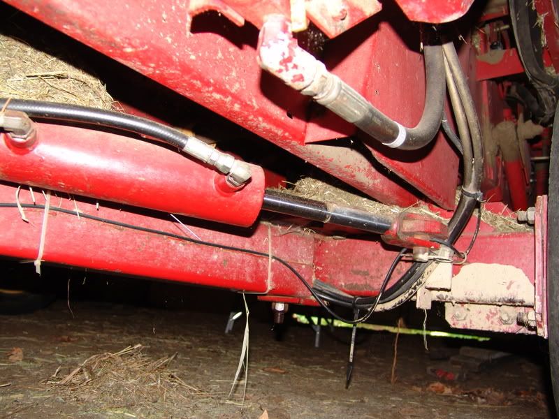

Well, if you can make anything out in these pics then good but this is the hydraulic setup on my 575

   / hyd. tongue swing for NH575/326 balers
Yup, I can, thanx!
