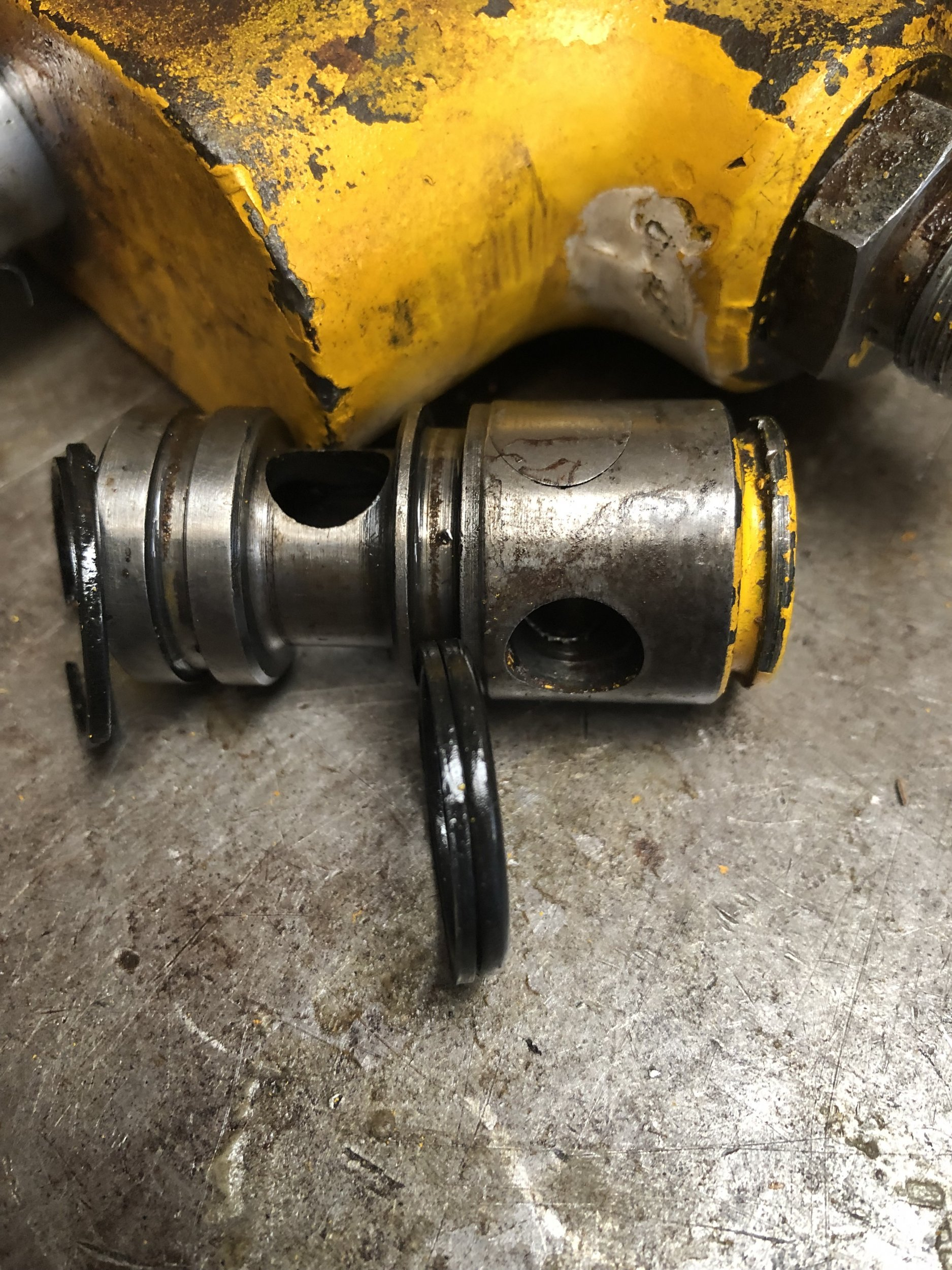

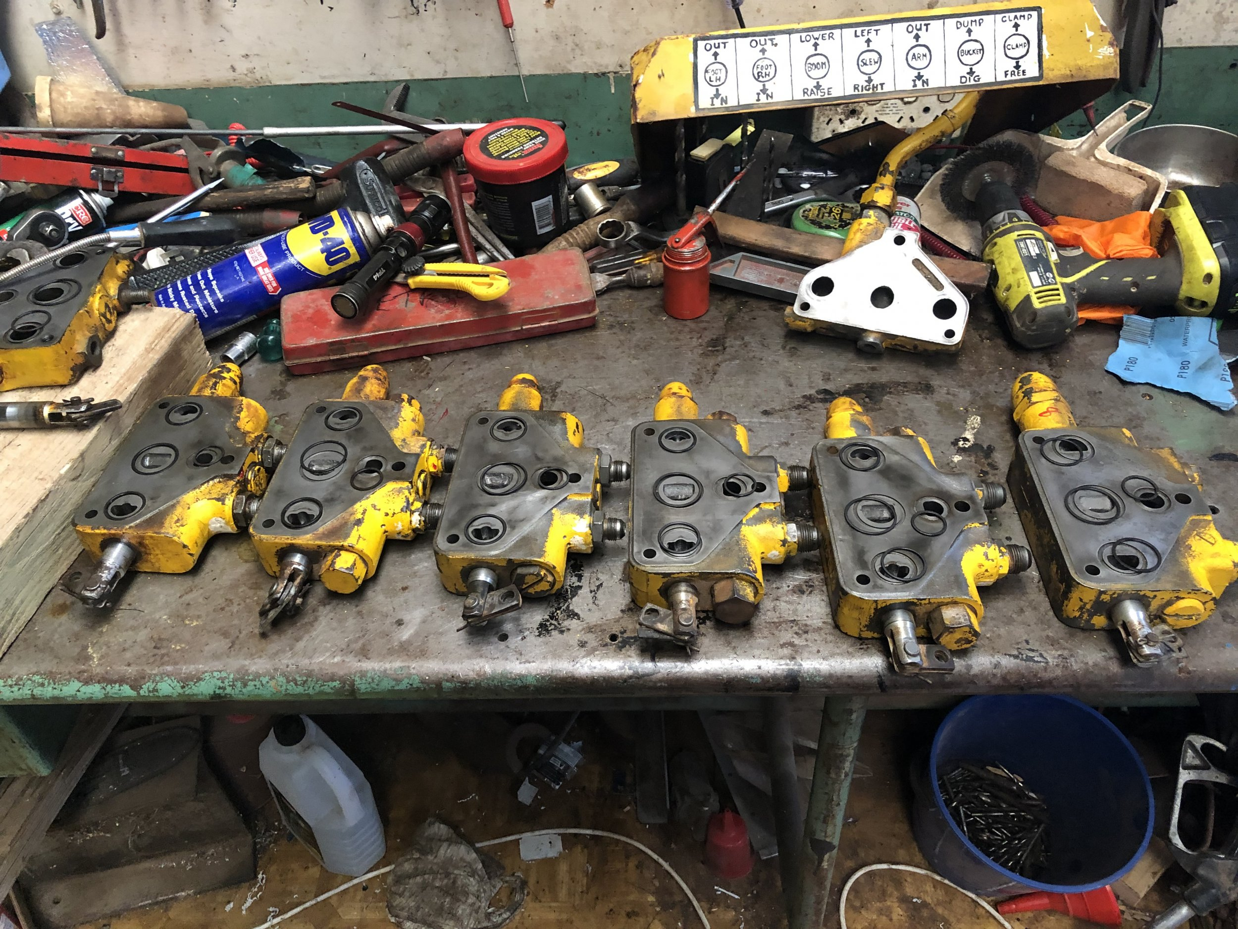

Hi i h
ave a massey fergason 50A backhoe and i am after seals for 7 lever hyd valve body Thanks in advance Ted

   / hyd seals for 7 lever hyd body assembly #2
Hard to tell for sure but they look like o-rings. Just measure ID and Cross-section and look them up and order them. Much lower cost than a seal kit.
Hi creamer thanks for reply i live in australia and i have gone to dozens of seal and oring places the problem is they dont carry these types of o ring because they are a square o ring and they tell me normal o rings wont do the job Does anyone over there sell a kit for it Cheers Ted
   / hyd seals for 7 lever hyd body assembly #4
Did you try google for quad o rings?...

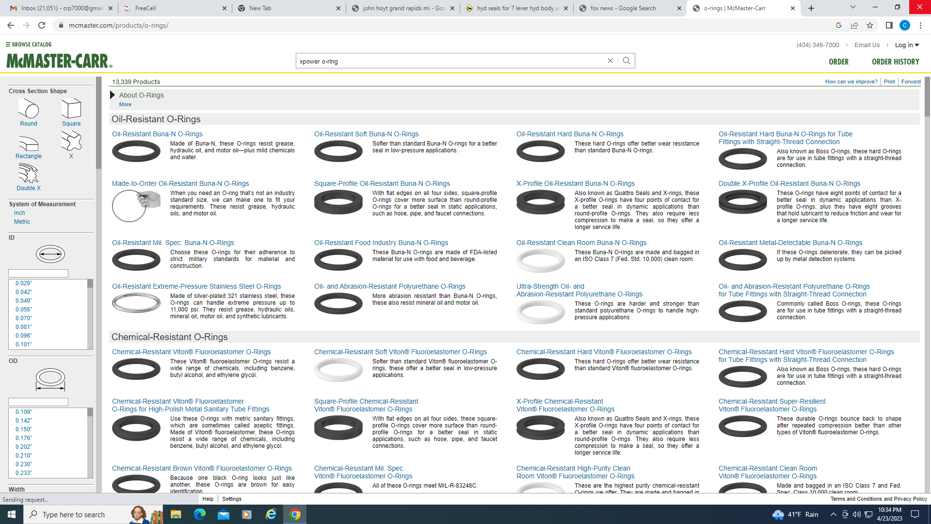

   / hyd seals for 7 lever hyd body assembly #5
In the US McMasterCarr sells these "Xpower" o-rings as you can see in the upper left portion of the screen shot below. These are normally used for seals where shafts are sliding such as hydraulic cylinders. I am not sure how your valve setup works but I would use these o-rings made from buna rubber for the oil application that you have. The durometer is what you will have to decide when you order - I would not go less than 75 durometer for a high pressure application like this.
