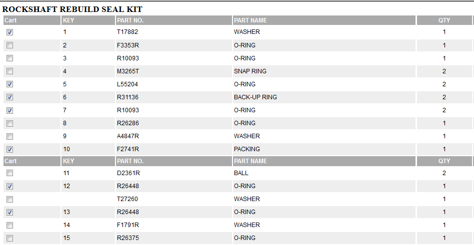

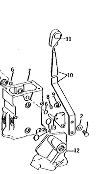

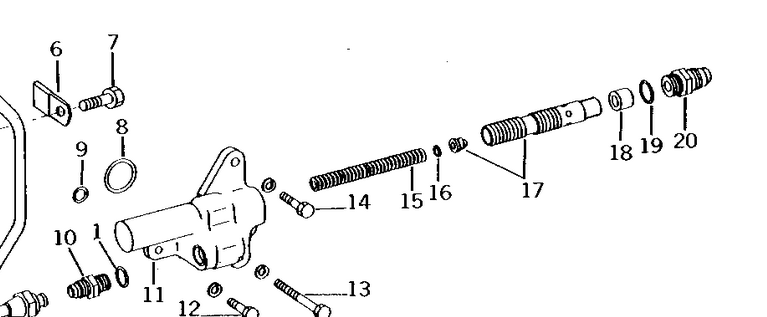

Remove rs and replace o-rings and back-up rings. Replace and do settings !
Its funny u would think there would be some type of o ring kit for this but when i went to JD place they showed me diagram and said they would have to go though the parts list and get items. By the way a good gage is expensive so is it worth spending the money if only use a few times.
Thanks for replys
/ hyd problem on jd2030 #35
A hyd gauge to help diagnose problems will save you money on parts. Yes a few yrs back JD had a RS valve overhaul kit but now one has to look up each individual parts.

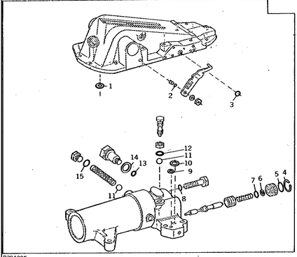

Thanks for the thumbnails.the gages i was looking at wasn't that cheap. this looks like a decent oil filled gage. I'll get one and try. First chance i get I'll check pressure before i get into RS housing and then go from there.

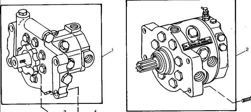

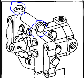

Got my gage in today to check pressure. U said to hook it up on front of pump. I don't see a place to hook up. There's the inlet and outlet flare fittings and then the flare fitting on the right side thats going to the pressure control valve. there is a small flare fitting on the left side between the mounting bolts. I hooked it up there and got no pressure at all.
DLTTrekkers, I took out the small fittings under gears but cant find a way to hook my gage in it, my gage threads is to large for it.
/ hyd problem on jd2030 #38
Which pump does your tractor have?

/ hyd problem on jd2030 #40
IIRC one can test pressure at either orifice outlined inblue
