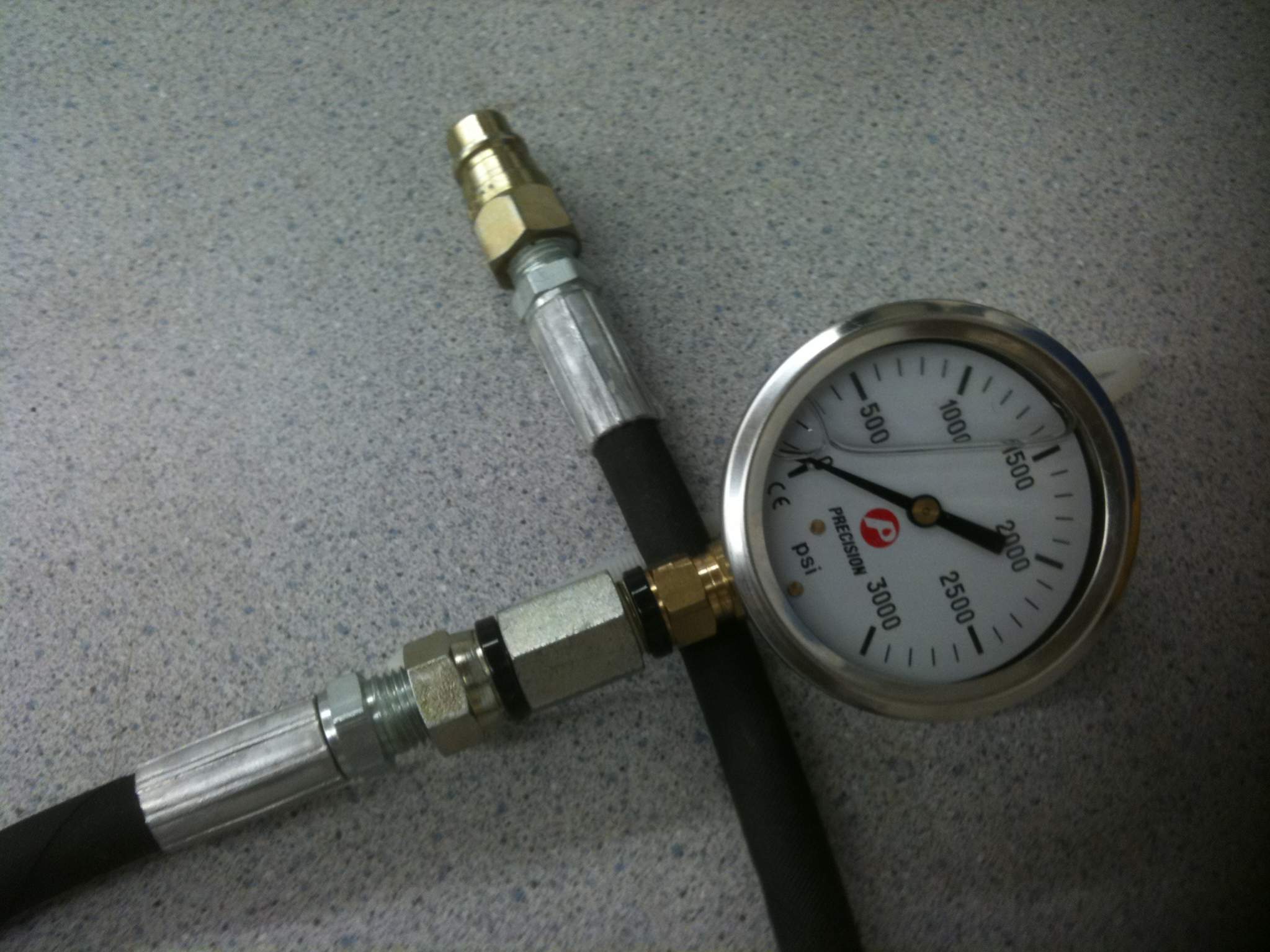

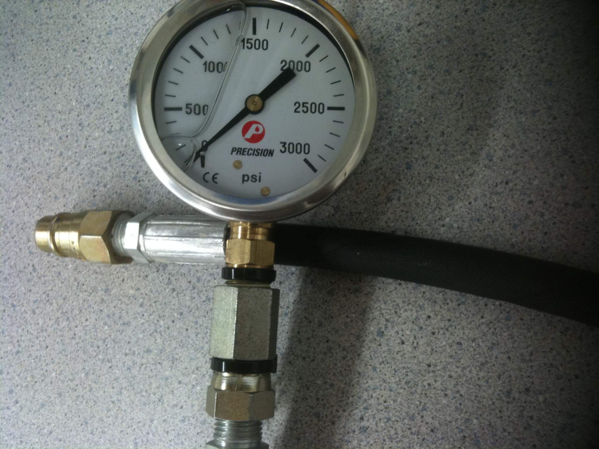

I dont think you need to Tee it in and mount it permanently, get a short (24") hose, a coupler and a QD nipple and just test it occasionally.
Here is mine:
And a short video I made:

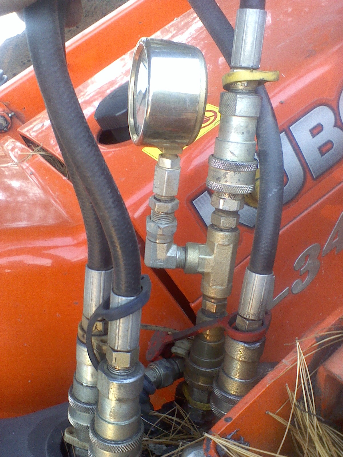

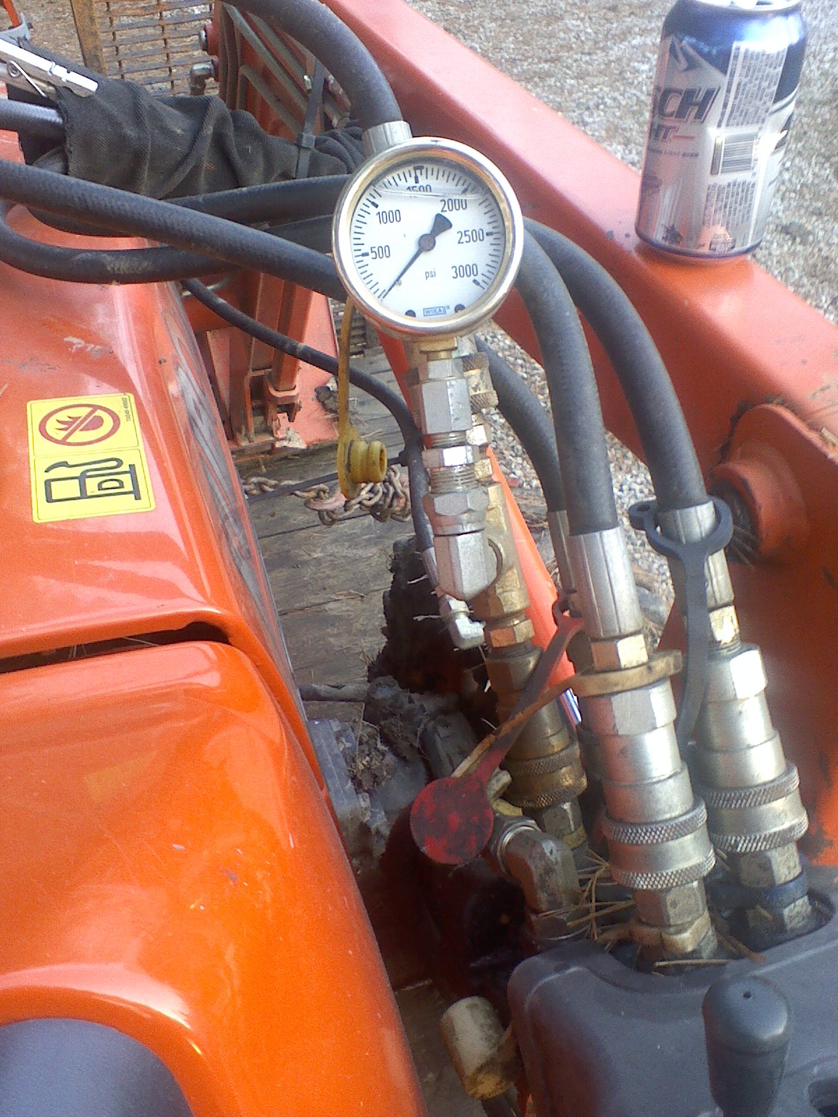

That's what I did several years ago before & after installing a shim kit in a JD 790 with 419 loader.
Then when I went to a Kubota B3030/LA403 I had to change couplers. Now that tractor is gone and I've got a Bobcat skid steer with big flat faced couplers. Looks like I'll have to switch up again.
Below is a photo. Not shown is the hydraulic hose between gauge and coupler.
