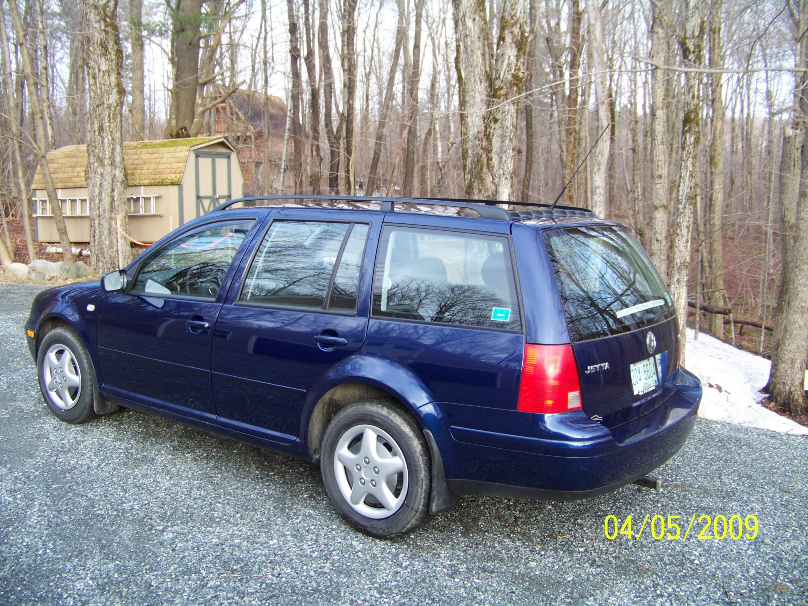

I hear tell that those crazy nuts at MIT took a Prius, and replaced the gas engine with a small diesel and pushed the MPG up over 70...
Seems a little silly when you consider that the newer Jetta TDI's get nearly that on a straight diesel/mechanical drivetrain.
I might go for a Diesel/Electric Hybrid, but until they are available if I want to get high (40-50 MPG), I will copy my dad who has a '03 Jetta TDI that gets 45-50 MPG and sacrifices nothing in comfort. His neighbor has a prius (early, but I cant remember the year) which has ~180k miles of "country" driving on it, he has replaced the 12v battery (funky shaped expensive battery) a wheel bearing and a set of brake pads (pads were replaced at ~170k miles). It has been in for a couple of recalls, but he has been very impressed with the lack of maintainance. His other car is a '81 Diesel VW Pickup truck.
I should have worded my statement a bit different. :D If one is driving mostly/mainly on the highway I don't see how paying extra for a hybrid vs a similar econo car make money sense. In the city I would think that the hybrid make money sense.
I agree, for a while my dad was driving from NJ to upstate NY every week (when gas was $4/gal), that is the Jetta really paid for itself (as compared to the 25mpg '98 Volvo V70 that he was driving before)
