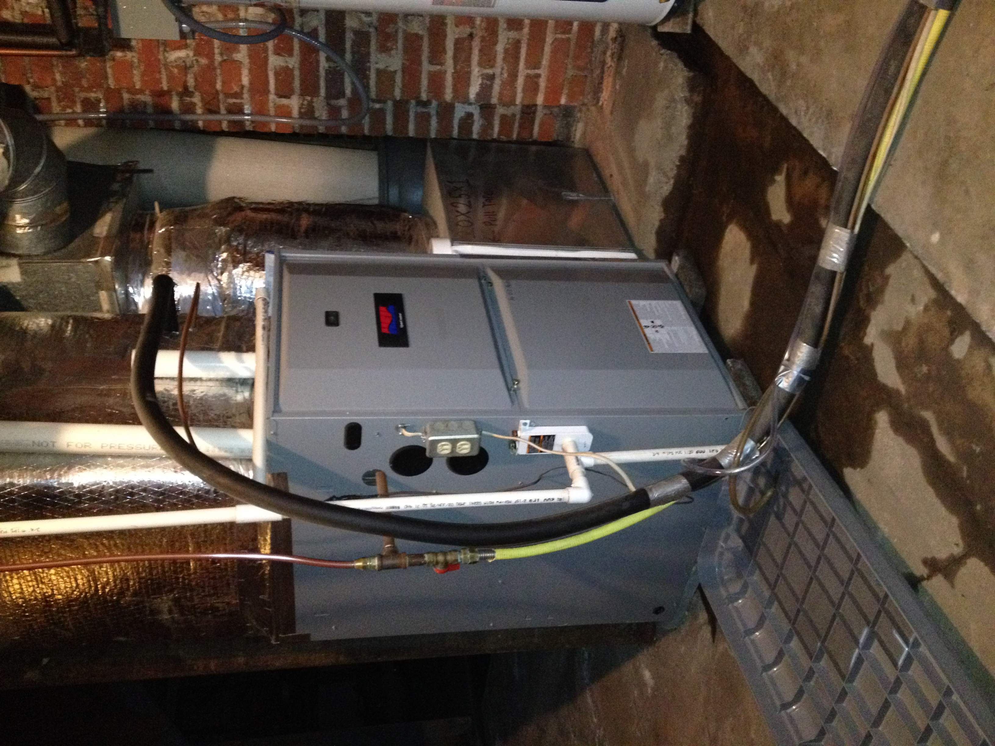

All I know is that the unit sits in the basement and that the furnace part runs on natural gas. There is a fan unit outside. It produces condensate in the winter and in the summer but much more in the summer. I can tell when the condensate pump fails because it overflows onto the basement floor. My basement has a concrete floor and is not really a finished basement so the water doesn't really hurt anything, fortunately.
I'll look into the cleaning tablets or maybe try a little bleach in the future. Otherwise this has me totally stumped. If the pump wasn't rated high enough for the lift, distance and volume of condensate it seems like it would fail in the summer when volume was high.
Here is a picture of the unit. Hiel Quiet Comfort. Gas line is yellow. White PVC is condensate drain, I've removed the pump and put a plastic box lid under it to catch the water. The condensate tube exits the basement along with the gas line and black wrapped coolant line.
No idea why pic is sideways.

Thanks for the pic. Your furnace is a 95% efficient and is called a condensing furnace. The design of the furnace extracts so much of the heat from the burners that it condenses moisture inside the totally enclosed heat exchanger. Now, you definitely should not be having these pump failures this often. Have you been able to determine exactly what stops working: pump, float switch? Is the power wired into the furnace or does it plug into a receptacle? It should not be wired into the furnace junction box. It should be plugged into its own receptacle. Have you noticed any corrosion in the pump housing?

Yes , you have a 90 % furnace that produces condensate. The furnace condensate is highly acidic . That pump may not be made for furnace condensate
