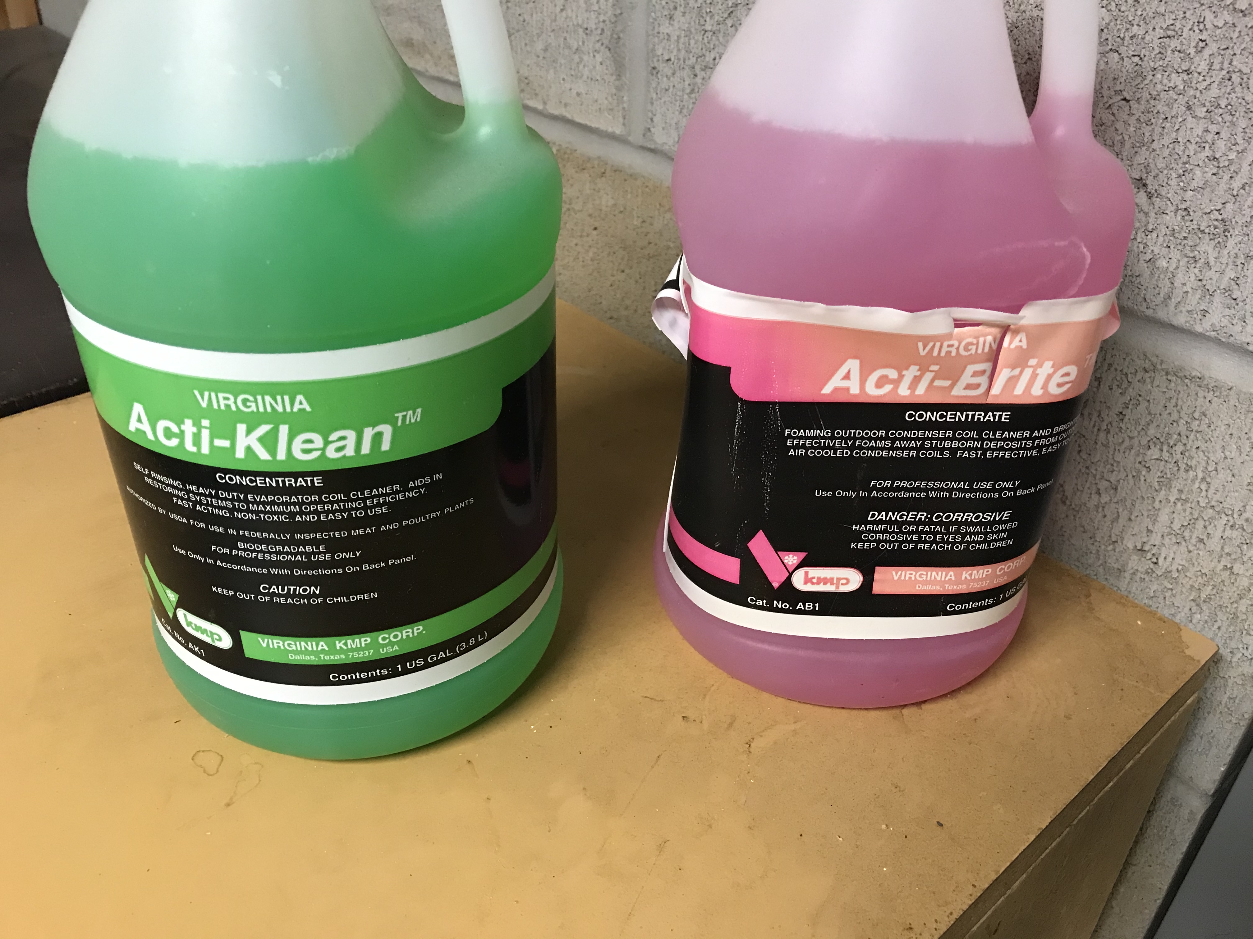

I use the coil cleaners all the time on my cars, and trucks. I can't say that I have noticed a difference in the brands either. Spray the can into the coils, wait, repeat, check the drain water to see if it is clean, and if not repeat. (Why does Ford refuse to put a cabin filter on a work truck?!! Do they think that nobody drives a pickup on a dirt road? Knock, knock, anyone home? It's a three thousand dollar repair on my truck if the condenser clogs, oh, and there is no great way to get to the coils, either. End of rant.)
