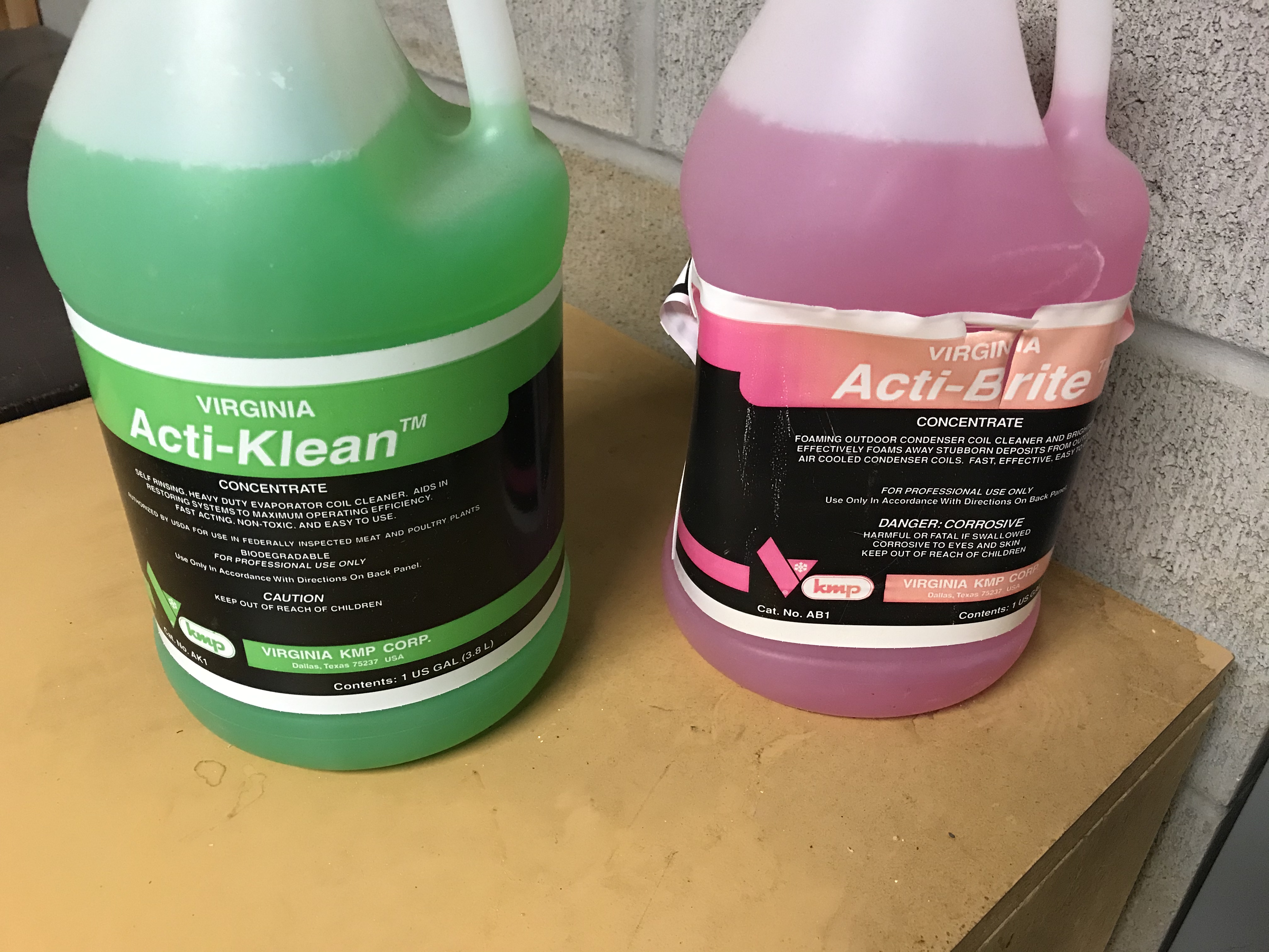

I have a nylon parts cleaner brush that I tried using at first, but it didn't accomplish anything. I went to the wire brush because that's what the HVAC guy suggested. I just dragged it along the direction of the fins and pulled out as much hair as it could, then cleaned it out and did it again. This took awhile, but I went from not being able to see through the fins, and then being able to see the coils clearly. They are dirty, and the fins are dirty, but air can flow through them now.
I tried a type of radiator cleaner stuff on my tractor that didn't seem to do anything, so I didn't try anything on my AC coils. Is there a brand that I should look for?
/ HVAC and Ionizer advice needed #13
I've just used the spray cans from Lowes, Menard's, etc... at home. It seems from year to year the brands change. I don't have a favorite.
At my job, we use some commercial grade stuff that we have to mix in pump sprayers.
I happen to be sitting next to some of it right now...
The pink one we only use on outdoor condensers and it has to get rinsed off. The green one is self-rinsing and is safe for meat and poultry plants, so we're told to use that one on the indoor units.

I think the last one's I got from Lowe's or Home Depot was in a green and yellow can. It worked really well on the greasy dust.
